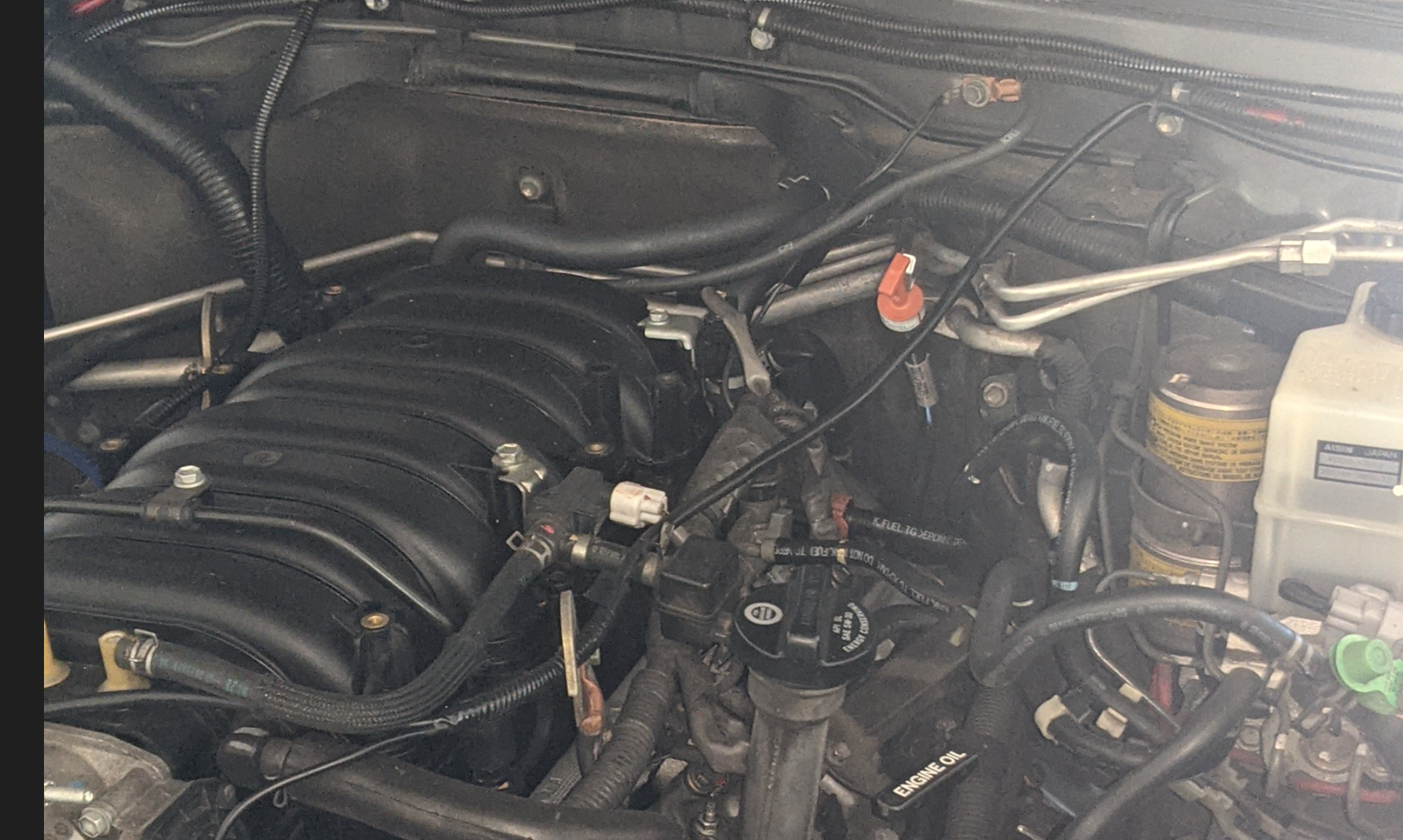

pan and guide tube from amaya I think, and dip stick from USA. Pans are the same volume.
measured volume from internal drain tube height from vvti pan compared to dip stick tube height where actual dip stick reads level in 2003 pan to get a comparable reading/ transfer mark to dip stick for a running correct temp mark.
all that to say you don't really have to measure all that stuff. Just need the pan, gasket, dip stick, and guide tube.
you'd see the 10mm short bolt mount and upper mount bolt on the guide tube when you install.
I don't know that I'd do it again but I had just installed the engine and deleted the heater tees, so I was already there, and the torque converter was only half full.
So I did.
Someone else can make a special thread if they want.
It's not that special. I had already ordered the pan and was a two month wait in late 2020 or early 2021......I think......... the years are going faster these days.
sorry those numbers are blurry
