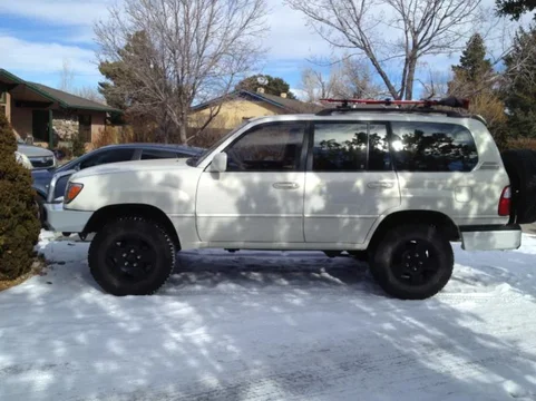

Paid through the nose to a shop to do it here locally. But the end result is awesome.
Behold:
2.5" Slee heavy lift

Looks like you're ready to go!
Behold:
I like it.
You need bigger tires.
Then you'll need an even bigger lift.
Soon after the bigger lift you'll need newer and bigger tires. :grinpimp:
