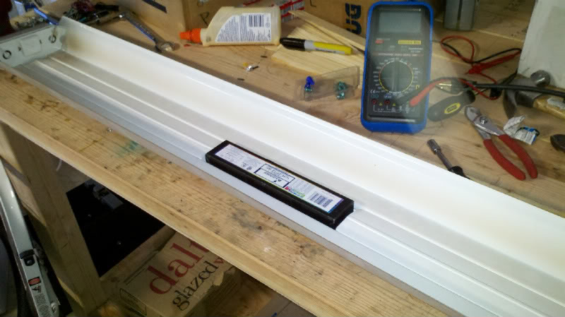

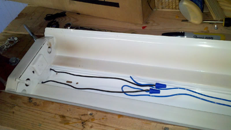

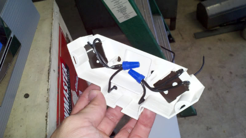

I finally got an opportunity to retrofit one of my old T12 fixtures in the shop with one of the T8 ballasts that toy4xfun sent me. Works like a champ! It wasn't as cut n' dry as I had initially expected, but it was still pretty simple and a HUGE improvement over the T12 tubes in the fixture. This fixture had both magnetic ballasts shot so even new bulbs wouldn't illuminate. Good feeling to have given new, updated life to an otherwise junked fixture. Each one I retrofit saves me $30, so it's definitely worth an hour and a half of work per fixture to do it. Here's a few pics of what I had to do on these old fixtures.
Here's an end piece. All the fixtures are like this. No replaceable "tombstones", which kind of sucks because if a contact breaks, the whole fixture is garbage.
The guts. Both end pieces have this same setup on every fixture. Some had some burn marks around them, but surprisingly the wires and plastic were still in good shape and not melted or warped at all.
After rewiring the end cap for the new ballast.
The ballast installed into the housing. I did have to drill holes to securely mount the ballast, but that was no biggy.
Far end wired to the ballast.
The ballasts were about a quarter inch too tall to fit underneath the center covers for the fixtures, so I just took some tin snips and cut the cover so there would be an opening for the ballast to protrude. There's still tons of clearance between the ballast and the tubes, so no worries there. You can see how far it protrudes here.
The cord was only about a foot long, so I pulled the 4' cord off the fixture that was unserviceable and installed it into this one. Here's the cord end repaired and wired up to the ballast.
The fixture reassembled with the new ballast and modified center cap (now caps).
It works! The lights snapped right on with zero flickering and seem to put out much more (and better since I'm using a higher color temperature) light than the old T12 tubes that were being used. Side by side with a fixture running two good T12s, I'll take the T8 retrofitted fixture any day.
