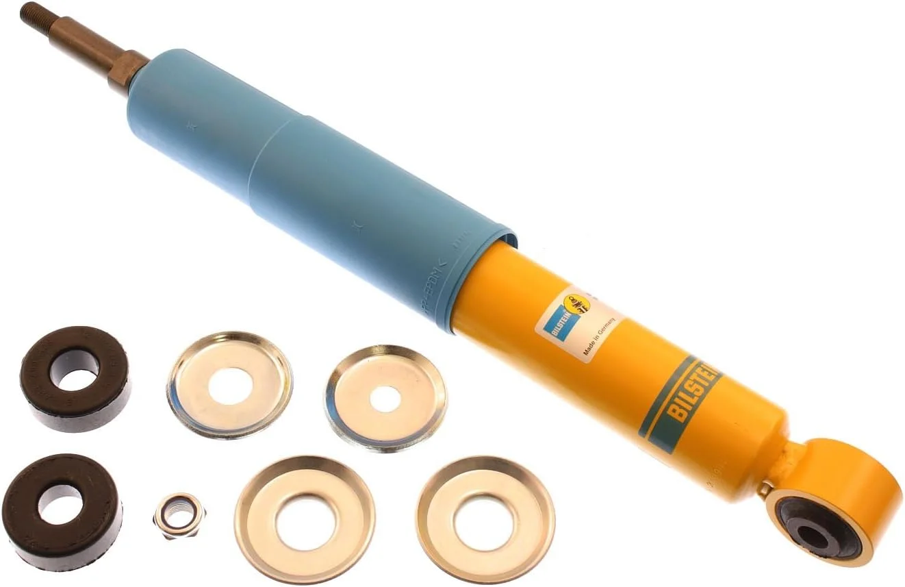

After giving it some thought, my question is: can you order just the Bilstein shock bushing washers for all corners? Does anyone know the measurements or part numbers for just the washers? I’m aware there are two styles of cupped washers for each corner, and one has a nipple that fits the top shock mount.

I just wish there was a way to measure the washer and I'll get it somehow. It’s strange that almost all aftermarket shocks include the hardware, but the washers themselves are nowhere to be found. Last resort is to just get it from impex, ayama or partouq

From top to bottom mine have: nut - washer - rubber bushing - upper shock mounting point - cupped washer - rubber bushing - cupped washer - shock body

Just in case anyone still wondering about the washers. I was intrigue that the washers are provided by any aftermarket shocks but it cost $10-$15 per washers from Toyota, each corner requires 3 to 4 washers depending on who to talk to.
I managed to order the washers-and-bushing kit only from BilsteinUSA
The hardware kit is B4-KT1-Z098A00 and B4-KT1-Z099A00
each corner cost $10 .. I think this is the perfect pair if you order OEM toyota shocks
Looks risky to me. Those washers don't look anything like the Toyota washers. You can get the Toyota washers for about $40 plus shipping from Japan, no sales tax, probably about the same price, and certain to work perfectly with the Toyota shocks. The Toyota shocks come with the bushings.
