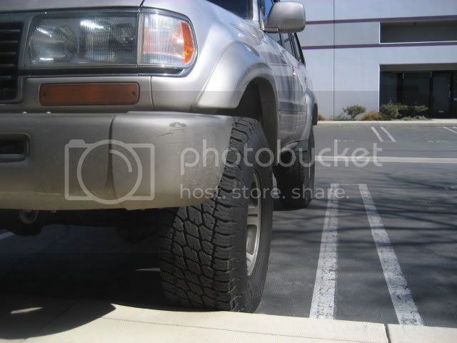

My truck pulls to the left when I drive on pavement.
I've taken it to an alignment shop who said they couldn't fix the pull but adjusted some other things into spec.
Just LOOKING at my truck, I could tell the front axle seems shifted to the left, with the rear axle shifted towards the right. Each axle is shifted about an inch away from center.
I can't see how the lift alone would cause this, and nothing looks bent or out of place looking at the suspension.
Whats the fix for this?
If you installed a lift w/out adjustable panhard bars then your diiffs are out of place. Either get adjustables or extended panhards for the application of lift you got.
Uhh-Cody-Look under your truck. See those diagonal bars that run from the frame to the axle? Those are the pan hard rods. As you lift the truck, they become effectively too short. They pull the axle to one side or another. It's totally normal. You can either forget about it, or get the pan hard rod adjusters from Christo Slee at Slee Offroad.
They should NOT make your truck pull one way or the other. Only toe-in can be adjusted, so don't look for an alignment to fix your problem. A slight pull right down the camber of the road is also totally normal. If it's more than just a hint of a problem then something IS wrong. Best case scenerio - a bit of tire pull. Worst case, a bent axle. Try swapping tires side to side and see what happens.
Well the axles are definately each pulled to opposite sides. Its not a crown of the road thing...flat parking lots, opposite crowns, etc...I pull to the left as if slowly changing lanes.
I would imagine having the axles centers 2" away from eachother would cause the truck to pull.....especially since the pull goes toward the way the axles are shifted...I'll look into the adjustable panhards...
I went browsing around other there and I see now how lifting the suspension would shift the axle that way. I guess I had to just look at it all to understand what kept the axle from shifting side to side...now to search for a pair of adjustable panhards...thanks!
