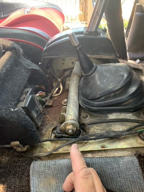

Ok, so, I’ve been working on my junk for a couple of months now to get it ready for my grandson to do the Rubicon in a month. My current issue is when I adjust the slotted bar connecting the shifter to the trans, either I can put it In Park and cant shift it in low, or, I can shift to low but not park. Any ideas?

I discovered the problem. I tightened the nut to 15 lbs and issue solved. Thanks for your input.
