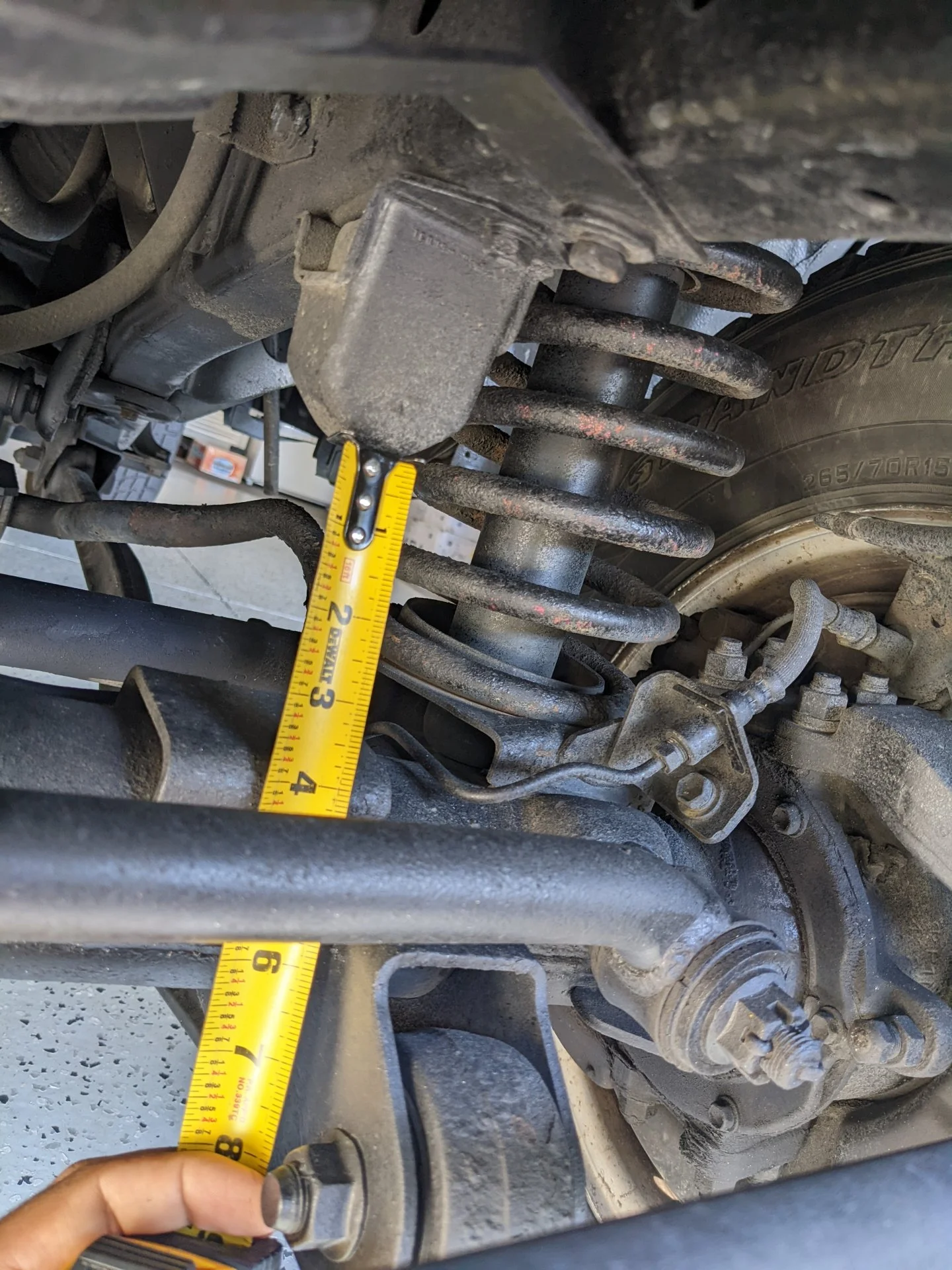

1. I do not know if this truck is lifted or not, no special markings that I can see on suspension components, and yet, the truck appears to sit a bit tall for a stocker IMO. I went and measured the distance between the top of the front axle housing and the bump stop above it, I have exactly 4". Do you think this is stock for the vehicle??

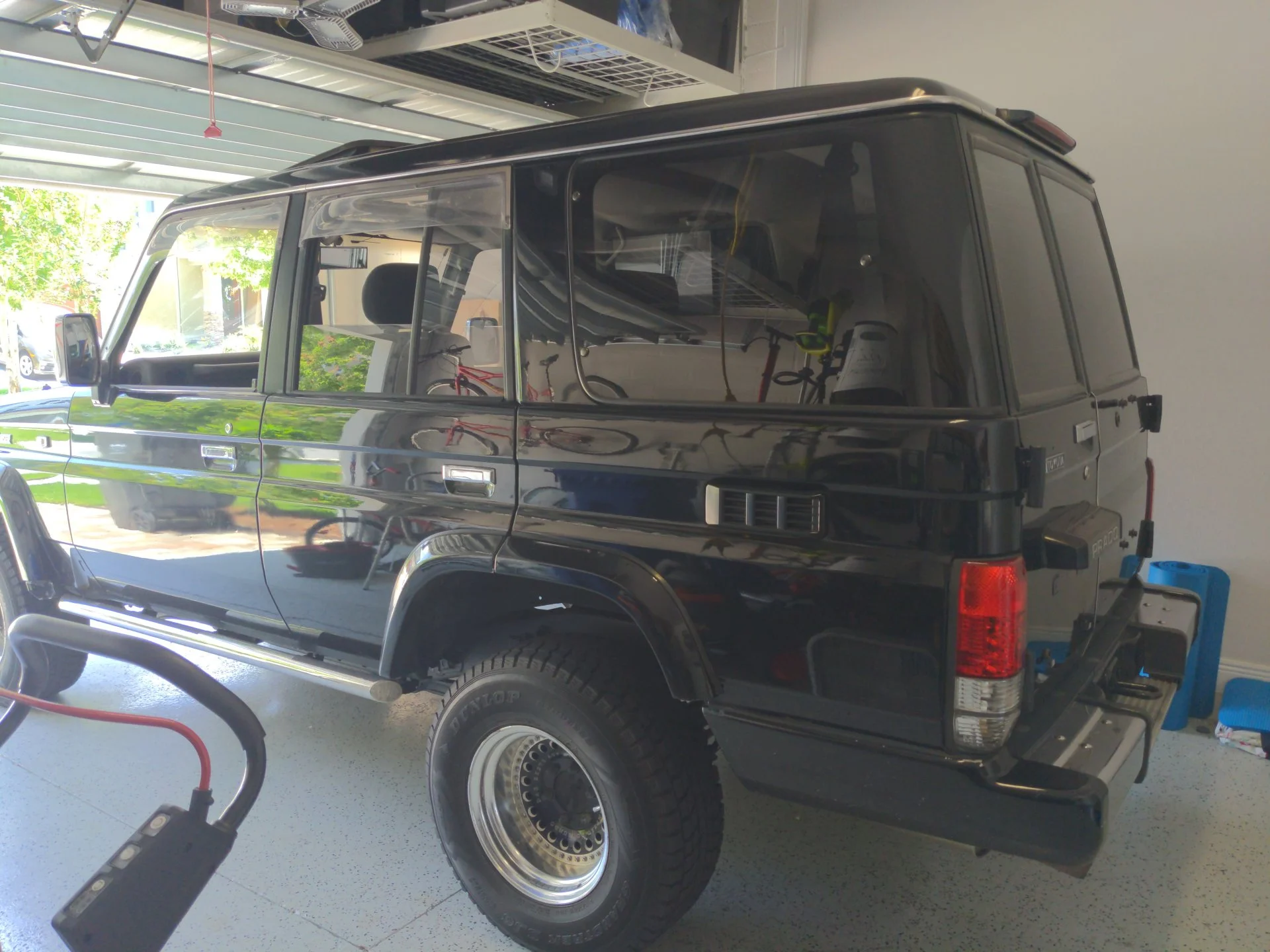

Looks great! Judging by the stance in the photos and the distance from bump stop to axle I'd say you have about a 2-2.5" lift. There's a thread here in the 70-series forum all about 3" dump pipes for the 1KZ, a quick search should bring it up. Congratulations on your new rig!
Thank you @AirheadNut, I too feel like the vehicle might be lifted already. I will try to scrape off some of that japanese undercoating and see if I can find any identification markings on the shocks.
Does a 4" gap between the front axle housing and the bump stop a sure sign of a lift install? Does anybody have a measurement of a lifted or stock gap to share?

I have 30mm spacers on stock springs on mine and the gap certainly isn't 4", probably closer to 3". I'll have to dig out a tape measure to make sure.

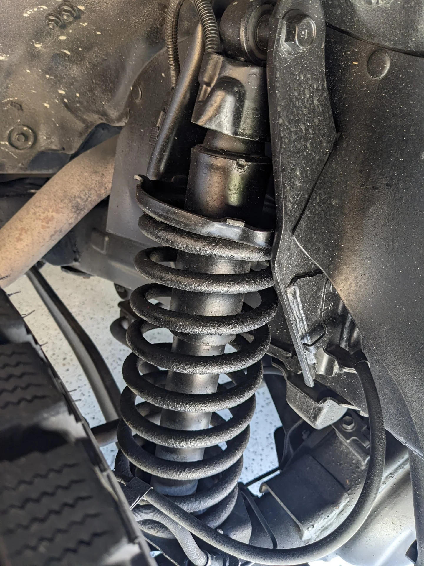

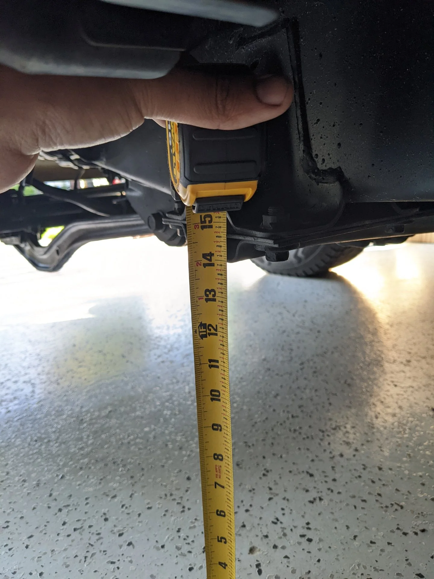

Here are some additional photos of the measurements. Any observations are very welcomed!
