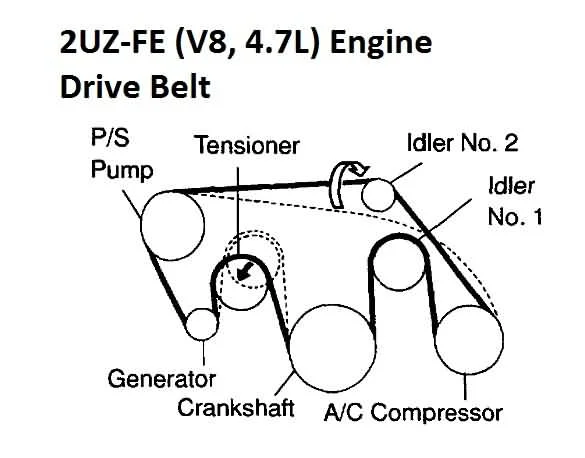

Ok cool and just to make sure wanted to establish this diagram
