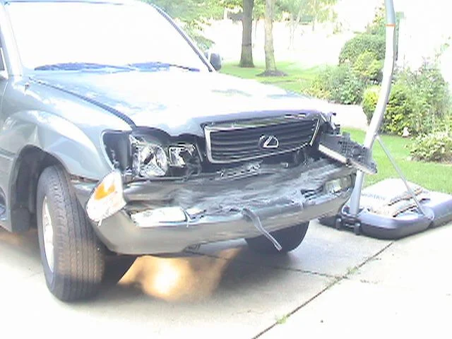

hello glad your ok; my crash was in the rain and on a steep curve. a bmw came into my lane and I slammed on the brakes not to hit him and then by back end came around the spun into gaurd rail.honestly i think the new VSC and traction controls they have on the new ones help. I have a 06 now.
