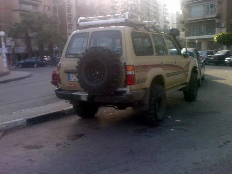

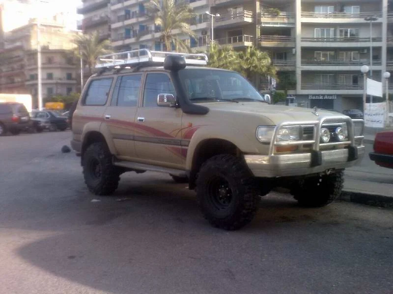

u have a choice of two different tops, it's not a kit per say, but u buy the different parts separately, mine has the closed top (opening on rear see pic), while the one Ferg got had the old school open style one, here's a picture of the parts installed, also it's not water proof out of the box, nothing a little silicone can't solve.
