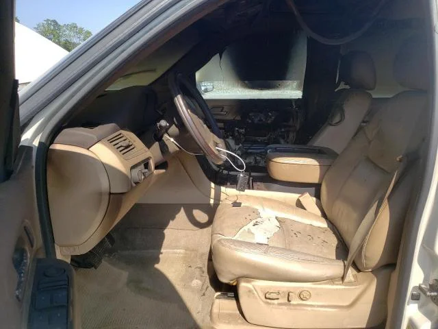

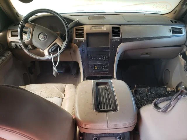

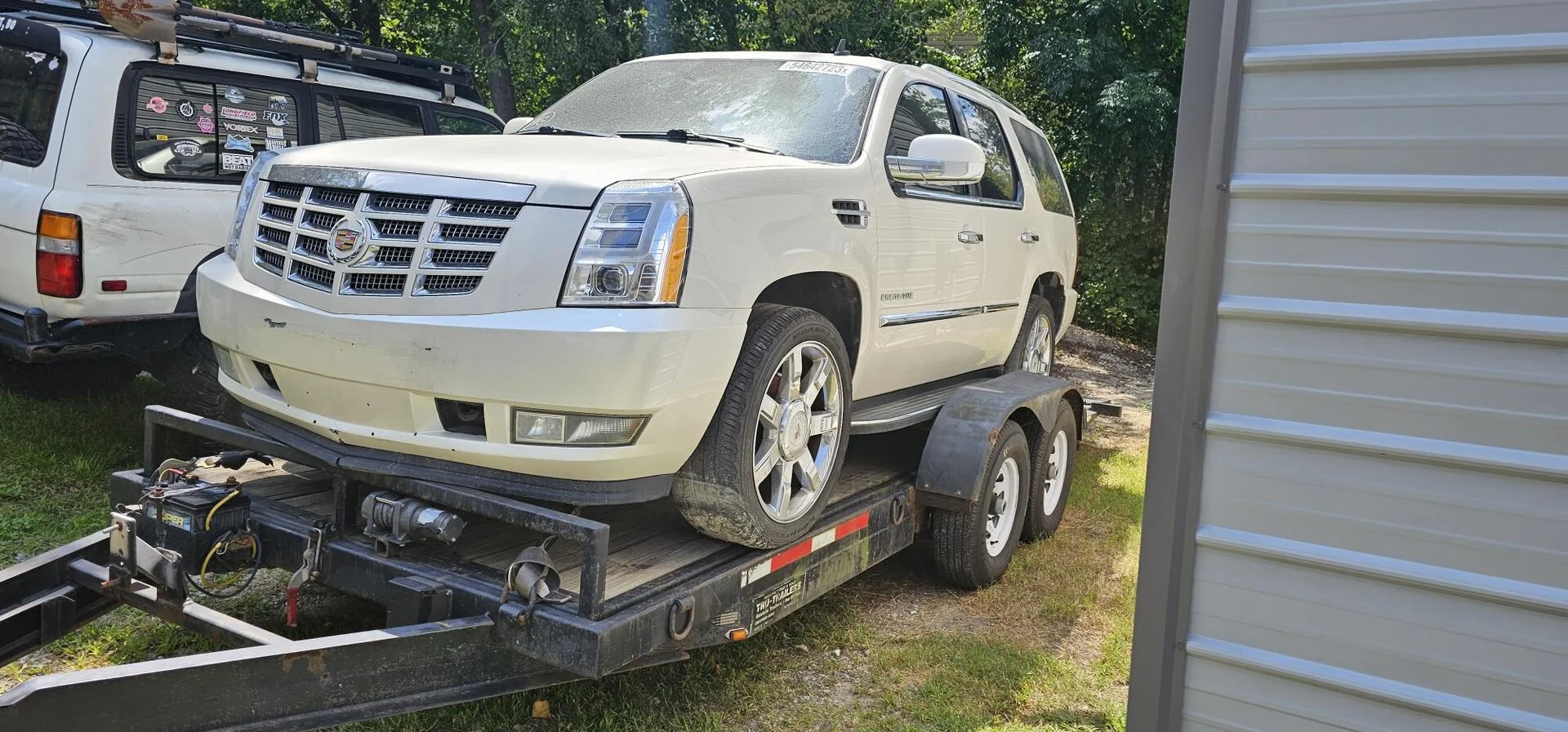

#justgmthingssome int pics. someone have the seat warmer on too long?
well pulled the internal circuit breakers to the pass seat and power windows. pulled the acc. lighting, mirror and such and sunroof fuses. hooked up a battery and she started right up. so far so good. only ran for about 15 seconds shut it off and checked the battery to make sure it wasn't getting hot from some sort of short. next time i will see if i can put it in gear.

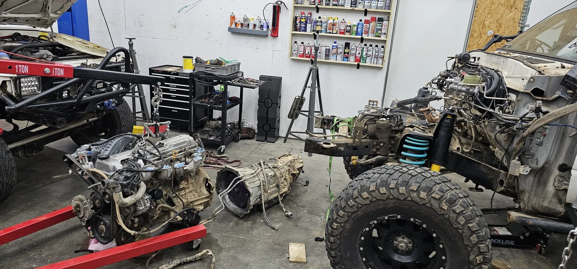

Nice combo on the cam/springs/ trunion upgrade.needed something other then factory springs to go with the CAM and trunion upgrade. it should be real close to about 500 ft lb. at the crank but, that will prob be in the 4k range.
the old A442F has a 1st gear ratio 2.950:1
the 6l80 has a ratio of 4.027 so that should bump my low range crawl ration from a 35.8 to about 48.9 and double my HP.
on the other end, overdrive on the A442F is 0.765:1
where the 6L80-E 0.67 so hoping to get a little better SPM
