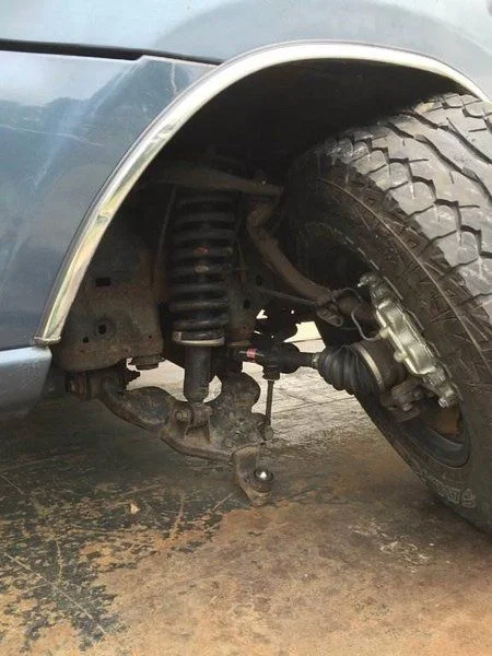

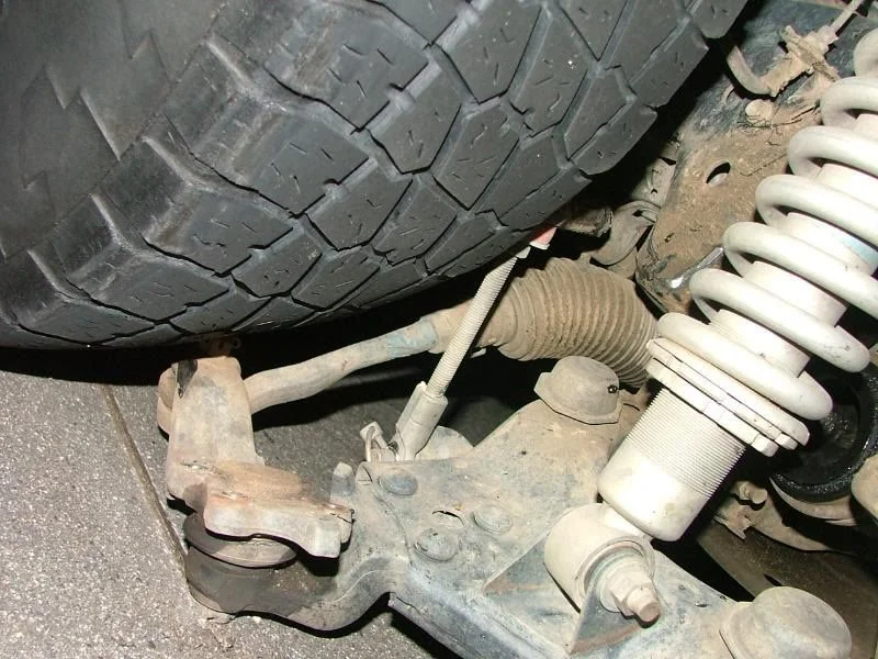

1st gen Sequoia (00-07) was graced with Toyota’s worst knuckle + lower ball joint design ever produced. Identical to 1st gen Tacos, 1st gen Tundras, and 3rd gen 4runners. The LBJs are ticking time bombs that rarely give indication of impending doom...the LBJ design also has 5 potential failure points.
Also, the front wheel bearing design is fubar. The bearings are sealed and can’t be serviced, so the options for fixing play are to 1) pull knuckle off, cut bearing out, press newbearing in, or 2) replace knuckle.
We bitch and moan about the 100’s torsion bar IFS, but it’s superior to Toyota’s other alternative at the time...

The LBJ was defo a concern but I wouldn't say they go out all of a sudden. People just don't check for play. I have a 99 tacoma and 97 landcruiser prado, both have original LBJ and are over 250k miles with no play. Both trucks are on original bearings as well. I actually think bearing wise it's superior to the 100, as it doesn't require the maintenance the 100 requires. I've owned my prado for 20+ years, and the tacoma 10+.
