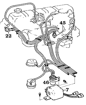

    No advance or retard port on the back of the carb??? I think it is a 75' CA. model carb.

    Must have relied on the mechanical advance only? The only ported vacuum on a pre '75 carb I've seen was on a '74 that came off an FJ55. It is on my truck as we, ummm.....type;)

    That is a typical F motor Vacume RETARD carb. The "emissions computer" tells the VSV (which gets constant vacume from the manifold) when to retard the dizzy. It is a fairly dumb design but that Carb has no Ported Vacume.

    An F carb with center stud for the 2F aircleaner?????????? That is not an F carb:rolleyes:
    Ed
    Moto, what is the date stamp on the carb above the sight glass?

    Good point on the air cleaner stud... So i guess it would be a 75-early 76, 2F Vac Retard Carb.

    According to spectors website, it is a 1975 2F carb. I will get the date off it also. So I guess I can't use this carb on a de-smogged setup?

    If there is no way to advance the timing its not useable, right?

    Not without the VSV parts for timing

    Or swap the base with a carb that has advance port.
    Or have Jim or Mark drill your base.

    can i drill a hole in the base to fix this.

    Remove the base and send it to Mark www.marksoffroad.net to be fitted with a port.

    I have a good base off another stock carb that has been sitting around. I wonder if they are compatable?:hmm:
