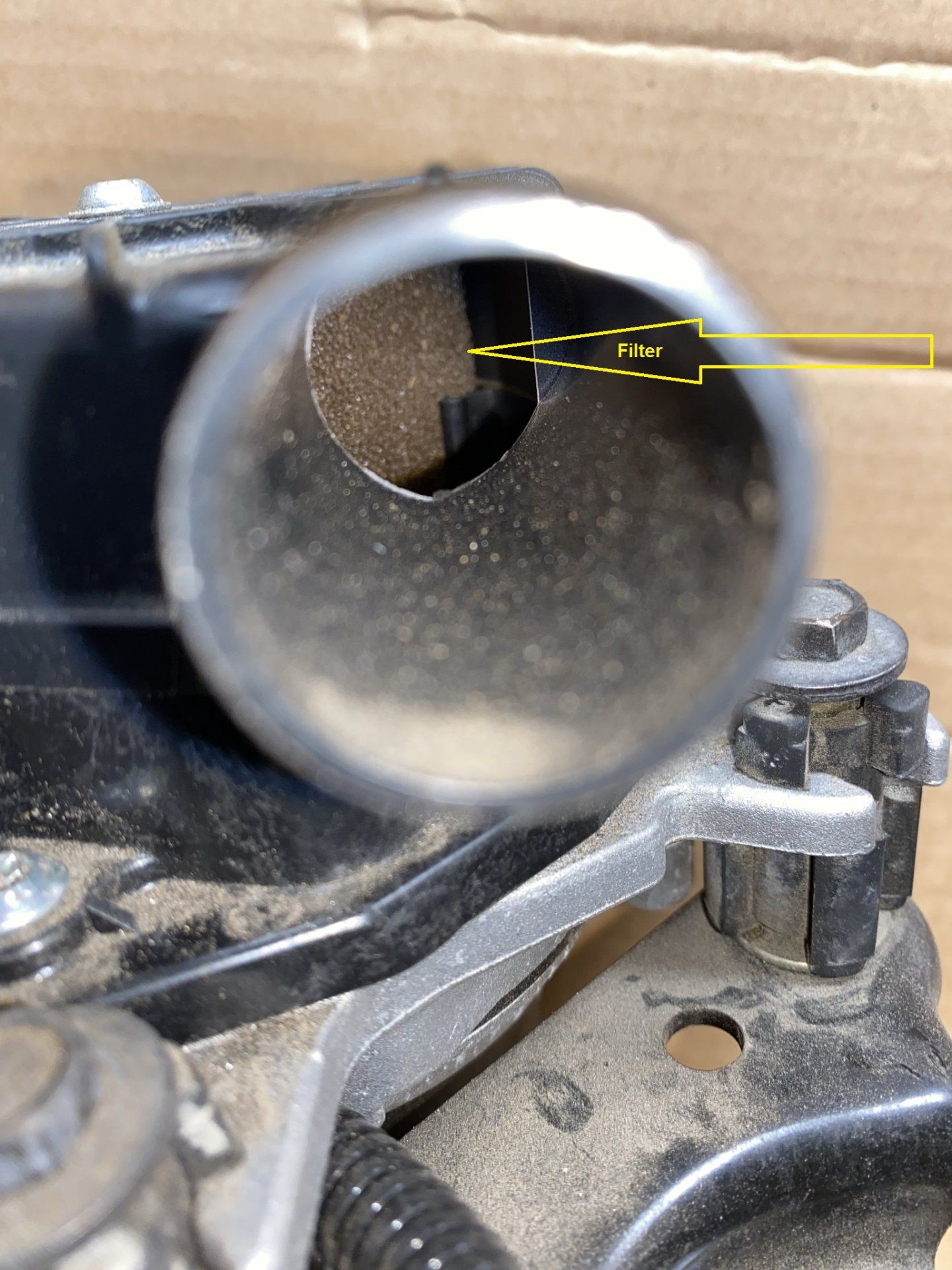

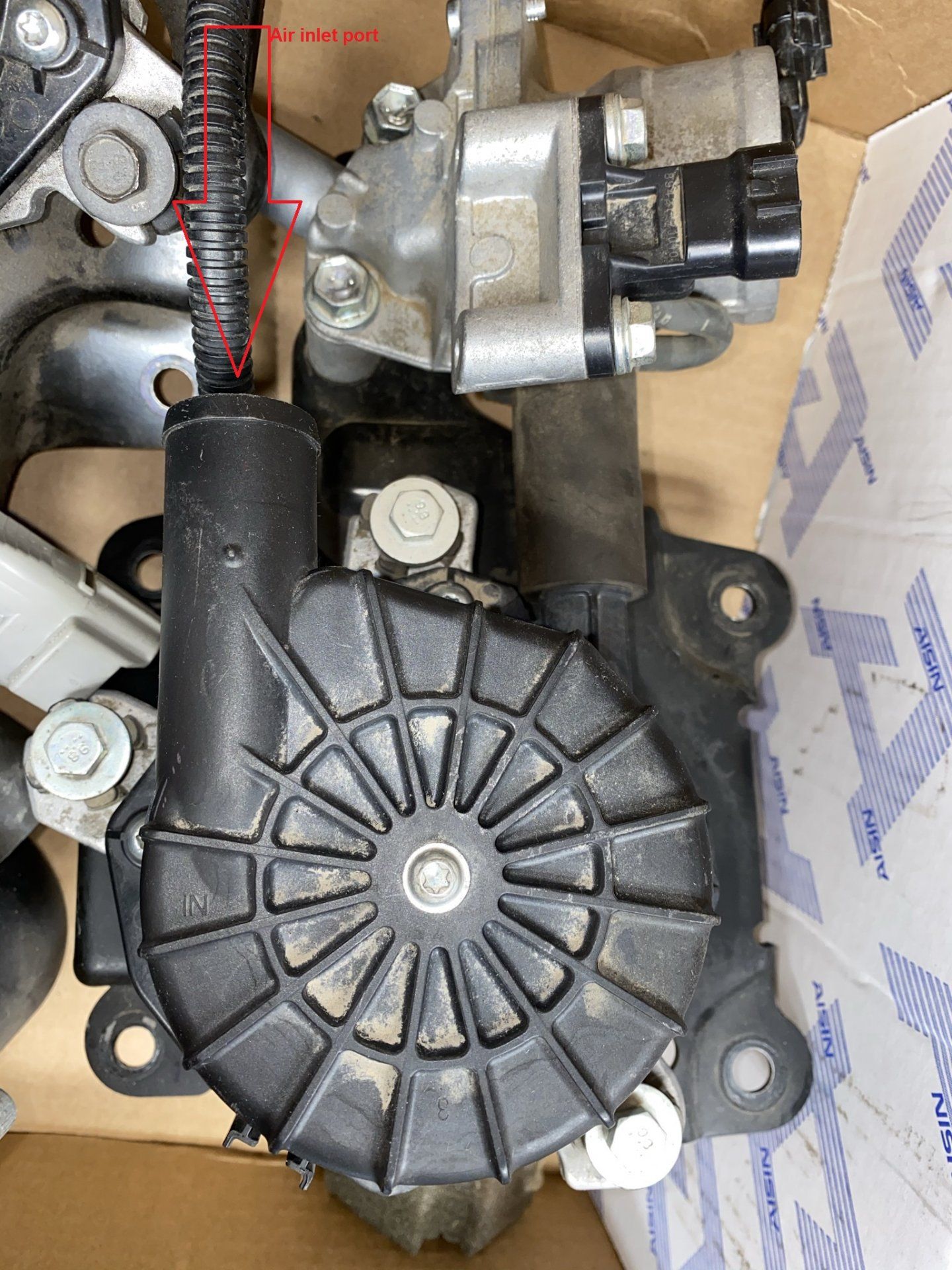

I am super interested in condition of air filter within the A.I pump?
Please, anyone removing intake manifold. Please please take a picture inside the 1" Air Inlet Port on A.I. pump, of the Filter and post here?. THX!
