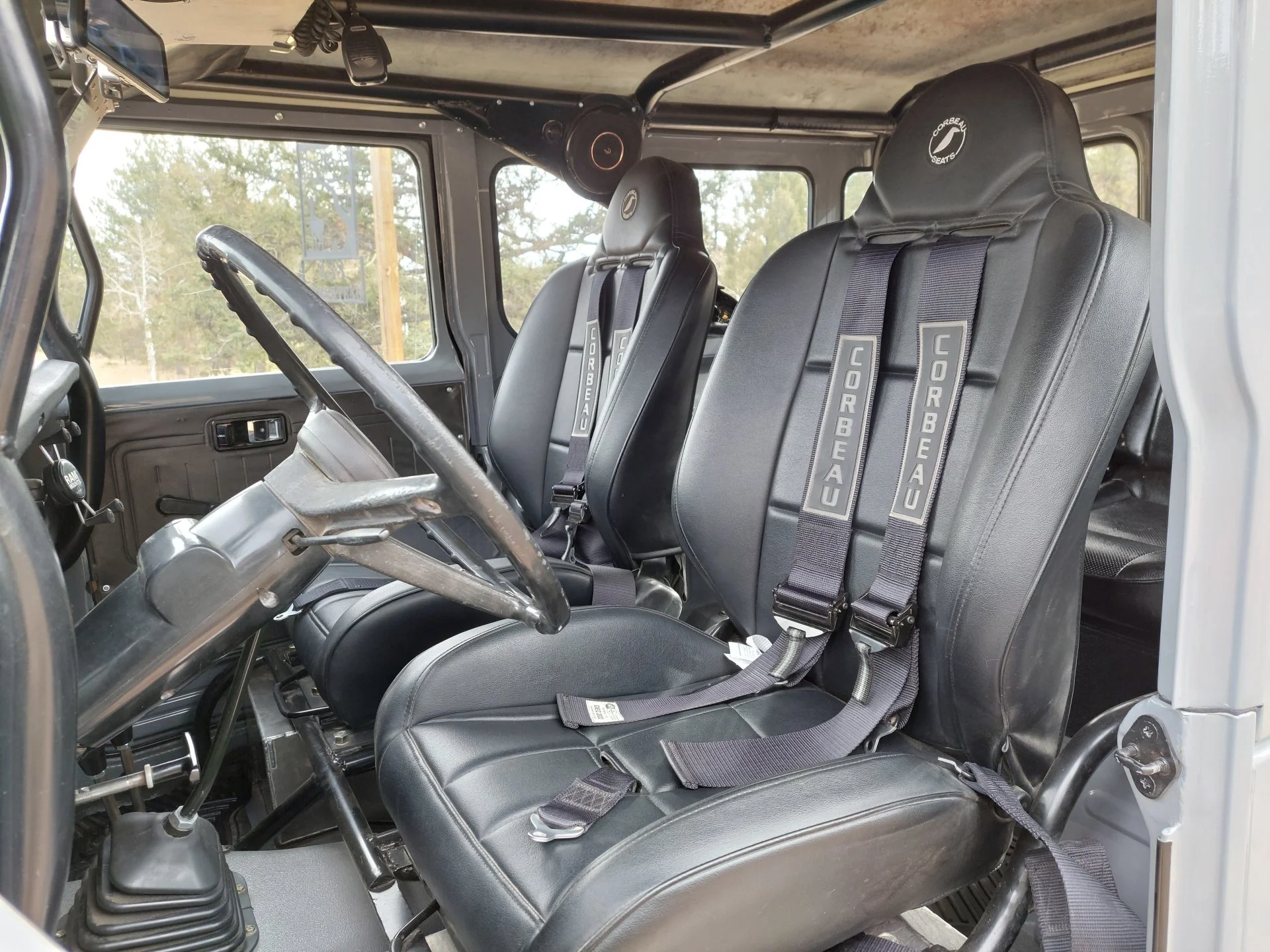

Corbeau and Procar both have some nice seats.
Corbeau Baja RS seats.
A little to race car for me, i think its between the CCOT ones and the procars
You should look and see what Corbeau has, they have a bunch of more OEM looking options. I run those in my wheeler, as they are a lot better at keeping me from sliding around.
those look great, hows is the back height? I'm 5'10" are they comfortable seats?
Very comfortable for driving around town. I don’t do any hard core 4 wheeling. I’m 6’3” and got them for more legroom and adjustability. Everyone who has sat in them like their look and feel.

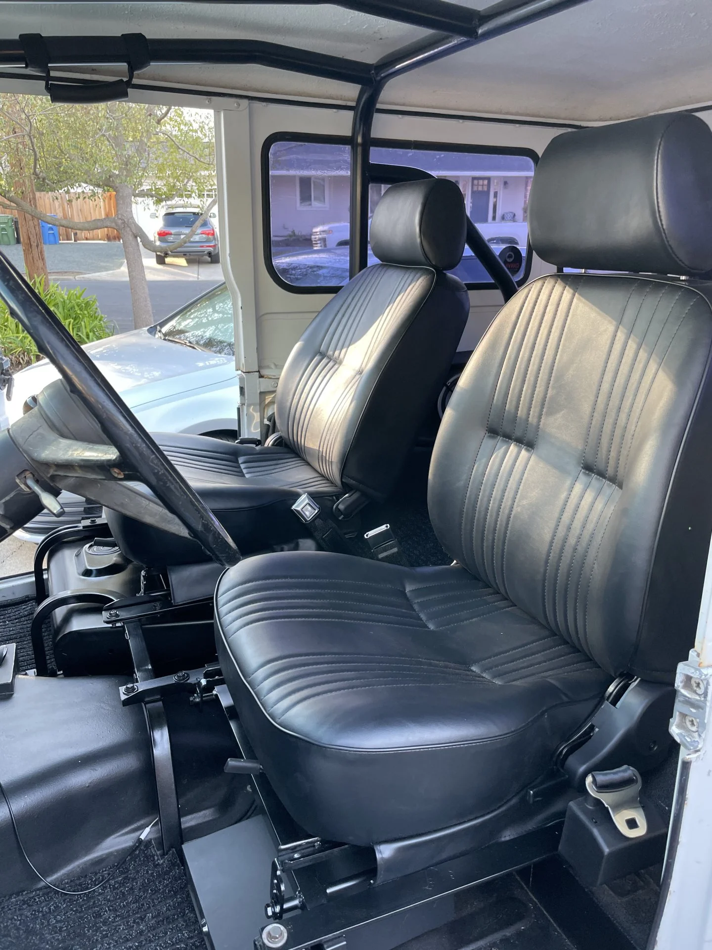

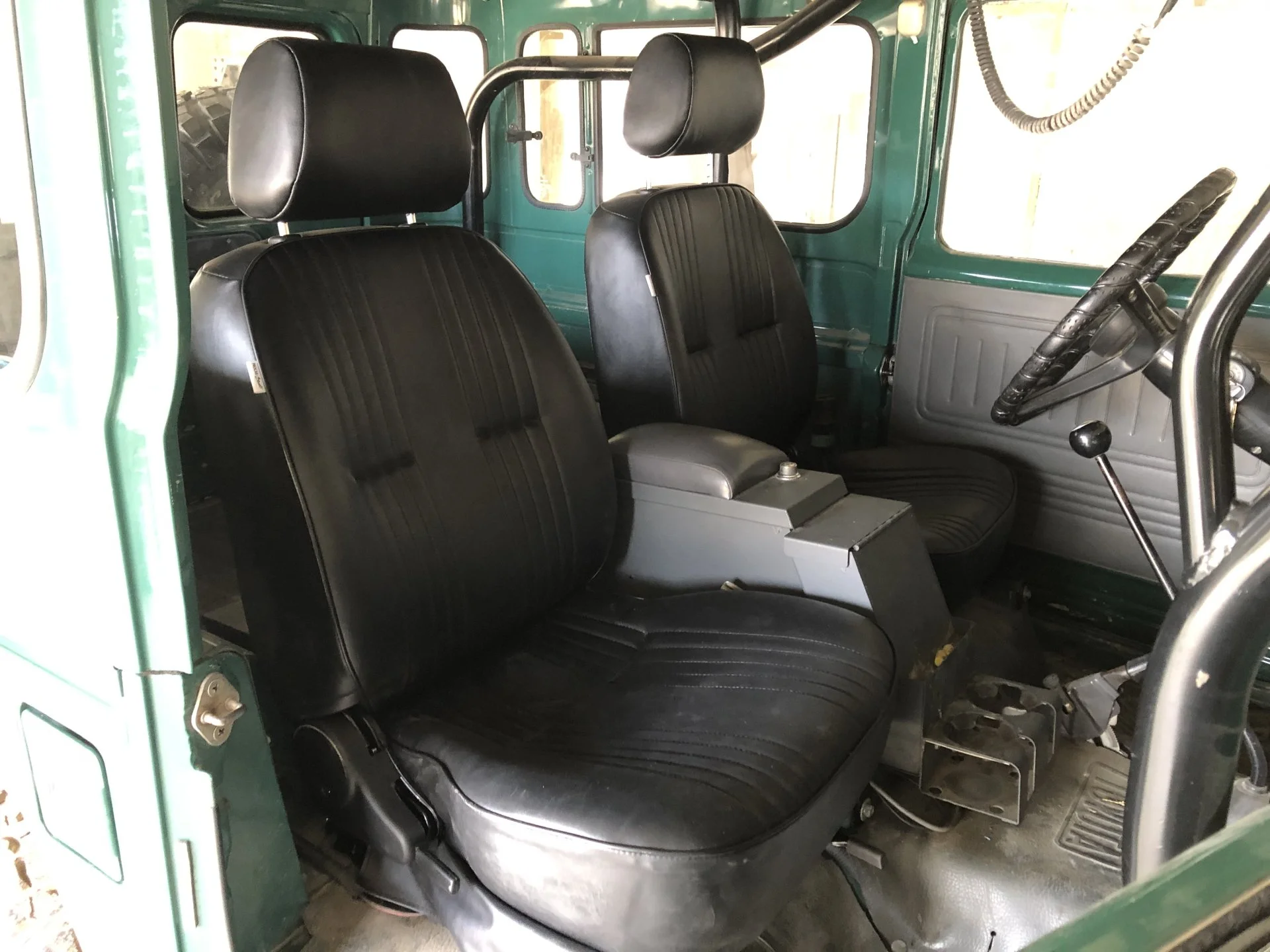

The 1/79+ are different seat and mounting system. On the 73-78 the passenger seat is actually higher because of the fuel tank under it. 1/79+ while level all the way across the seat can't be lowered as it just all the floor. Have to consider thickness of the seat cushion. Steering wheel diameter is the same 9/72+. So unless your changing steering column or steering wheel have take that into consideration. Already dealing with the steering wheel being off center of the seat. I personally don't want seat that are too tall. The FJ40 hard top offers great vision out the back. Prefer not to have a seat blocking it.

Is the replacement tub modeled after the 79+? I know some with the E-78 move to a fuel cell under the back floor which opens up all kinds of options for aftermarket seating. 79+ the fuel tanks is under the tub and the floor is right under the seats. That limits options of seat placement. Original seats are just off the floor as far as height without major modifications only option on height is up. OEM seats bottom cushion is not that thick. Nice thick cushy seats puts legs closer to the steering wheel. Thread title is 79-84 seats. Some of the pictures posted are earlier with different options of mounting.
