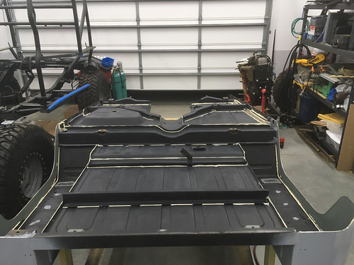

Auto body seam sealer on all the joints! The more expensive brands usually maintain their elasticity longer then the cheaper ones. Some also smooth and/or self level.

Spoke to my body shop guy and suggested they seal all joints under the body and as per your image. The body shop technician suggested that is not the correct method and this is his reasoning.
He suggested that the body panels need to breadth and these slots should not be entirely sealed with these rubberised sealers. If this was the case then why did the manufacturer not seal them? He has suggested, galvanising the entire frame, primer and then a coating of Raptor style liner spray.
I am now confused and do not know which is the correct version. I live in the UK and the under body will be exposed to the wet weather and salts due to winter.
I would love to hear from you and why it is preferable to seal all the joints the way you have done. Thanks

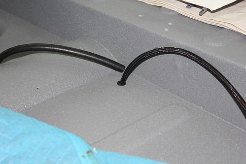

I opted to apply a color matched raptor liner (bed liner product) to the interior floors.
Welcome to the world of auto body. Everyone does it ‘their’ way and their way is right and others are wrong!
I would not recommend sealing the floor stamping areas where they is a gap below the body rib. For the others I chose the seal. I’d rather seal out rain and mud, etc. vs allowing any condensation to ‘breathe’ as your body guy says. I mean, is he going to tape off those seams so when they paint the paint doesn’t seal that panel to panel area to let it breathe?

Thanks for the input. Please correct me if I am wrong, the objective should be to seal all gaps in the body where there is no route to the internal body to allow water ingress and to seal all other areas. I suppose, what I am thinking is, imagine if there was a channel below the body and we seal the gaps under the body, if somehow water or moisture penetrates from within the cabin through the floor and into the channel under the body then the channel will start rotting as the water won't find a way to escape. I apologies in advance if I am repeating what you have already said.
Also can I please request if you could email me a good copy of your under-body seams that you have filled prior to the application of the liner or the paint. Would like to see where you have applied your seal. The image you posted on this forum isn't clear when I try to zoom in. I will DM you my email address. Many thanks
Replied to your email but wanted to address the point above.
You should be sealing the seam in both places - interior/exterior top and underside to prevent what you are describing. When you have your tub media blasted, you will clearly see the factory seam sealer still in the top panel seams. I used a razor blade to scrap all (or as much as I could) factory sealer out before applying new sealer.
I did the same thing @ S4Cruiser did on the interior and also three coats of rubberized undercoat to the bottom. Brushed it on to really force the material into the seams to seal them. On the interior I used the 3M seam sealer; 3M 08307 Self-Leveling Seam Sealer for the horizontal surfaces and 3M 08308 Heavy-Bodied Seam Sealer for any vertical surfaces to prevent sag or running of the sealer.
