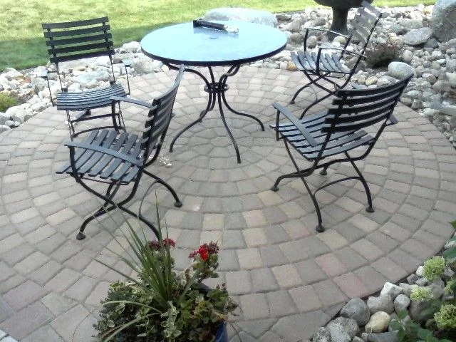

Cool, I'm interested to know what yiu go with and how it works out. I finished my projects yesterday - had enough brick leftover from the patio to do the front walk also. I probably won't bother to seal it this fall - has some efflorescence and such, which I think ought to be done by spring. Pictures aren't great, but here's what it looks like.
Looks great.
I still get efflowhatever from my bricks on the front of the house in the spring. About 4 years old now. Only the red bricks, but every house in the neighborhood with red brick seems to chalk up a little in the spring. I never noticed it with the pavers though.
Looks like it slopes away from the house well. See a lot of people make them perfectly level and they sink/settle and all the water runs to the foundation. Nice work. :)
Looks great.
Thanks - yea, it's got good slope. The only issue at this point is in the lower-left corner of the first pic. The pavers adjacent to the ones on top of the retaining wall blocks compacted to just lower then the pavers on top of the wall. So I'm getting a small puddle there. Don't think it's a big deal, but I'll keep an eye on it.
The other thing on these pavers is they have alot of whitish scratch/scuff marks on em - from the tumbling process I assume. I'm hoping that's going to weather off to the color of the brick.
I think it will. Mother Nature evens a lot out over time.
The beauty of pavers vs. poured concrete: You can always take out the offenders and re-do them, with only some time wasted. :)
