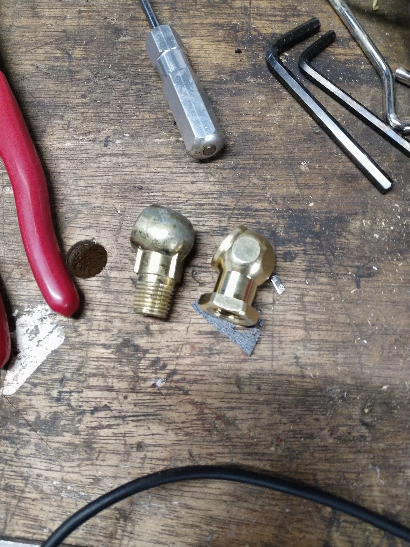

Here's one I made :)
With the valve closed, left gauge reads tire pressure and right gauge reads source pressure
Open it up and they equalize
And the larger screw on chuck is easier on the fingertips than the dually extensions on my old setup :cool:

I have most of it figured out, but how do you connect the ViAir hose to the valve ? I found the tank adapter that will go from 1/4NPT to the Schrader male. The adapter I can't find is the Schrader coupler
Thanks again ! what you did is exactly the idea I had on my head.
Head over to HF and pickup this 5 piece inflator kit
Inflator Kit 5 Pc
The thumb screw adapter on the rop right is 1/4NPT and threaded for a standard Schrader
