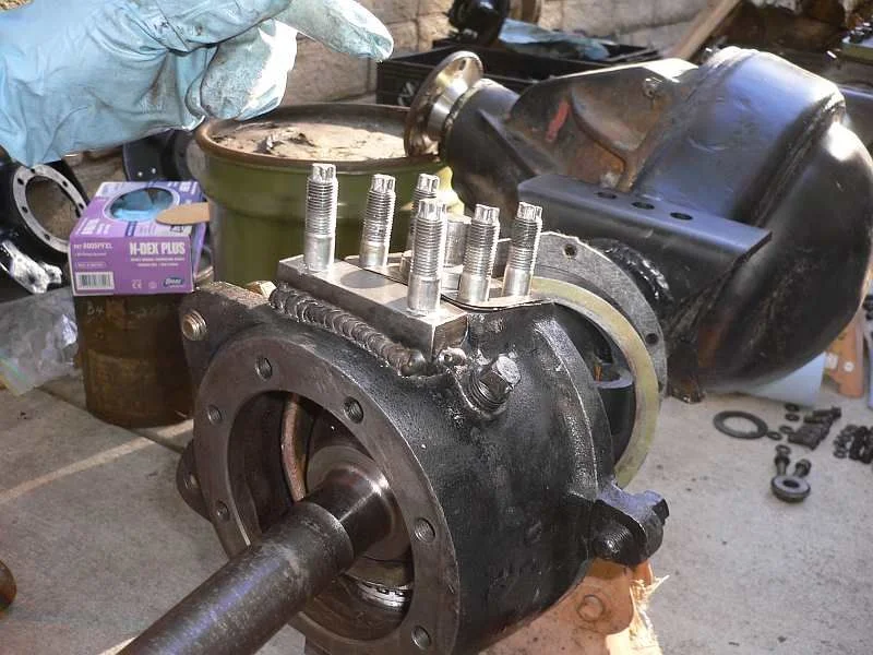

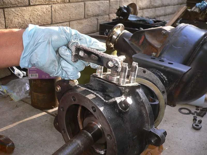

First pic:What's Randy so happy about? Maybe it's that he can now go backwards, while going forward! (Notice knuckle orientation). Front of axle is to Randy's left side. Or was it the other way around? I don't even know at this point!
Second pic: Weld looks good.
Third Pic: Ummm
Fourth Pic: DOH! Better here than on the trail, eh? btw, I saw those 6 shooters on clearance at TG: Trail-Gear High Steer Crossover Steering

Who welded those on? Probably need to crank that welder up to get a good weld to that cast knuckle, or pre heat the cast before welding.
BTW I fixed your link, I wouldn't buy parts from Frailgear. That company sucks a fat one IMO.

Its a long story but they did some questestionable stuff to some other mfgs. You can do a search and read some more on Marlin Crawler or maybe Pirate but this is another topic.
So who welded that knuckle?
