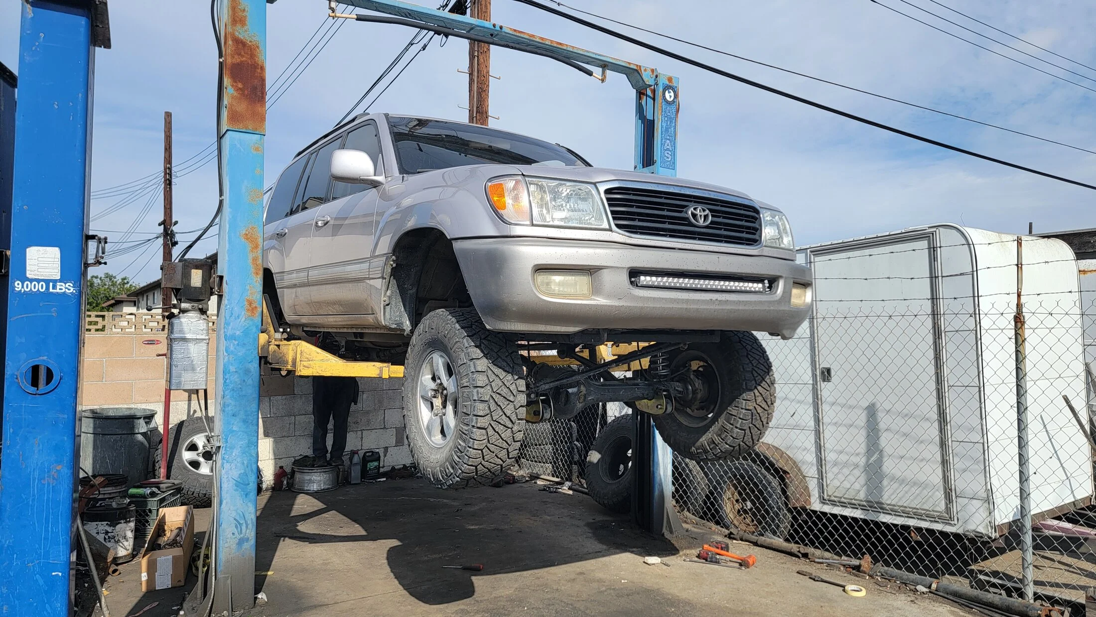

It's finally that time and the build has begun. Front got cut out so no turning back. Lol

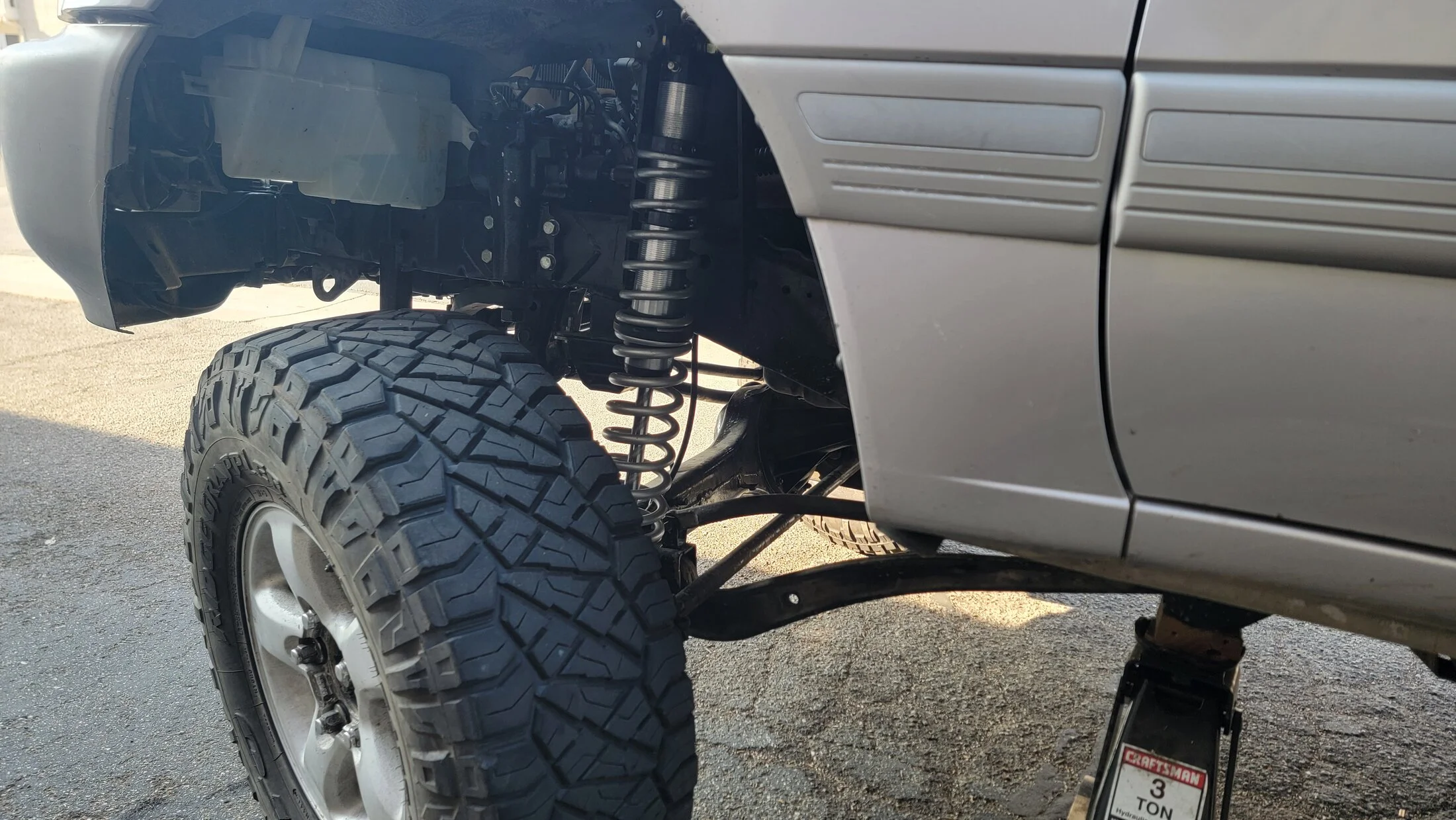

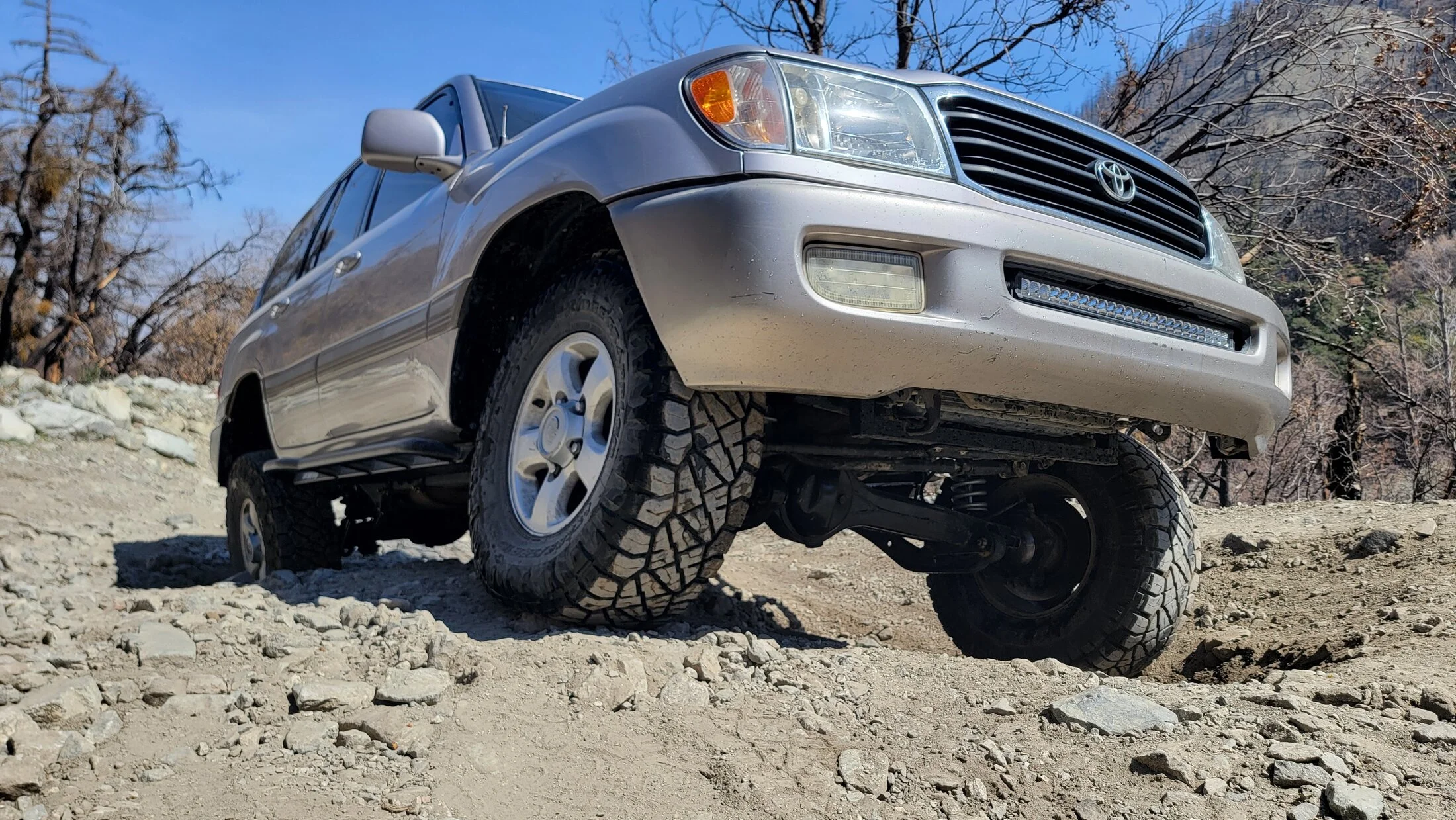

It's been a while since I came on to here. The SAS has been finished. It took quite a while to finish because I had my Gladiator and Power Wagon that I was using for going out and wasn't too motivated on pushing this project through. Basically I used whatever 80 series parts that I could use and customed everything else that could not be. Front Radflo coilovers with rear Iron Man springs with OME BP51 shocks. Anyone else finish their SAS?
How many inches of lift did you end up with and what size tire are you running?
The height after the swap is about 3.5" higher than a stock 100 series in the front. I have the coilovers set at about 2" of up travel and 10" of down travel. I didn't want to lift it up too much but after going off-road a couple times, I need about another inch of up travel so I will adjust it when I get the chance. The rear is up about 4" over stock using Iron Man springs for an 80 series and BP51 OME shocks. The tires are 285-75/16 or 32.8".
