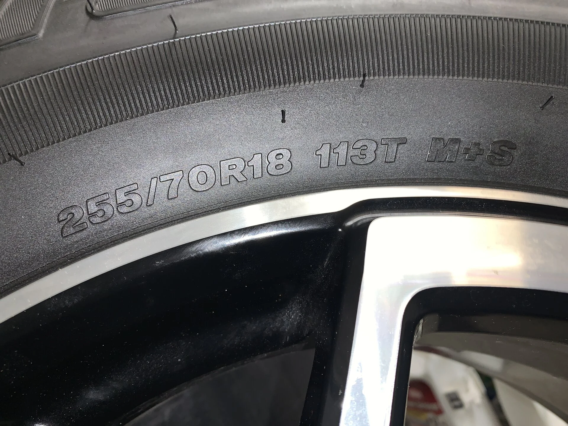

255/70R18 113T M+S

I think it’s the 113 load, that’s below the stock load (which is 114?<edit - stock load is 112 on a p rated 285/50r20 for my LX>). So at no pressure could these P tires meet the needs of the door label. Corporate will indeed avid this situation.

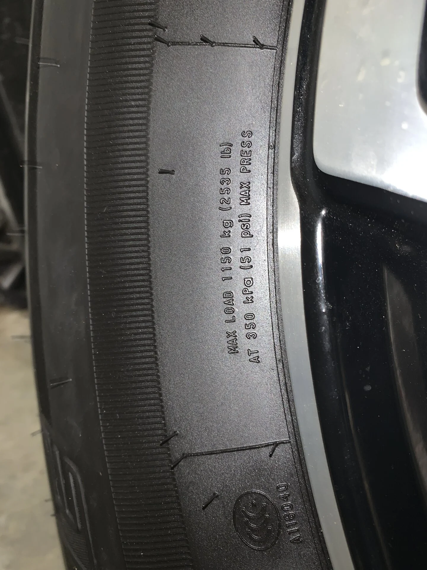

If its 51 MAX PSI its an XL, and something here is amiss.

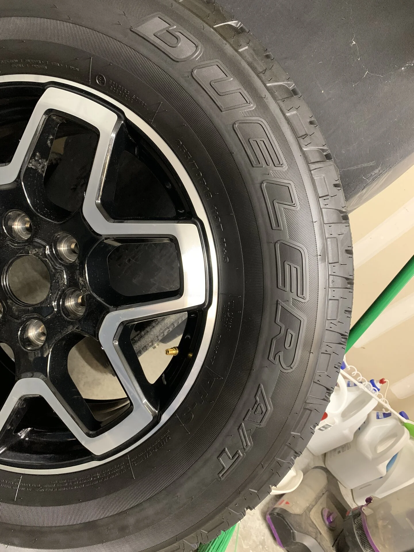

That specific tire (make, model, size) is an OEM tire for a few trims of Jeep Wranglers and Gladiators. It's a very old tread pattern, similar to Dueler ATs from 20 years ago, and likely optimized around cost and initial ride impressions not for longevity or performance in any sort of adverse conditions. Most OEM tires are this way. I would avoid them on that basis alone. You probably could run them safely, but I doubt they will be an upgrade. If you want a tall narrower tire that has been used by many on these trucks, I'd advise the 275/70R18 tire size as a good fit.

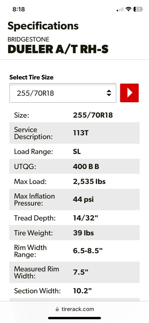

Follow-up on "51 MAX PSI"... included pictures of tire sidewall... which is different than "tirerack.com" spec AnyMal posted... yeah.. curious
Interesting! I think @TimCFJ40 found the issue here.
My LX I believe came on 113XL low pros (21” ultra luxury trim). Buallin!!! Lol. But in all seriousness I think you are okay in the load regard outside of what mystery this tire is about. Could it be XL reinforced? Not sure… unfortunately i don't think you can return these at this point since they are mounted?
My only advice if budget is of concern is add pressure when you run, don’t assume 33 still applies. Even if 113-113 load rating is roughly “equivalent”. And monitor temps from there until you are sure its not heating up substantially.
Sorry, I should have checked my facts instead of guessing. A quick trip to my tire graveyard shows that the 285/50r20 for the 2009 LX is load 112. It's a P style tire.
Agree with above re: PSI guidance, you'll want to watch your tpms psi and make sure it isn't going up more than 10%-15% from cold reading to hot reading.
Hats off TimCFJ40... very intuitive and accurate assessment!
I agree with entire thoughts.
The tires I acquired are from a recent Take-Offs from a 2023 Ford Bronco - <50 miles from dealer lot.
I'm using them for a "low-budget" experimental setup.
