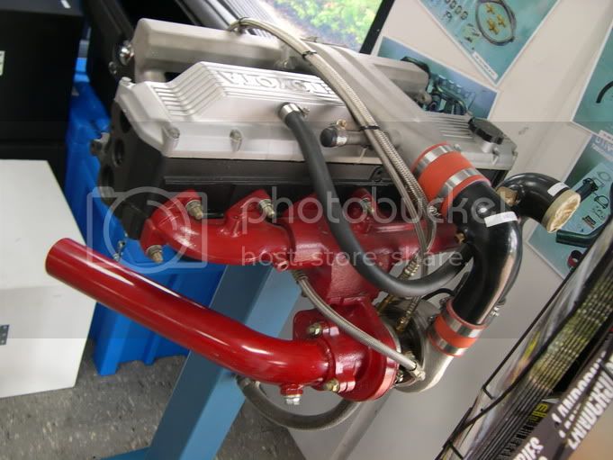

From that picture they would not be able to see if it would be in contact with anything in the engine bay. As Ross says if they said yes and it did not fit for some reason this would be a problem for them. You should be able to work this out yourself if it will fit. These pics are not of a Safari but will give you some idea. cheers
thanks for your reply bigbrowndog. Does that turbo has the same dimensions as the safari? How can i get the specs (measurements) so that I can see if i have enogh space ?
