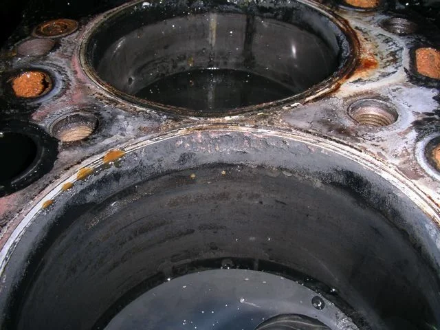

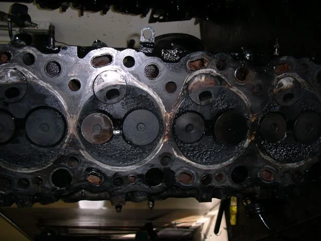

Here's an example of a 2LTE head and block that had a the typical coolant to cylinder leaking problem. Others we see have pressurization of the cooling system, which is typically a one way movement (no coolant enters the engine).
~John

nice pics!! U G L Y !!
