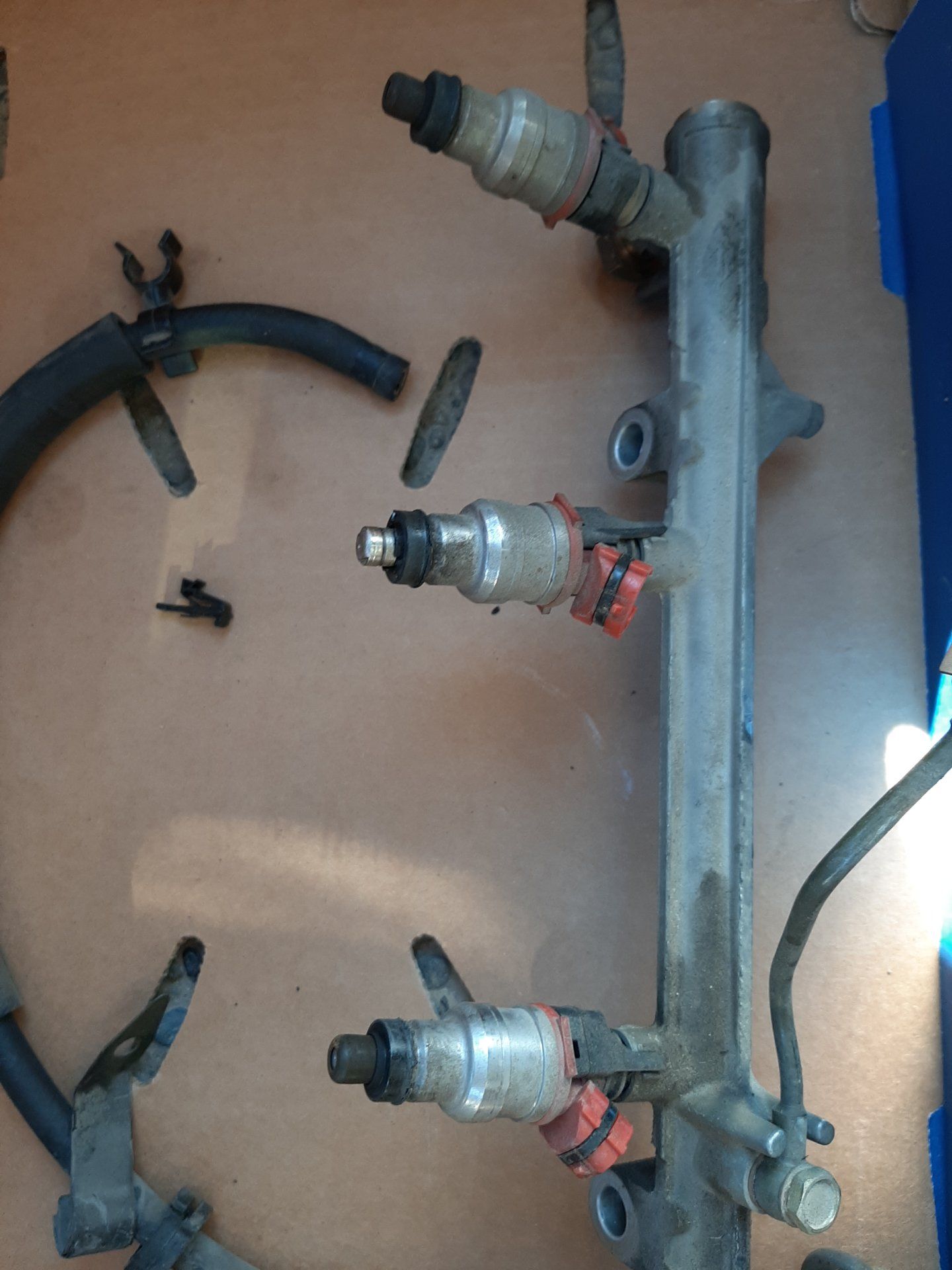

One small victory this morning. I removed my fuel rail to access the hidden Allen bolt underneath. A combination of Liquid Wrench, Hex bit and vice grips and I was able to remove it without stripping the head out. Its all in the little things, lol..
The fuel injector o rings definitely need replaced, one of the little cups that the injector fits into crumbled, so I'll be order an o- ring kit, new banjo bolt and crush washers for the fuel rail, EGR delete kit and a oil pump tonight.
