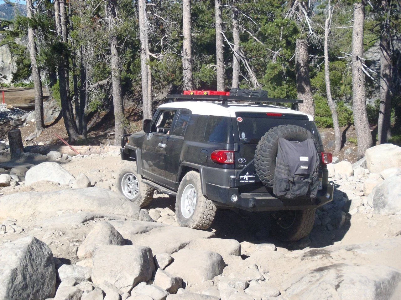

That said, your rear bumper armor thing is going to ruin your fun pretty good, you need every bit of departure angle increase you can get, and that thing is pretty terrible. And those aluminum skid will be pretty banged up at the end of it, but again the trail has been smoothed out a lot since then. You'll have fun, and I'm not knocking your FJ at all, I think it's great you're doing it, but I did change a lot of stuff out on my FJ after I ran it the first time. That is some real wheeling, and most bolt on stuff isn't up to the task.

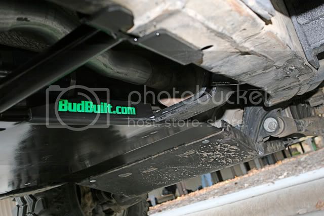

@firensteel - my FJC was the 1st "Tummy Tuck" done by the innovative Bud of Budbuilt. It involves using a "Lefty" t-case, replacing the OEM crossmember, re-routing the exhaust and modifying Bud's skid plate to dramatically improve clearance. You can see it in my build thread in my sig...
Inspired by a conversation with Jim of Inchworm and Bud of Budbuilt at the FJCS2, I talked with Bud and the idea of the Tummy Tuck came to fruition. I dropped my rig off at Bud's for a few days while Bud took the necessary measurements and made the plans to create the new transmission cross-member for the Tummy Tuck. Amazing at the difference made at the "belly" of the FJC. Gained 4" of clearance with the flat belly, nothing is below the frame rails anymore, no fear of getting hung up on anything under the belly anymore...
New measurement where the cross-member used to be, net gain 4"...
Yes, still more to come...

And mine was the first to use the stock t-case and not have to buy a lefty. Either way, the tummy tuck is a game changer like MTB said.

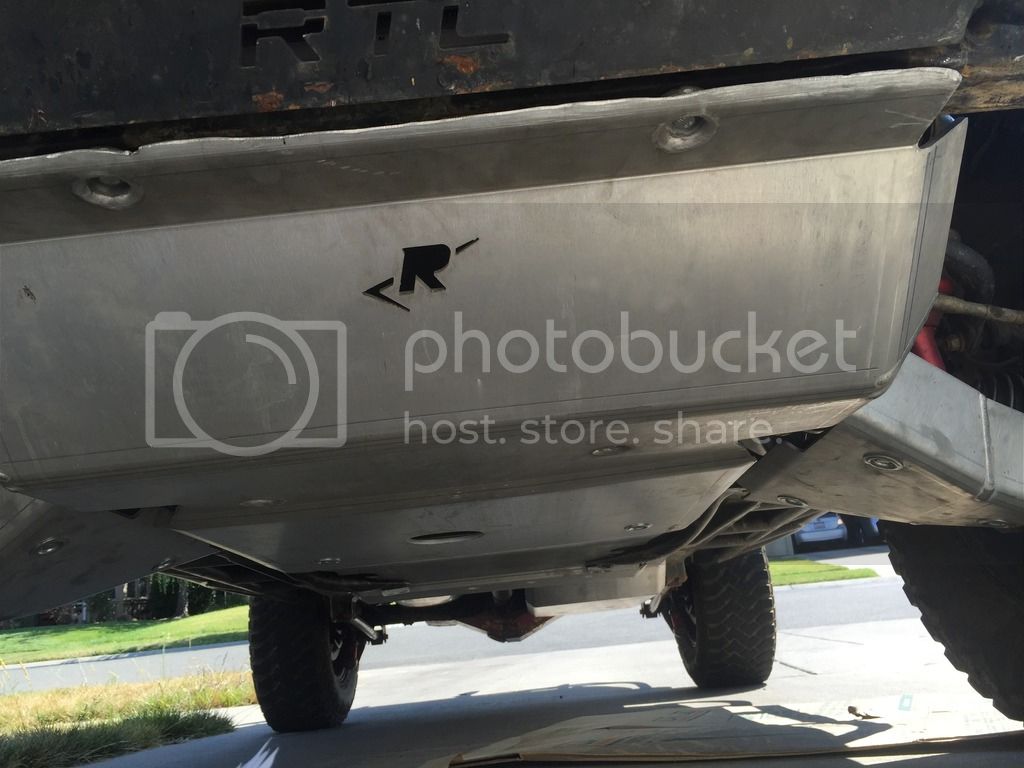

It looks like the rear tube bumper on @Joepokah's rig could just be unbolted for the Rubicon. Otherwise it hangs so low it's likely to get caught on stuff. And it doesn't offer much protection anyway. Otherwise his rig should do fine. So what if skid plates get scratched and gouged? That's what they are for. And the advantage of aluminum is that it saves a lot of weight, which is always an advantage on that trail. Can't offer advice on what spares to bring. Most of the FJC's I've seen on the Rubicon did fine, IF you take your time and pick your lines carefully. Don't be afraid to back up and pick a different line if the first one doesn't go the way you thought it would.
I agree here with TrickyT on the aluminum skids. I have run the Ricochet LCA's for a few years and they are gouged but not deformed, a new lick of paint 2 weeks ago when I replaced my suspension and they are good to go. They are 3/16 inch thick and probably a 60 grade, maybe a 50 grade of Aluminum, hard enough to not just tear up. The higher the number, the higher the alloying content and the harder the material.

It uses a clocking adapter to rotate the stock t case 21 degrees up into the body. Have to beat a pinch weld flat and cut a hole to the right of the shifter because the shifter is now sideways, bend the shifter to compensate.
Once done, you would never know, but it is invasive and defiantly not bolt on. Lots of cutting, pounding and welding. But the results of ground clearance are the equivalent of running 41" tire.
