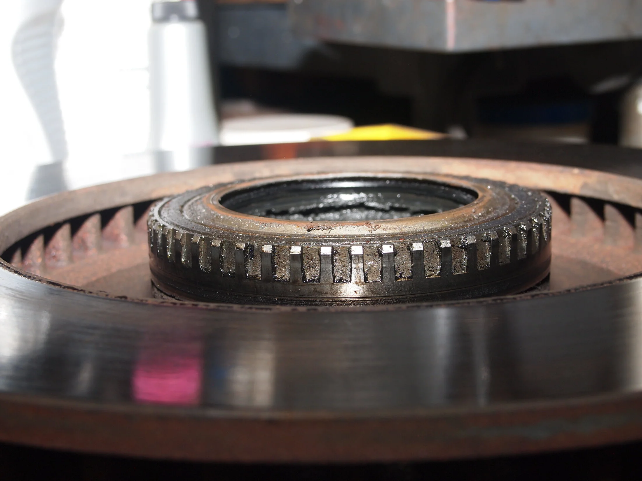

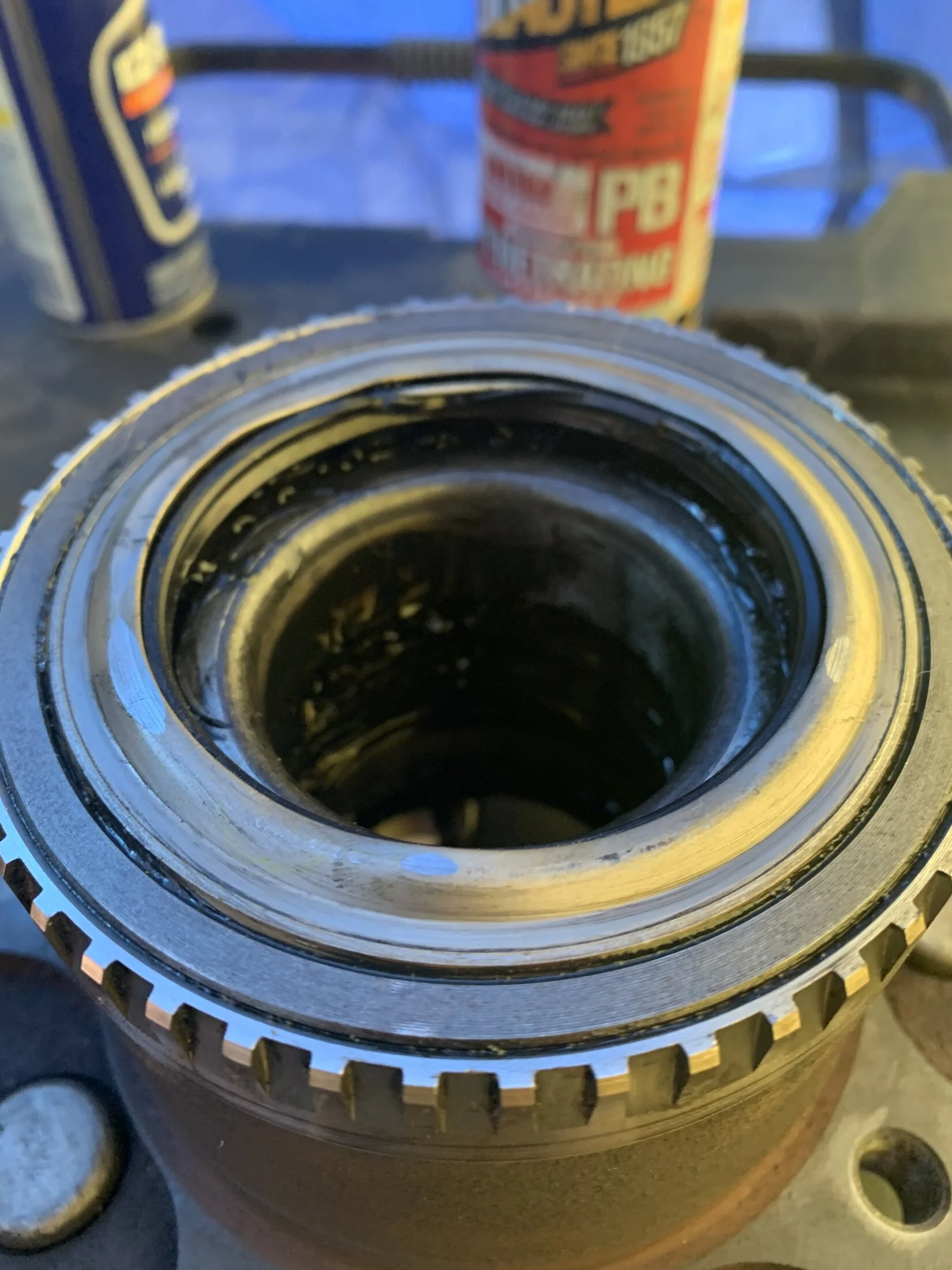

The wheel if that loose and you did set preload properly (fish scale). Is indication they loosened after service. I see happen for a few reasons:
1) Lock washer. Either reused and failed. Or tabs not locked properly (one tab, not bent over adjusting nut and one over lock nut.).
2) Seal in back of wheel hub installed, lip out. This result in metal of seal, rubbing on back of spindle (steering knuckle). The protruding metal lip of seal, is in contact with knuckle, gives false preload reading. Then metal wears and suddenly wheel hub/bearing are supper loose.
Hub seal in backward
Correct install of hub seal, with flat side of seal out and flush with hub. BTW: Do not hit wheel hub with steel harmer, ever or anywhere.
Hub seal in backwardView attachment 3751093View attachment 3751087View attachment 3751086
