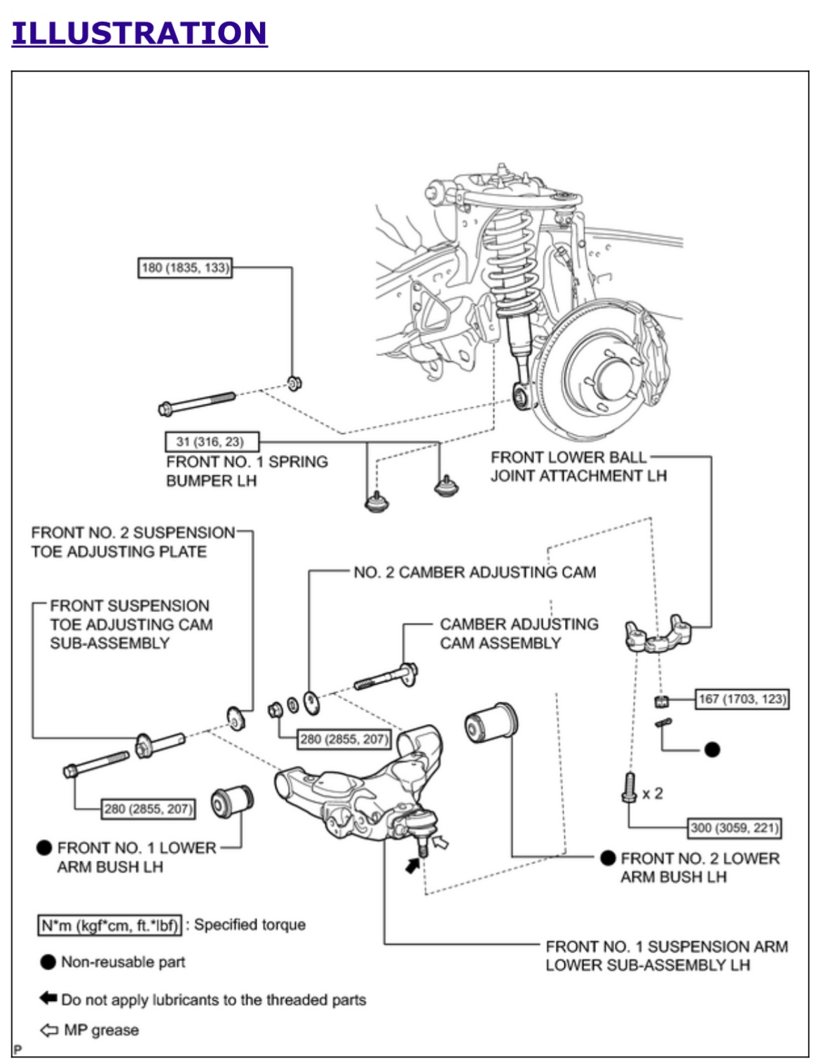

Front on ramps counts as being on the ground. LCA bolts, UCA pivot bolt, lower strut bolt, lower sway bar link bolts, upper link bolt on the KDSS arm side.

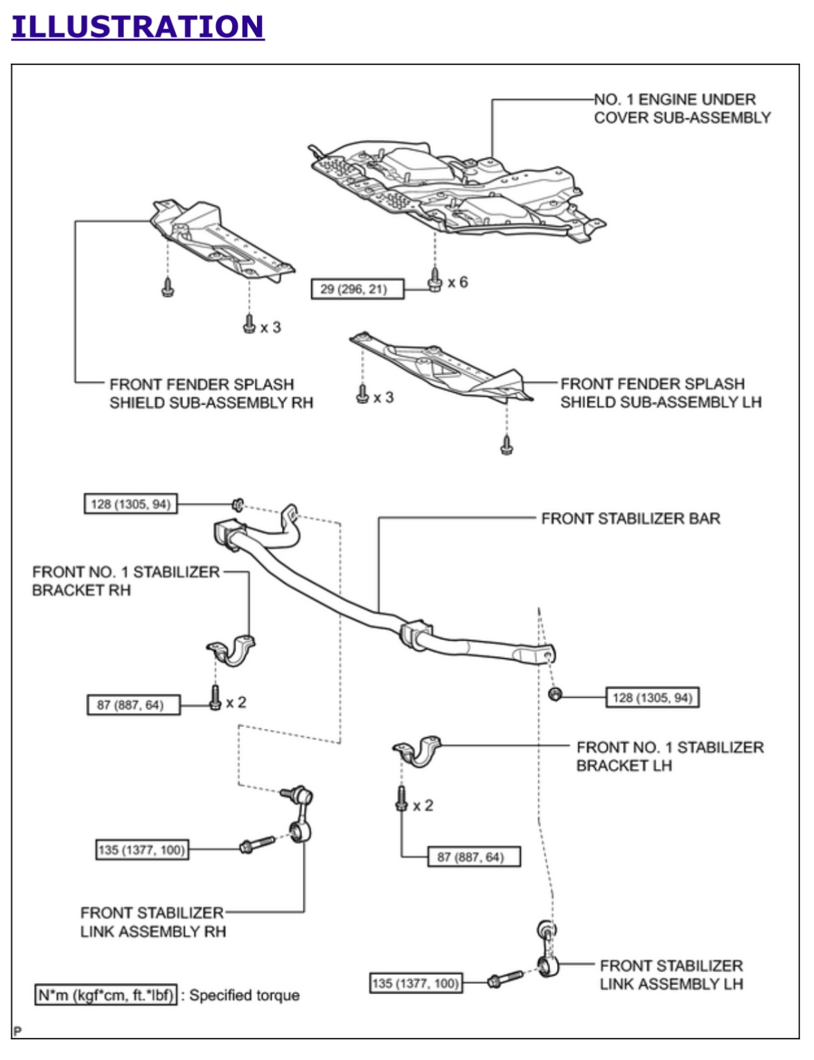

I saw you mention the torque in the other thread at over 200 but on the chart above that Grinchy posted it's only 111. So a bit confused there.
Thanks for the heads up.
Per the FSM my 2013 cruiser needs the LCA pivot bolts to 207ft-lbf.
It shows the same value for a 2009 LX when I dig into the actual diagrams. @grinchy where did that chart come from?
Edit: looks like grinchy’s chart is for the rear arms.
The following are for a 2009 LX
Hmm. That page is for the rear. Sorry about that @Ratchey .
It's from the first section of the FSM (General).
I should have kept the keyword search going until I hit the similar page for front torques page. Totally didn't catch that and glad @bloc did.
Here's the same page but for fronts.
Hopefully I didn't cause you too much heartache and rework @Ratchey

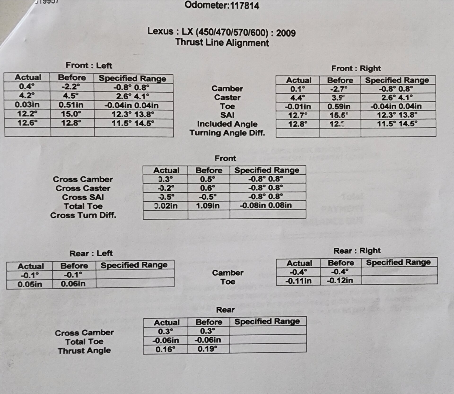

Alignment was way off once I finished. Even after the alignment some specs are still out of range. I forgot to set it to Normal height so don't know if he aligned it in N or L.
May have it checked again after driving it a bit.
