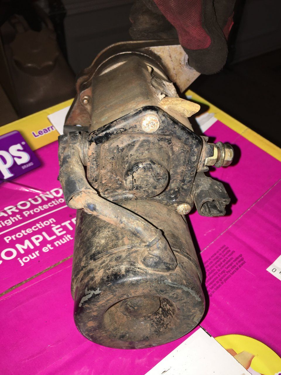

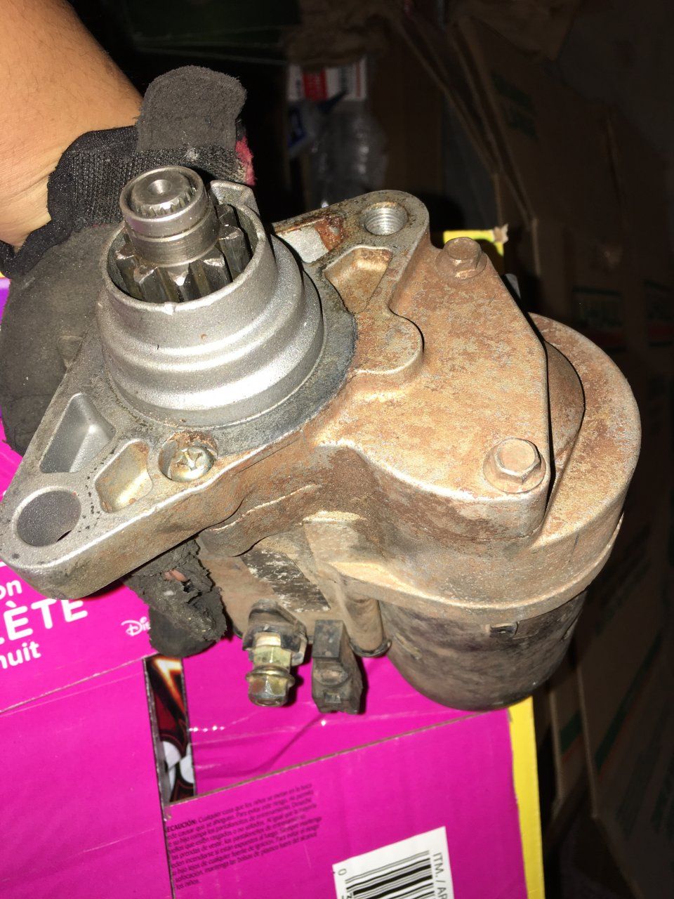

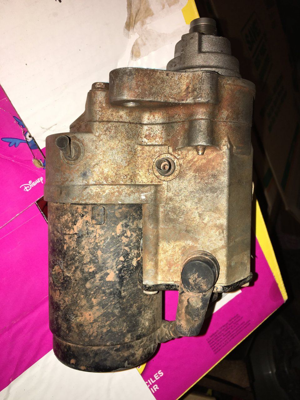

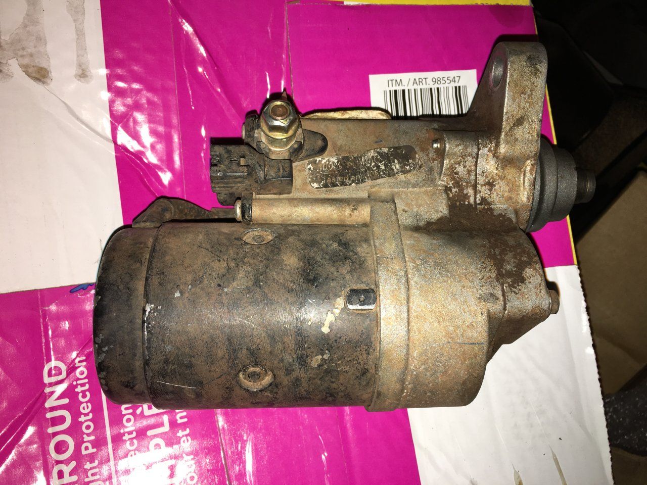

Can anyone identify if this starter is an OEM and fromt which year? My Friend gave it to me to rebuild but I want some more info before I use it.
Does not look like OEM or Denso, the few I've seen have a Toyota or Denso sticker visible on the motor when installed.
He mentioned it's from an earlier 80 LC, it's supposed to be stronger/better/bigger than the ones in the 1997.
That is a rattle-can aftermarket "rebuilt". Before society became overly sensitive and being blatantly truthful went out of fashion, it might have been defined as a "Mexican Overhaul", meaning the exterior was cleaned up and painted and that's about it. Of course today we would never use such offensive terms to define substandard replacement parts. We would simply say (under our breath with a nod and a wink to the fellow next door) "Vautozone has struck again!" The core is OEM, after that it is a crap-shoot.
A spade is a spade......Or is it a shovel?
That is the 2.2 kw starter, the most powerful one. You can tell because the two long bolts are internal and the gear is tucked back in a sleeve. I rebuilt one a couple years ago following Kernal's lead. Still starts great.
2.2kW Starter Rebuild
@DARKNESS great info!!! I was about to order a reman denso and throw this one out. I was through your thread, very good write up, thank you.
