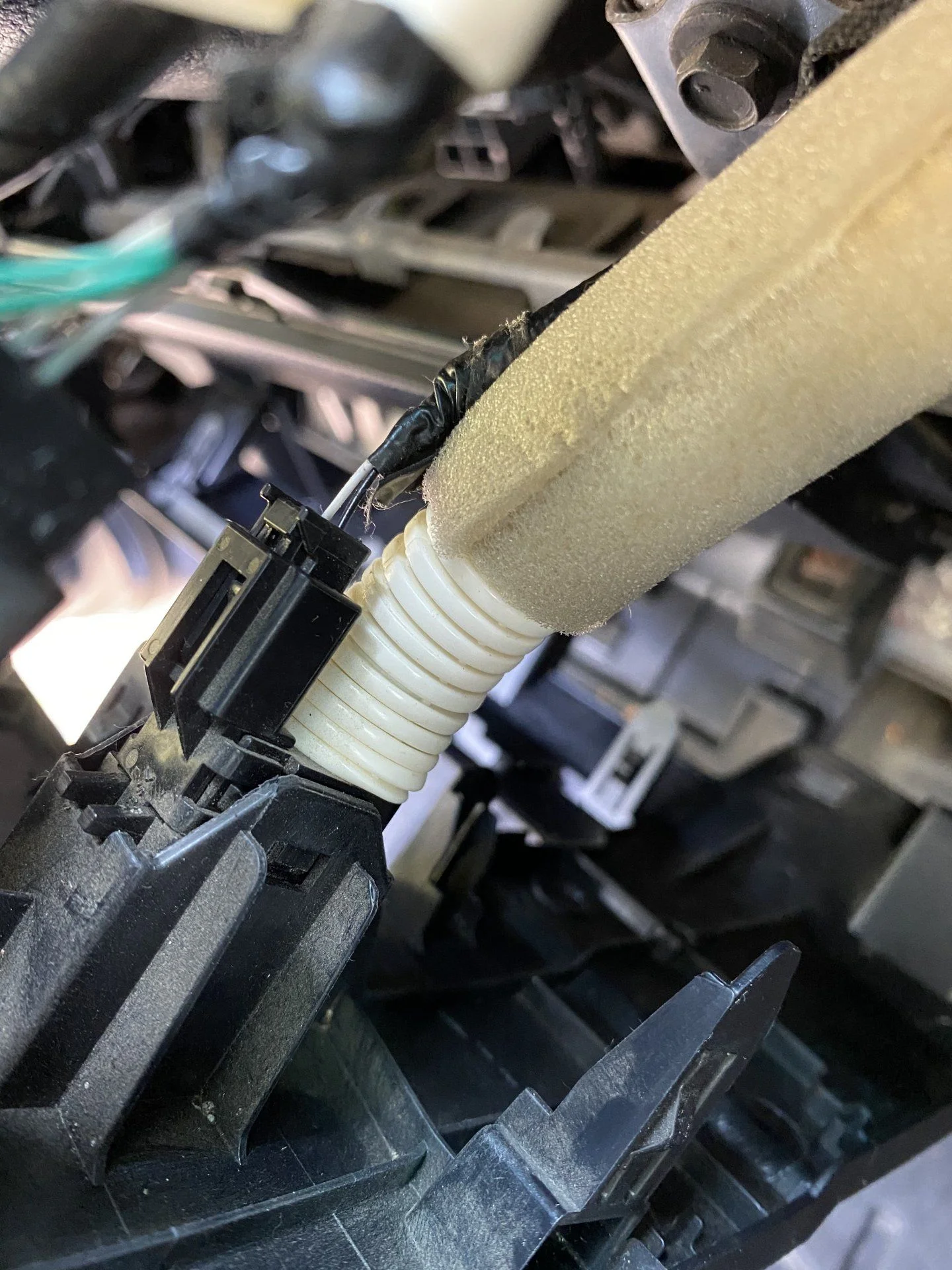

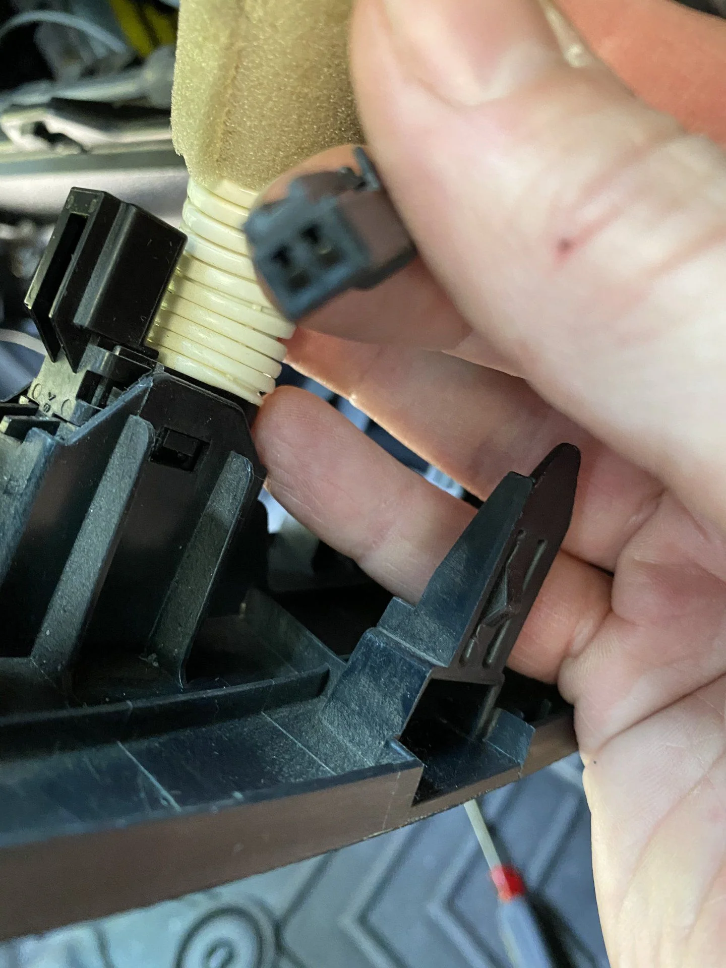

Hi all. Thanks for the replies and thanks @grinchy for the dash breakdown. Since it was a little more involved than just pulling out the ashtray panel, I decided to wait until we were at our home base in Shelton. We are about 30 minutes away and I’ll be able to pull everything off while enjoying a cold adult beverage.
I’ll take a few pics for posterity and any future googlers of this issue.
Alrighty folks. It was indeed the temp sensor. And this is why it’s a good idea to write down the count of plugs that you untether when pulling things apart to ensure that you have the same count when reassembling 😉

And that is how you spend 15 minutes or less to save yourself $300 an hour labor rates at your local dealer. Well, that and a small army of anonymous internet friends to help you troubleshoot while driving I-5.
