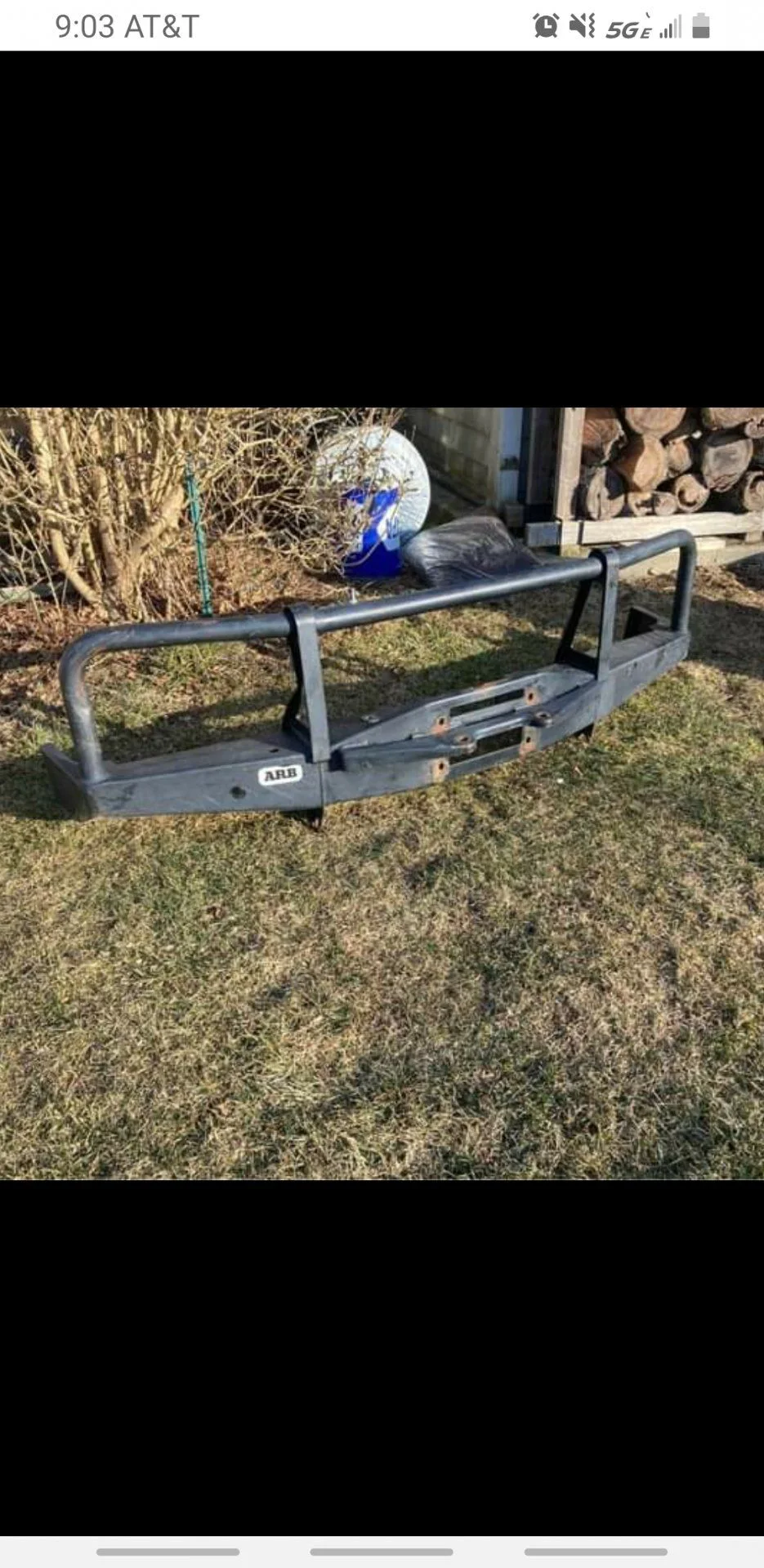

I've got my eye on a used ARB front bumper that came off of a Land Rover Classic. From the measurements I've been sent, it looks wide enough. Brackets may need a slight adjustment. Anyone else ever put a Rover bumper on a Cruiser?

You mean a Range Rover or a series Land Rover? I am sure you could adapt the rover arb with new brackets. I would suspect arb makes one bumper and welds on the specific mounting brackets for a given vehicle.

I have measured to do this when I used to work in a Defender shop as there were a lot of bumpers around, but I never got around to actually doing it. They are very very close. The frame width is the same. It should not be very difficult at all if you are handy with mild fabrication and would be worth doing if you got the bumper for super cheap
Side note when i finally built my own bumper it is a almost a direct replica of the Rock-Ware Defender bumper

Good info, I'll give it a shot! Asking price is $500 which seems like a deal to me. Better than $1,295 new.
Pic attached of actual bumper.
