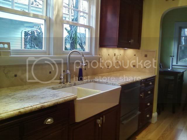

I did all my own 3cm granite with a circ.saw and Bosch 7" blade. I purchased the slabs, a water fed grinder/polisher from ebay and a few other tools. You can do the main part of the cut with the circ.saw and then finish it with a 4" blade attached to an angle grinder. Keep your RPMs low on the grinder. I'd mask everything off and use plenty of water. I know you can use the blades dry, but you don't want that dust everywhere. Wear a mask.
Here's my Kitchen:
Kitchen almost done
Trent,
Your kitchen project and mine are very similar except that yours is approx. a billion times more involved/complicated/awesome.....I just had to make an existing hole in my granite counter top larger on three sides...The result of your effort is spectacular!!! I'm ultra satisfied with the outcome on my small project but its pretty much something you could do in your sleep with your arms tied behind your back...

Thanks. In reality I'm just too cheap to know any better. I had quotes of 70k+ to remodel my kitchen and dining room. Almost $20k just for the radiant heat. I figured if I screwed it up I wasn't that far into each step that I couldn't call someone in. I ended up spending a little over $10k. I was going to do cement counters, but ran accross a local granite slab supply company that was going out of business and bought two full 3cm slabs for under a grand. They gave me the $500 clamp you use to move them with a fork lift. I did all the cutting in November in the parking lot at work. Every step freaked me out, but the sink cut out for the undermount scared me to death. I ended up not having any issues and purchased two more 3cm slabs and three 2cm slabs for other projects.
