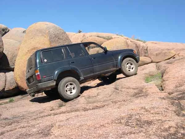

    Ok one picture to show that STOCK trucks CAN wheel!

    That picture is at Roundup this year on the Aggie Highway...
    That was BEFORE I trimmed the flaps and did the side blinkers. I will post close ups of those this afternoon...got to get to work! :D

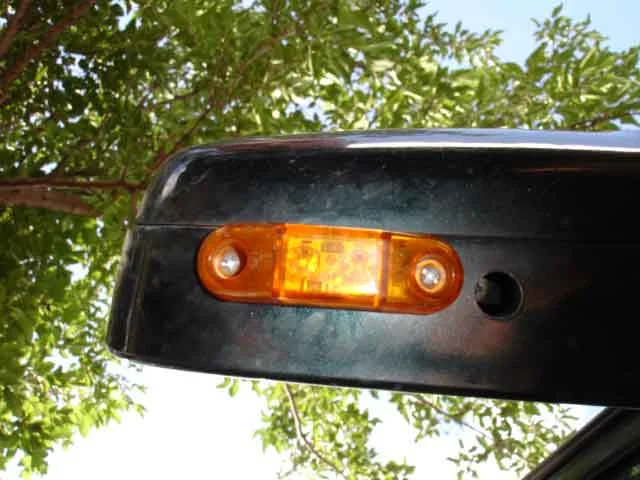

    Side Mirror blinkers...the first picture is from sitting in the drivers seat. Standing next to the truck they appear lower profile than the 2nd and 3rd pictures show. I lowered the camera to be more even with them.

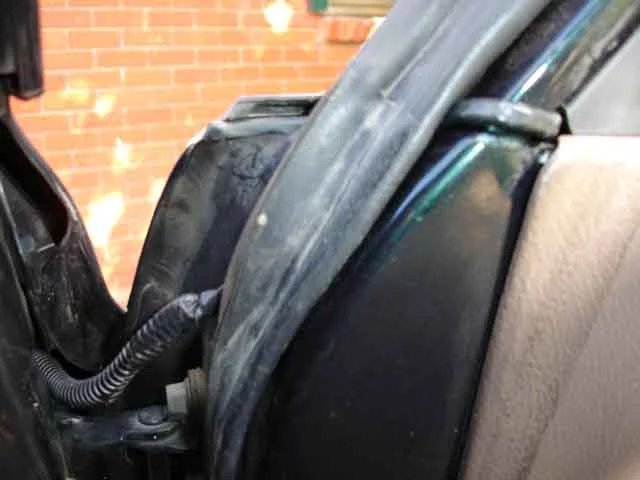

    Clear lenses??? :princess: No thanks! :D I like the amber ones. They might not be quite bright enough during the day but I placed them so they would reflect off the side of the truck, which they do nicely.
    The nice thing with these L.E.D.s is the housing is completly sealed. So there is no way water can get to the connections. There are two small screws which hold them on to the mirror and I was able to retain full range of motion of the mirror.
    The other picture shows the "short cut" wire routing. It cannot be seen at all when the door is closed.
