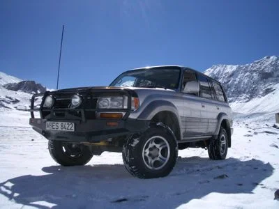

    Nice truck,
    the picture in the snow is great
    why are you ditching the rear bumper? looks good in that shot, have plans for something better?

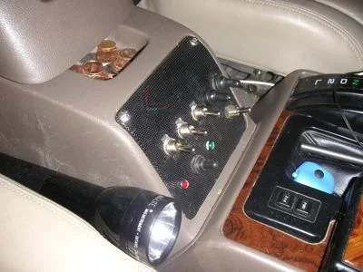

    the set up allows me to run the truck off one battery (stock) Both batteries at all times (duel) and the last possition is with both batteries at all times.
    Basicaly if i run the truck on one battery (stock) i can run a heater int he truck at night to keep warm camping and not have to worrie about draining the battery to far. i can get up in the morning and if she doesnt turn over i can flip the switch and never have to get out.

    Do you have a pic of the switch setup for your dual bat system? Just curious as to your setup in the cabin.

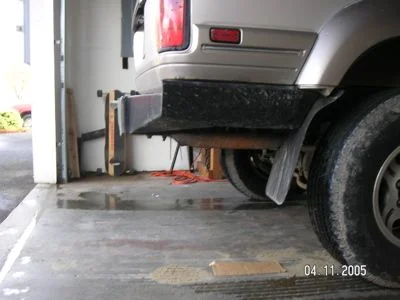

    As for the bumper it was my first attempt at one and while building it i was really pressed for time. i have lots of fun ideas for the next one. One of my bigger ones is side steps to reach the roof that will double as tow points for recovery. I plane to build a few of them this summer for some of the guys here on the board.

    here ya go. i painted it black but you could keep it the factory color as well if you wanted to. when i took the stock sub out i took the box out as well and it gave me a perfect place to put my aux fuse block and line converter for the new sub

    i really cant take credit for the system as its a kit that i bought from painless. it comes ill all thee wires (color coded) and the solonoid. All i had t do was order the stock battery tray and stuff for a early modle 80 which fints in the right hand side. then i moved my washer bottle with slees kit. i had to get the battery cabels of the right length and i welded a mount for the solonoid. I rewired my fj40 from scratch and then i rewired it again with a painless kit designed for a chevy truck. i did the chevy truck one becasue i had installed a gm tilt steering column and no i can just plug my harness into the coulumn for my turn signols, horn, ect...

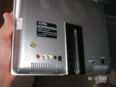

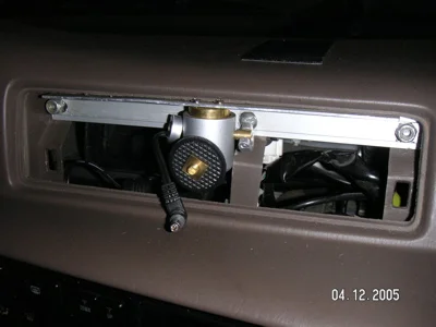

    The flat screen is attacked to the stock holes in the dash that usualy hold the clock. Its not the most ideal place but its the only place i could think of that doesnt block my site other then on my hood. That and every one in the truck can see it with out struggle. It has just about every connection u can think of in the back. i run dvd players on it when i make the drive home from washinton to az. and ill be able to run GPS which is what i really wanted for it . I have an old lap top i plan to run under the seat and run a wirless mouse -key board, however it looks like if i can gather up somee money this summer i may run the new mac mini which ill mount in the stereo slot.
    thanks again for all the complements and im really happy i can contribute something to the board.
    edit: i also forgot to mention i can take the screen off and on in under a minute so i dont have to leave it in the truck and worry about it getting stolen.

    For those switches related to the dual batts - what are they rated? Reason I ask is most guys that have the marine switch try to not set up the winch through the switch because of the heavy draw.

    well the dual battery set up runs off only one switch. you can look the kit up on painless web site and i think i bought mine from summit racing the kit is a 250 amp and comes with everything u need including two lights for the 3 position switch so you know what position your running in. and for the guys with 40s or less weather proofing on there trucks you can pay a bit more and get a water proof kit although a little liquid tape and you wouldnt know the difference.

    mike it looks great. I like the rear mudflaps!

    HAHAhaha yeah well after the bumper i was pulled over 4 times for mud flap violation so i just cut up some napa ones and attached them to the stock holes.
