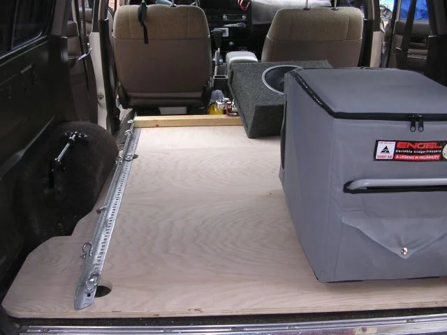

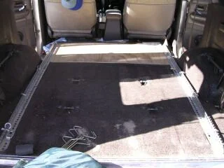

    Rear Cargo Rails (With rear seats out)

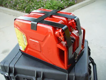

    Dual NATO can carrier

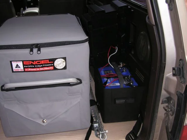

    Rear Battery Box & Fridge

    Very nicely equiped rig, I love the rear battery.

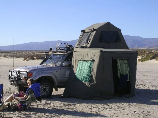

    Very cool setup! Where did you get the Hannible awning/roof top tent? Do have any pic of the rear of the truck with ladder going up to the tent and/or with just the awning extentended? I'm curious to see how you get into that thing.

    I love the tent...I was lucky that Junk happened to get a new trailer and his wife wanted more room in the garage, so I picked it up from him. Same with the awning.

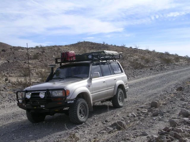

    Most of the wheeling I do really doesn't require tires larger than 31", and the 3FE is already a slowpoke without adding extra tire to turn, so I've stuck with 31s.
    Because of the 3FE and power considerations, I've not added the extra weight of sliders or a rear bumper. One spare tire is in the stock location, and the other is on the roof rack when necessary.
    Here's a ladder access pic....

    More details on your cargo tiedown rails?

    The cargo rails are 6' sections of perforated galvanized angle from the 'ol Home Depot. I've bolted them down to the floor through a 3/4" plywood section to the factory tie down captured nuts and added small shackles which can move to where I need to strap stuff down.
    For trips, my gear is contained in Rubbermaid Boxes, and strapped down using ratchet straps...no bouncing or clanging around in the back!
    -H-

    Nice! I like that it's infinitely adj for different tiedown positions.

    Sweet rig, nicely done, do you have a pic of the awing closed and how is it attached to the rack, is that a Pelican case that the jerry cans are resting on? If so what size? I am considering purchasing one for my recovery gear. Again very nice rig
