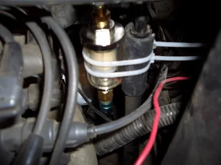

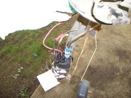

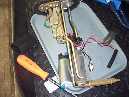

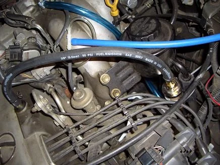

    I put in this walbro 255 fuel pump to add to my turbo set up. you will notice I used a piece of silicone hose. this was stupid as it "popped" the day after the install and I had to replace it with a real hose. PITA. I should have known better. The first pic is of me riding a mini horse my mom rented for my little girls.

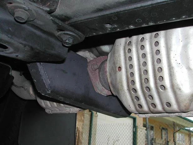

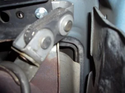

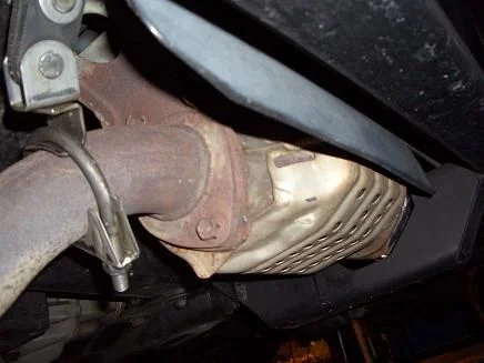

    here is the cat I recently cut and turned. This is an easy mod if you have a wire welder. If you can do it with a stick you are even cooler. I hung a different hanger
    Note that I only have one cat as I removed the other one with the turbo build

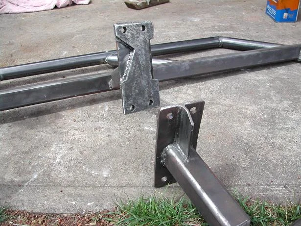

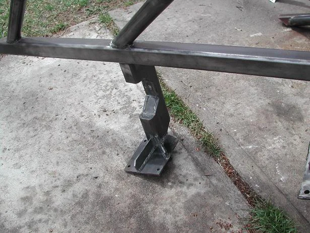

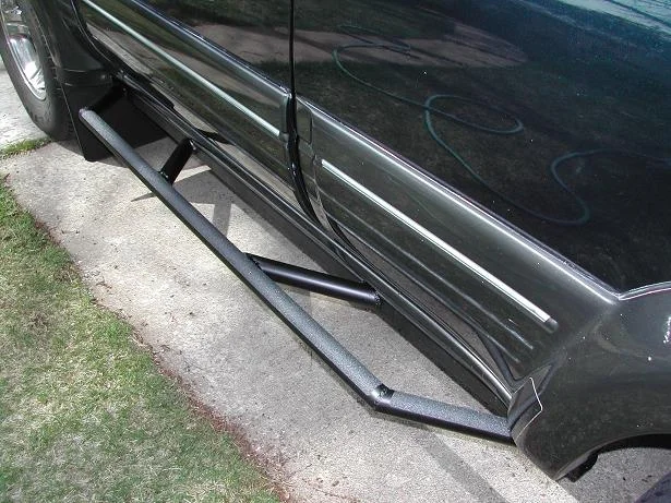

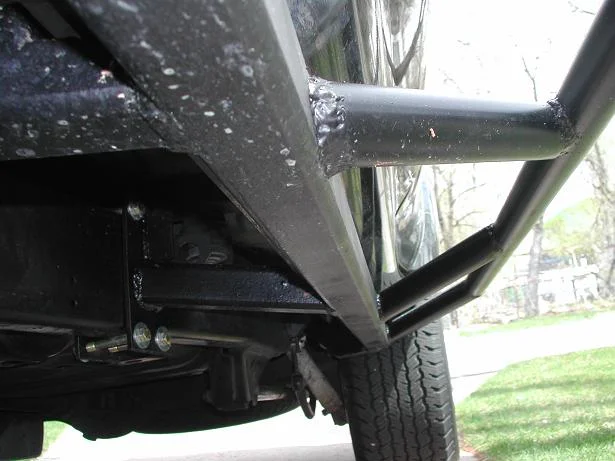

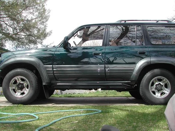

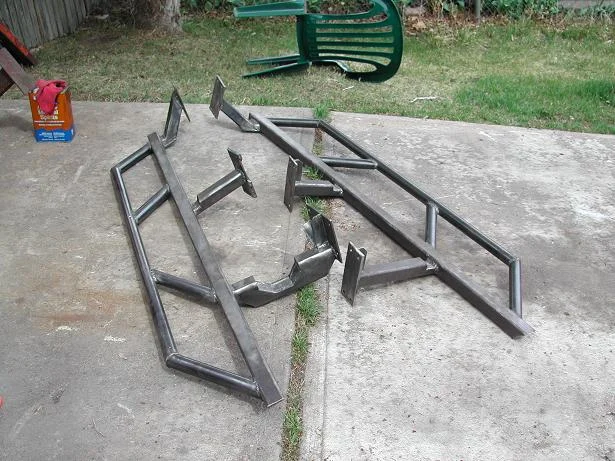

    slider pics. Bolt on sliders were a more difficult build for me than bumpers.
  4. Dusty
    Dusty
    Messages:
    2,595
    Likes Received:
    42
    Joined:
    Oct 7, 2004

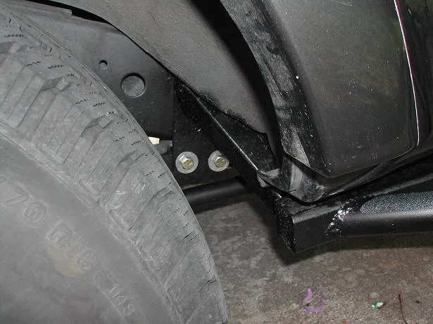

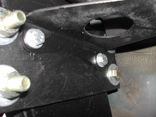

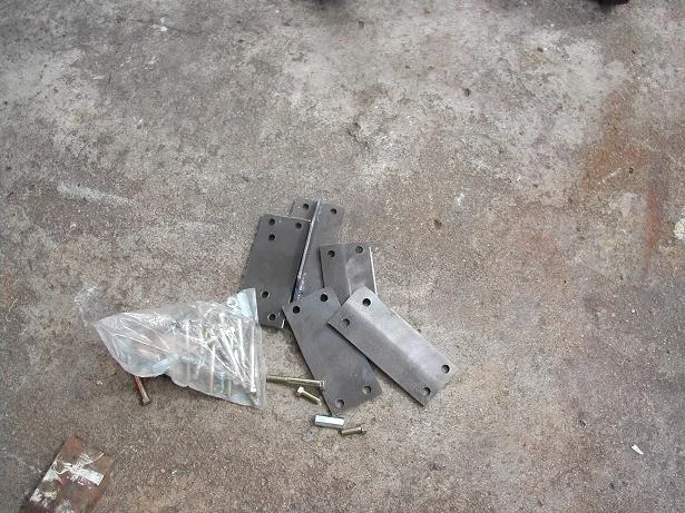

    I used 2x2x3/16 for outriggers. I believe it was 5/16 for frame plates. the round tube is 1.5" sc40. I did 4 bolts per plate and it is strong but u bolts would be as strong and would be easier to assemble (see sleeoffroad.com)

    They are wide to punish careless ricers in the parking lot

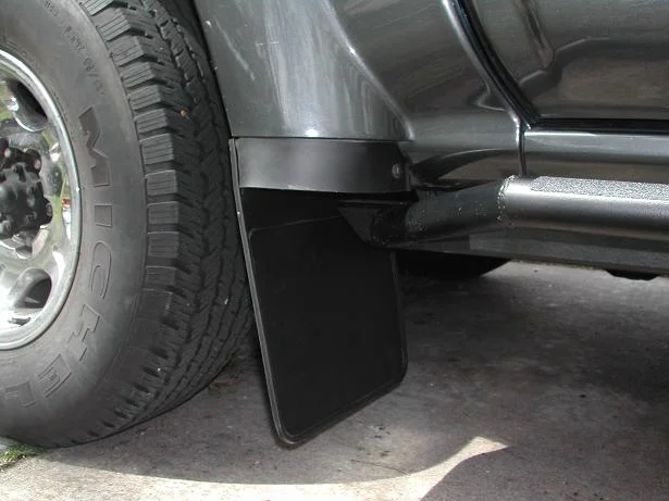

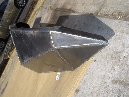

    home made mud flaps too. my real outrigger goes all the way to the end
    note pre cat turn

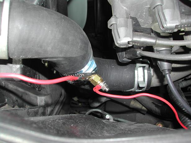

    preluber before i removed it.
    see the auxilary temp guage sender (before the cool oe gauge mod came out)

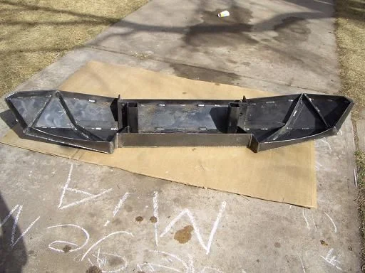

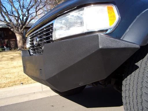

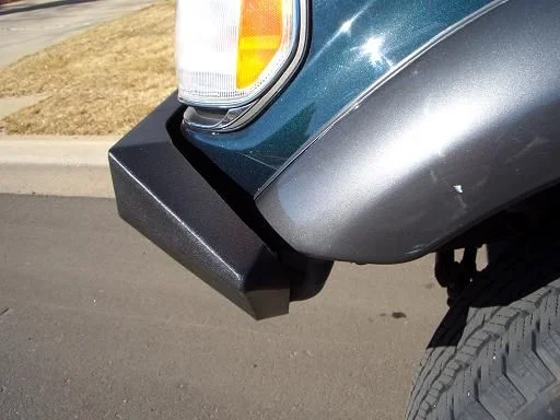

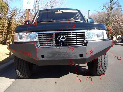

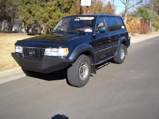

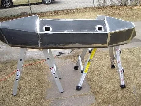

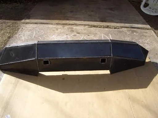

    front bumper
  9. Dusty
    Dusty
    Messages:
    2,595
    Likes Received:
    42
    Joined:
    Oct 7, 2004
    make sure your welder has a good duty cycle if you run long beads like this. I roasted my dads snap-on mig/tig on this bumper
  10. Dusty
    Dusty
    Messages:
    2,595
    Likes Received:
    42
    Joined:
    Oct 7, 2004

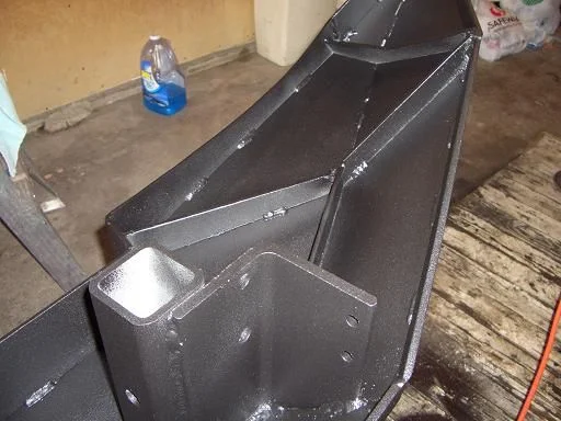

    3/16" mild steel
    GW Nugget likes this.
  11. Dusty
    Dusty
    Messages:
    2,595
    Likes Received:
    42
    Joined:
    Oct 7, 2004

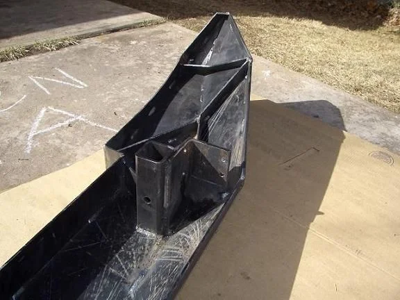

    notice that i have tossed that front facia piece that holds the blinkers. now the blinkers are in the corners. If you want to run all your intercooler ducting below the pass headlight you will find it much easier to do if you lose the facia. note also you can lift the ac dryer a good 1.5" in its holder-i did for this bumper

    better aproach angle. the 2 holes in front are for a receiver hitch. someday i will make a quickly removable winch shelf that slides into the holes so that i don't have to carry the winch around town

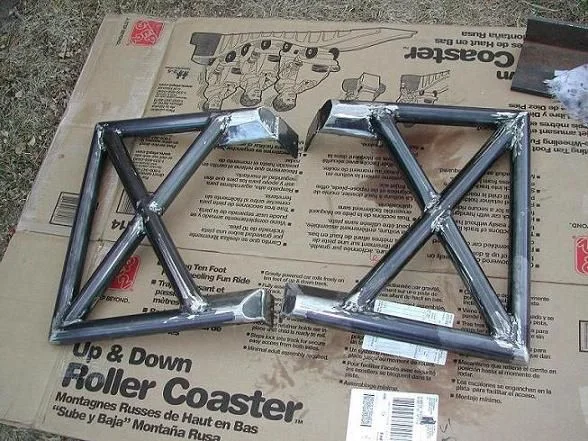

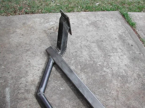

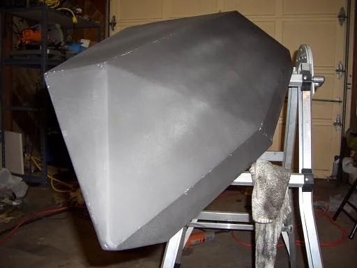

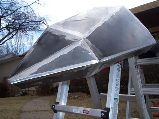

    If you can build this without a plasma cutter you are dedicated. If you do it with a hack saw you will be buffer than TYLER.

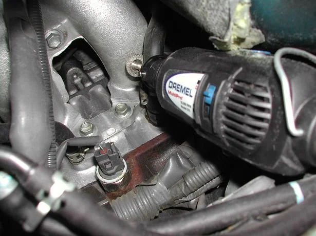

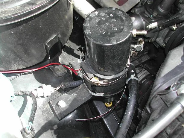

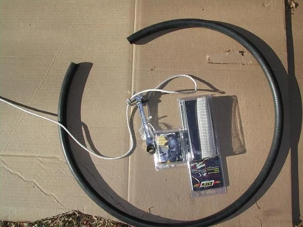

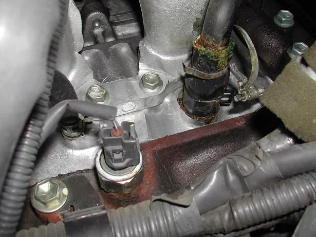

    the PHH blows (punn intended) so cut it's clamp off with a dremel and use one long piece of cheap heater hose. I did this and am going strong 5000 miles later. Nect time I change it will take 15min

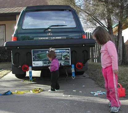

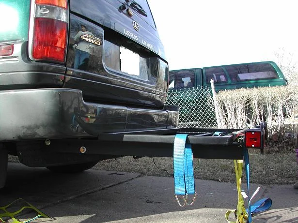

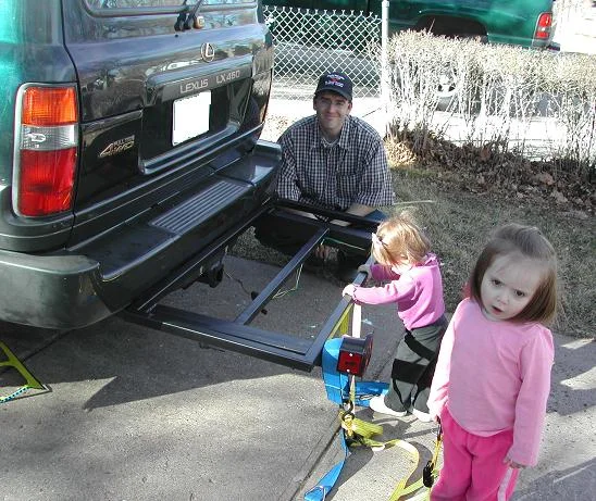

    the cargo carrier is so helpfull in carrying my girl's stuff on long trips (plus extra water, tools, tire chains, dog food, oem service book, etc etc. keep the heavy stuff out of the cockpit in case of crash. the carrier has been modified to fit my new bumper

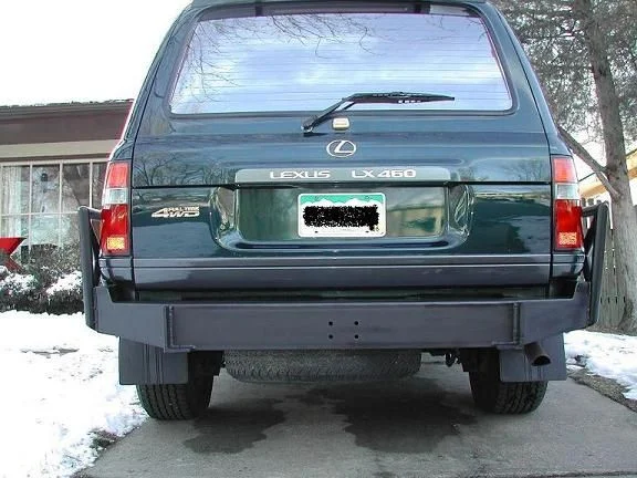

    im digging out other pics of the rear bumper. will post soon
    the corner protectors are removable

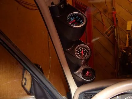

    my new gauge cluster. got it for $20 on ebay and trimed it with the dremel-need to cover the top part better so the bolt isn't showing. it houses my digital water temp, my boost, and my egt. the a/f ratio is down by my l knee.
    I recently watched turbocruisers catch can instal and I even baught a cheap one on ebay. instead I baught these 2 oil/air seperators from harbor freight for $5 each-so i have the oil issue covered (hopefully) at both sides

    I like seeing people fab their own mods.
    I did the ubolt thing with my sliders and wish I had just done the backing plate like you did. Look forward to seeing more on the bumpers and turbo
