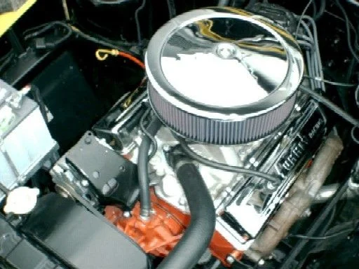

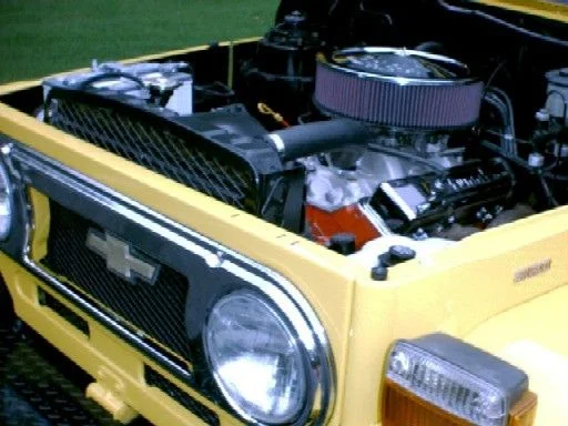

under the hood is wayyyyy to clean...how the he%$ do you keep it that nice?

it's Dave's vehicle (aka dgangle) he asked me to post it for him and emailed me the pics (because i think he's low on pic space).

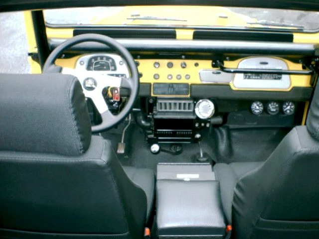

how do you like the floor mat, by the way? i have an old set of SOR carpet floor mats that are wearing mighty thin... i have e 5 speed tranny, so my hump has a modified box bolted to the top, so i am looking for something clean that will follow lines nicely, and will allow me to cut holes the right way. would the mat allow for a 2 inch hump on top of the tranny?

Looks great! Is the color that pale in real life? Or is it just the scanning and image transfer stuff. It looks like the viper yellow a bit.
Is that a floor mat or did you rhino line the tub?
