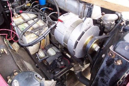

what all was involved in that alt install, i'd like to do that with mine as well? what part number and from where? what kind of bracket did you use on it? thanks man...

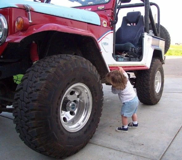

74fj40 said:
very colourful, i have the same lift as you, how well do those 38's fit? did you trim the rear?
I've had to trim a bunch. The front springs are flipped, moving the axle forward ~3". The front of the fender has been trimmed just above the hole for the turn signals. I still need to get an IFS widening kit to keep them out of the inner fenders.
The rear springs have not been flipped yet as I have a NWMP gas tank that need to be modified first. I run 1.5" spacers on the back and they rub the front of the wheel well hard when compressed.
The alternator was for a Chevy small block and it nearly bolted right up to the Toyota bracket. I think I had to add a washer as a spacer between the alt and bracket. I used flat bar stock, 1/4" I think, for the extension for the upper bracket. I used a GM heavy truck pully and measured out the belt.
I'm not real sure on the parts number, I found a local dealer and we checked the cases til we found one that fit good. I like not hav'n to worry about the voltage regulator and crap now too. One wire, self-activating, internal regulator, 160 amp that will need up with the winch is :cool:

thanks for the info...if you could pull a serial number off it or something i can use to identify the correct one that would be great? how much did it run you...
your rigs saweet, thanks for your time
