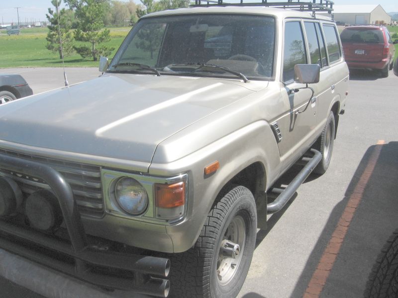

I tried Jeep, Chevy and Ford for the next 7 years but always missed my Toyota, especially when it came to wrenching, mostly because I never needed too. I decided I wanted another Toyota and wanted one I could sleep in as I camp in Grizzly Bear country often. The 60 seemed to be the perfect size and in my price range. In 2007 I made an eBay buy on the '83 that spent most of it's life in Tucon, AZ. Being 99% rust free was the good part. The bad part was everything was worn out, leaks everwhere, etc. I wouldn't buy one without looking at it first, but anyway here is what it looked like when I brought her home:

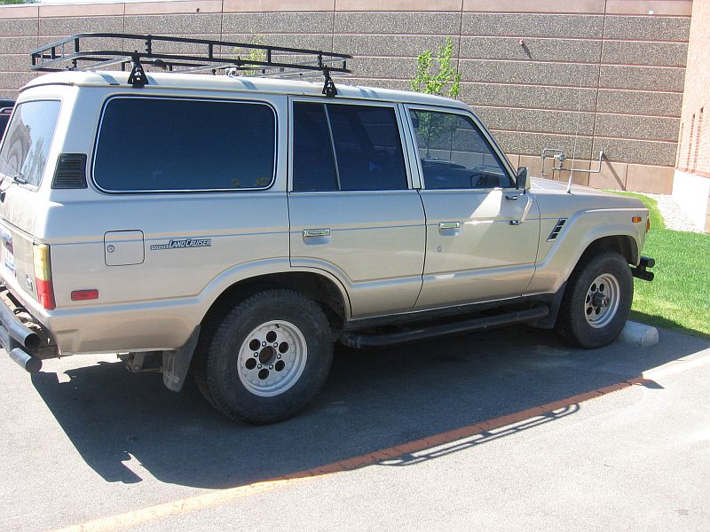

Here is how she sits today:
