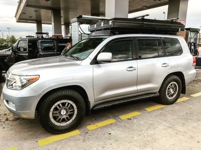

I have a set of Malone crossbars that I've had my roofnest on for the past 3 years between two cars. I've had it on my LC for the past year and 15k miles without any issues. You'll probably need aftermarket crossbars due to the space needed to tighten down the tent. My crossbars add additional 3-4 inches and I can barely stick my hand through to tighten the bolts into the crossbars.

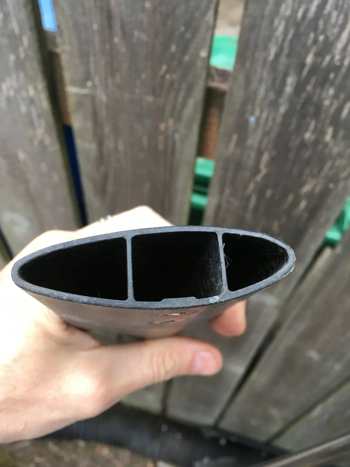

Here's the cross section of the stock cross bar. It's plenty strong.
The stock cross bars are actually very strong. They are also designed for some flex, as that likely aids long term durability.

I had my James Baroud Grand Raid XXL on the stock cross bars and rack and had absolutely no issues. The tent was so massive that I also put .5 inch slats on the rails so the weight of the tent was distributed on rails and cross bars… looked silly but worked great. I have sense put on a front runner rack but only because I wanted a roof rack :). And as others have said… it was a major pain to tighten everything give the clearance… I bought an extra long wrench… annoying but it did the trick!

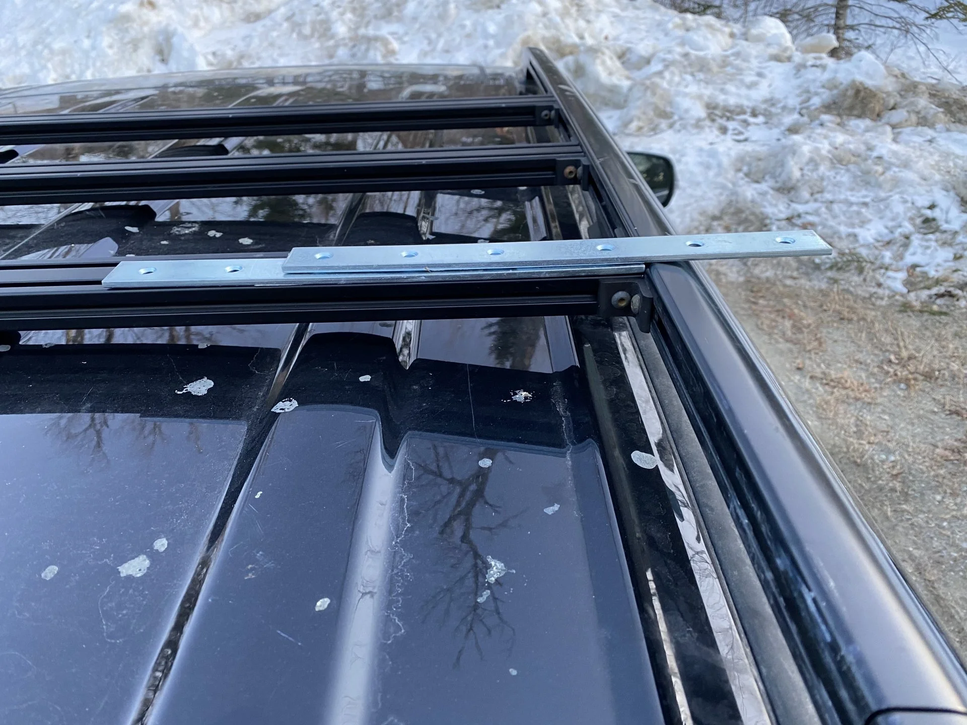

I ran an Alucab on 80/20 bars. Cheap and versatile and with t nuts you can add all sorts of accessories
worked well but I had to create my own bracket.
