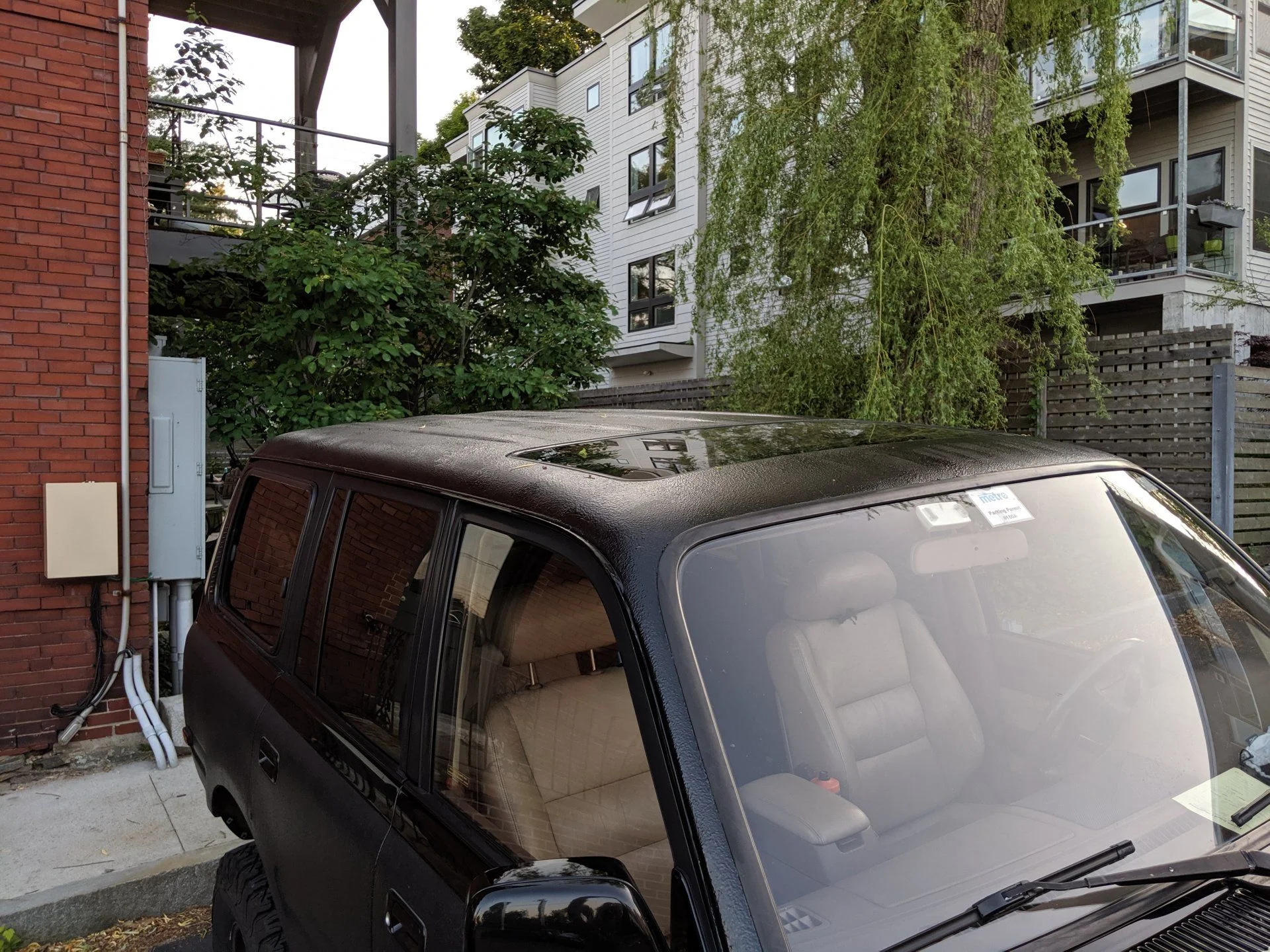

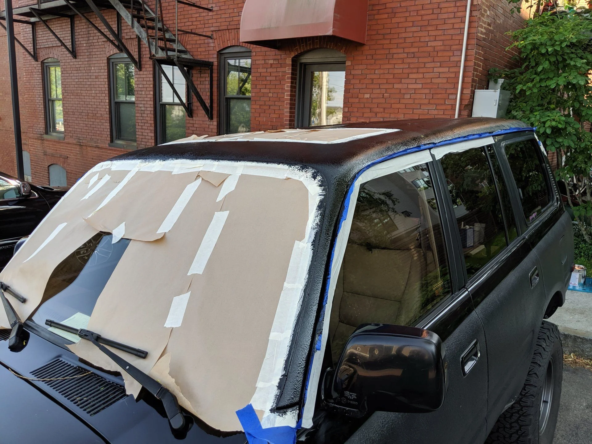

I painted my roof with Monstaliner. Just rolled it on after proper prepping. It came out fine with no issues, and it is easy to clean. I also filled in my roof rack holes with threaded rod and JB Weld before hand. It's not 100% pretty, but this rig isn't going to win any car shows anyways.

Looks like a good outcome. Mine is no showrunner either. It's a proper 4wd and had taken lots of beating over the time I've owned it. Biggest problem now is body rust. The roof is something I hope is easy (relatively) to deal with. it's also the biggest contributor of NVH being a large mostly flat 'drum'.
