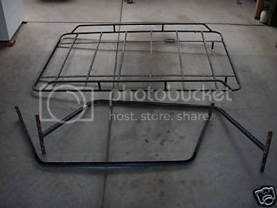

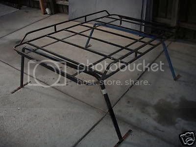

BTW, the rack you got from Ebay looks nice to start from
Thanks Ron,
I picked up the rack yesterday. 300k round trip. $50 rack,
$40 fuel.Pretty good deal. The rack just needs a wire brush,
kill rust undercoat and a black top coat and it will look brand
new. I'm still weighing up my options. I like the exorack
idea alot but I'm not sure if it will make my rig look fugly.
I will design very carefully.

Boogie, seems like a nice rack to start off with, I'am thinking of going with alluminium tubing, round for the frame or perhaps sqaure ?

Hey Bennie,
The steel rack I've got is pretty light. Probably weighs about 10kgs or so. Aluminium would be even better for light loads
and they flex more than steel which would be good for the frp top. I'm still undecided which way to go with mounting the
rack. I could bolt some gutter mounts to the rack and put it on or go to the hassle of fabricating a cage to mount the rack
on. The cage it going to add weight up top which is going to create a higher center of balance, increase fuel consumption
and so on. I really want an RRT for treking so I need a rack.
