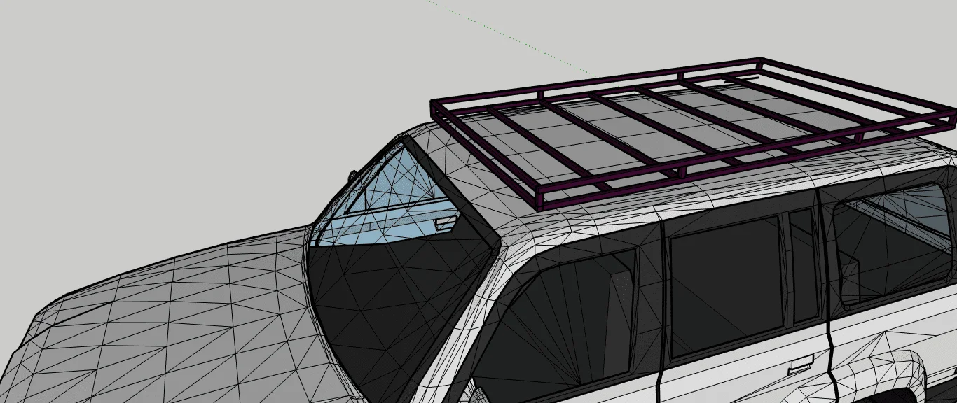

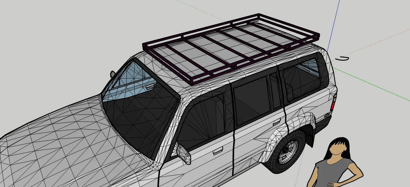

So I've bought a welder, and I've made a work bench, a small table, a picnic table, and welded some diamond plate on my wife's rock sliders.....so since I am basically a professional fabricator now I've decided to have a go at building a rack for the LX. I want a very basic low profile rack that could support eventually an RTT, and without the tent I'd probably only ever have like 300 lbs up there. The design would have a bottom rail, and top rail, but only separated by about 2" so it's low profile, while still providing an edge so things couldn't slide off easily.
I'm looking to build it out of square tubing, because I don't have a tubing bender or notcher, and I don't really want to mess with it. I'm wondering if I use 5/8" square tubing if that will be enough, or if I should go with 3/4" square tubing. I'm debating on whether I would want to weld in expanded metal for the floor, or just use cross braces of the same diameter as the rack.

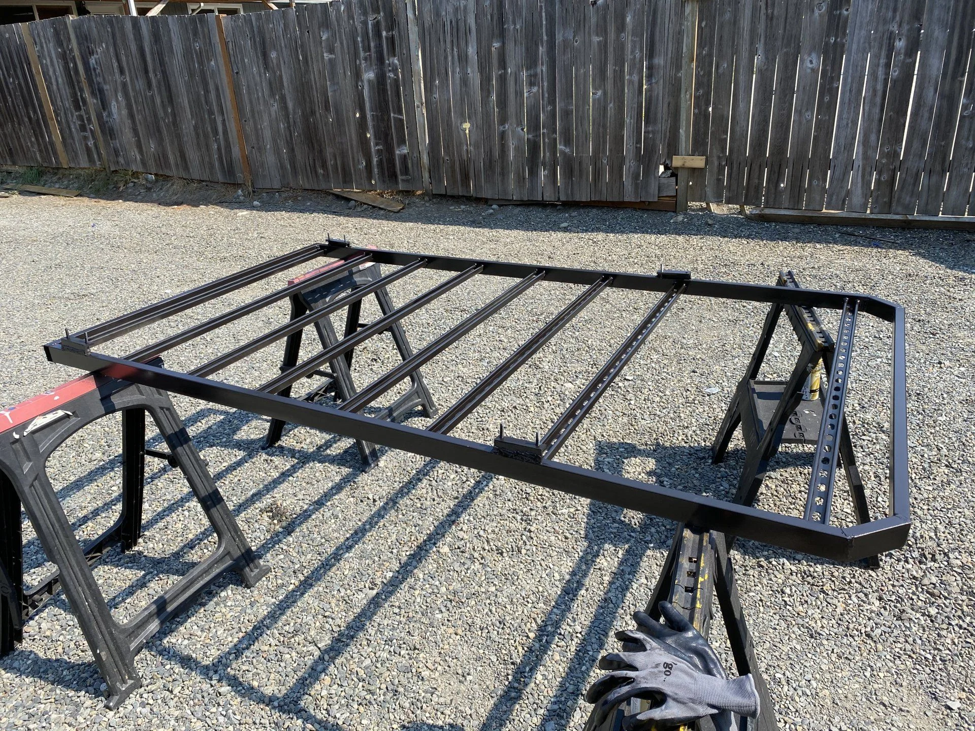

Essentially this design, but with square tubing (and on a 100)
