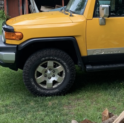

I’m coming back to an old question . I would like to know if there is a way of stiffing the suspension on a 2008 FJ cruiser? Called the Toyota service center and was told that they don’t have a stronger,( bigger diameter), sway bar for my fj. They also said there wasn’t a same height, but stiffer coil spring product in there inventory .
Im not trying to raise the vehicle, just stiffen it up. Seams like in the day I could shop for a thicker sway bar for hot hod builds . And also with measurements of the coils I could order stronger ones. Anyway, I could always air bag it but didn’t want to go that rout.
All my bushings are good as well as the from end ball joints. I don’t see a problem and I think its just the nature of the vehicle. I owned two FJ 40s , 1978 and 1980. Both would not be as susceptible to wind ,( rocking ), or felt loose pulling a light trailer. Any help would be appreciated . I attached a picture of tires. Though maybe they are the culprit
