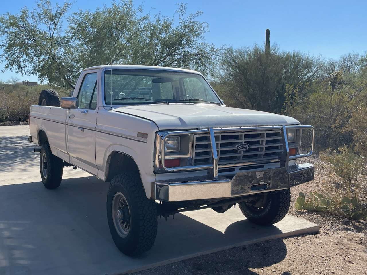

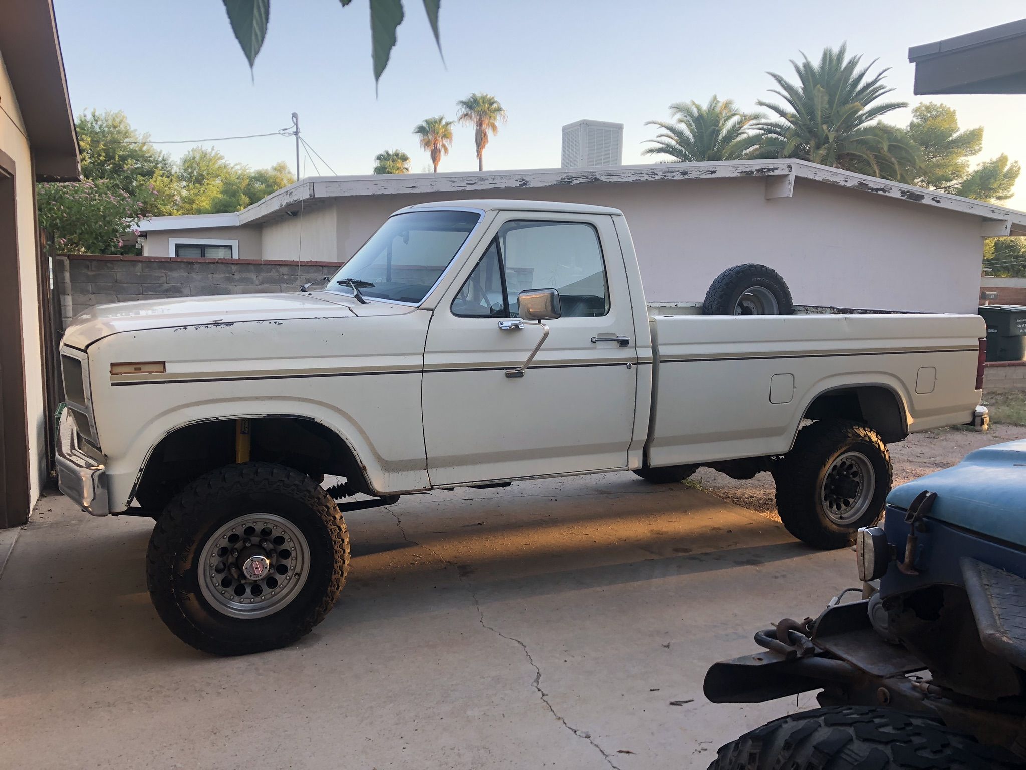

Haven't had to do anything to the truck the past couple weeks but she is still looking good.
Love that style Ford pickup.
You and me both! They aren't anywhere near as popular as the ones in the 70's or the OBS ones, but they're starting to pick up in popularity! I'm glad they aren't though since parts are still cheap 😄

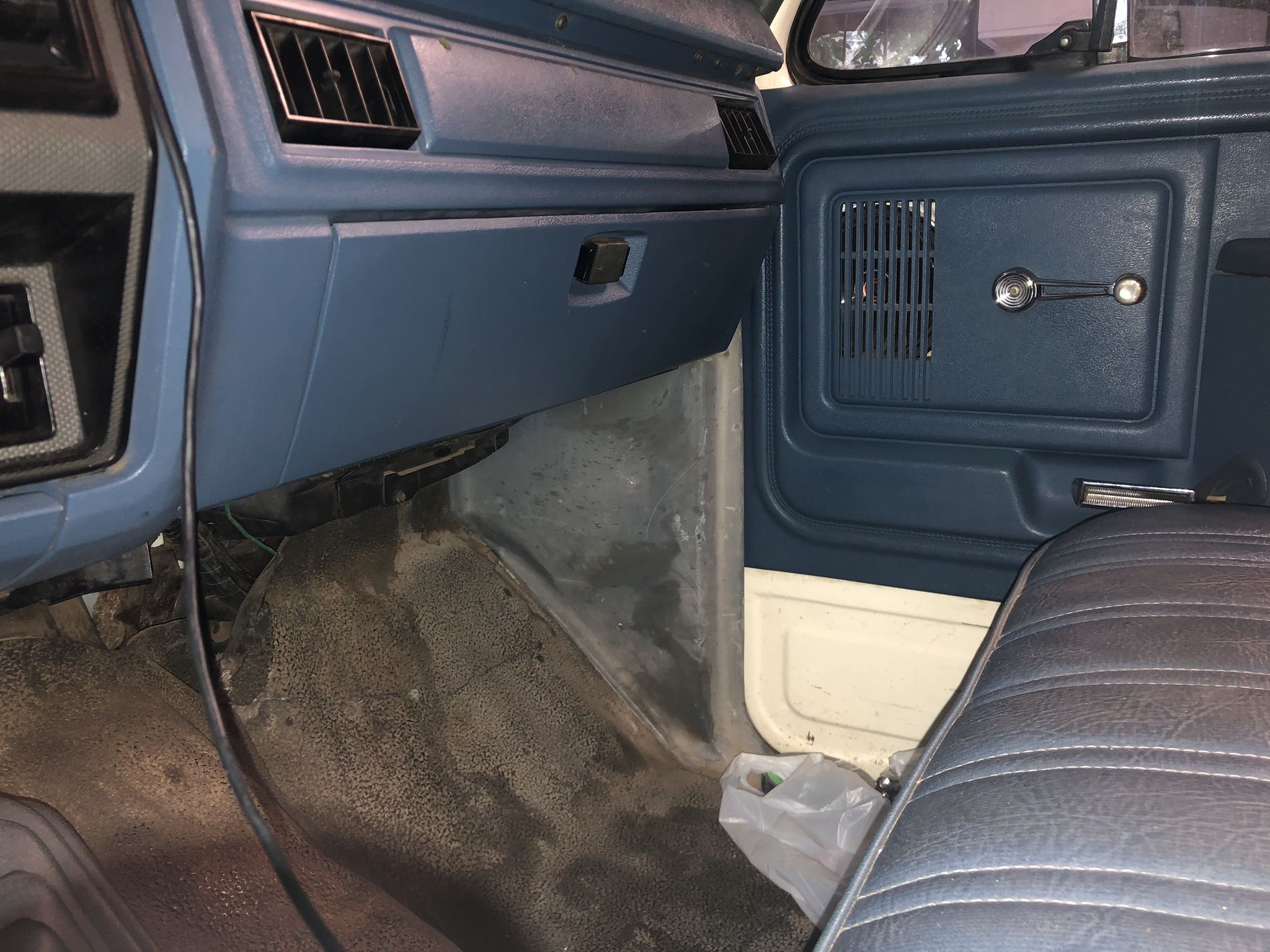

It’s been a while since I’ve updated my thread. I’ve been doing some small projects on the truck as time and money allow. A couple of weeks ago I decided to re-dye the kick panels in the interior. They were gross looking and just were faded and for $40 and a couple hours of my time I figured I could get them looking better. The whole process was pretty easy. I started by cleaning them with a soft sponge and some mineral spirits. I did not sand them at all because they are in good shape for the most part and I was advised against doing so. I would agree that sanding them is not necessary and a good clean with mineral spirits will do. Once they were all cleaned up I did two coats of the adhesion promoter and then 5 coats of the SEM paint. I let them dry for 24 hours and I have to say, they came out really well! Not as blue as the originals, but honestly it’s so close you really can’t tell the difference.

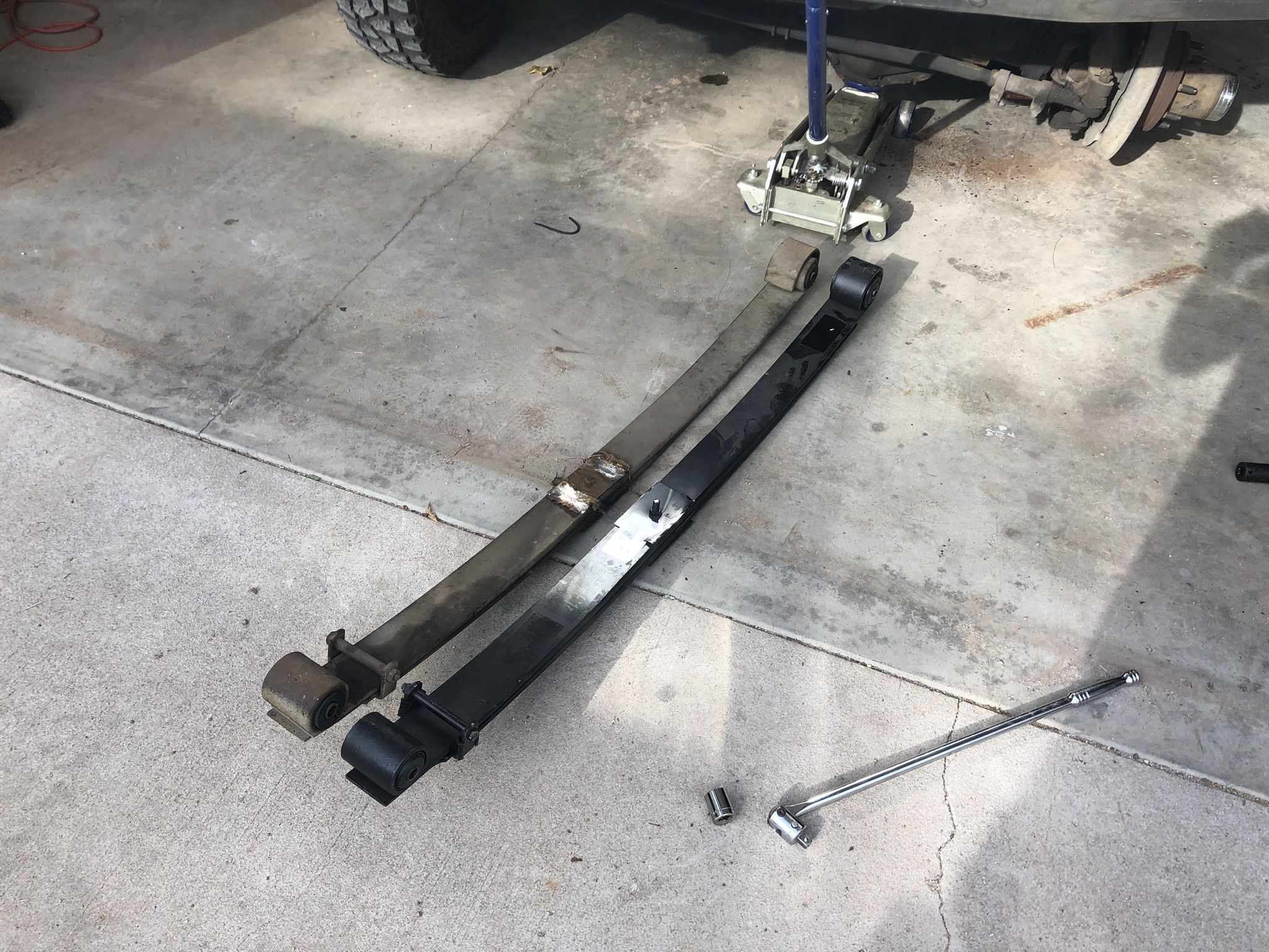

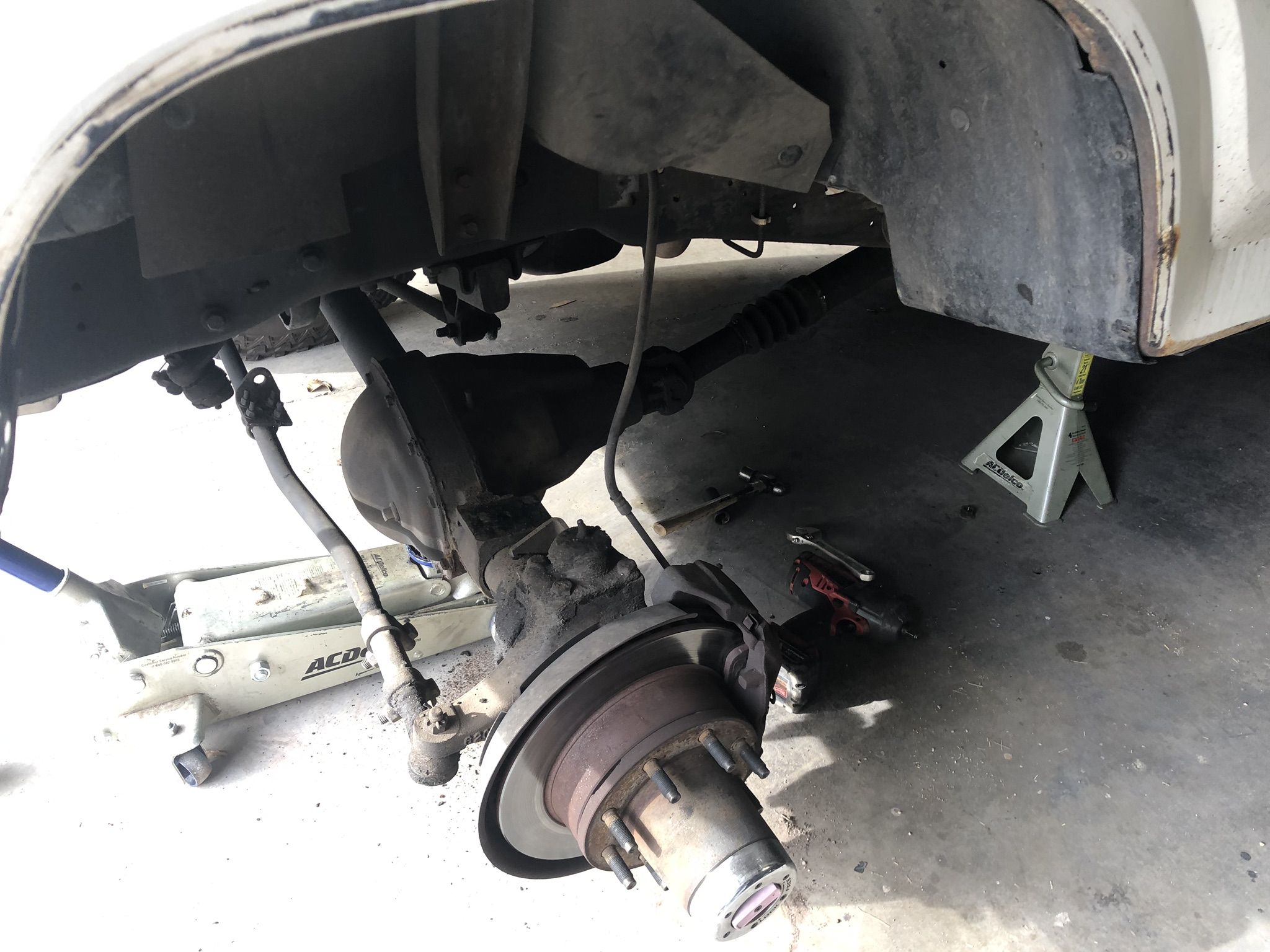

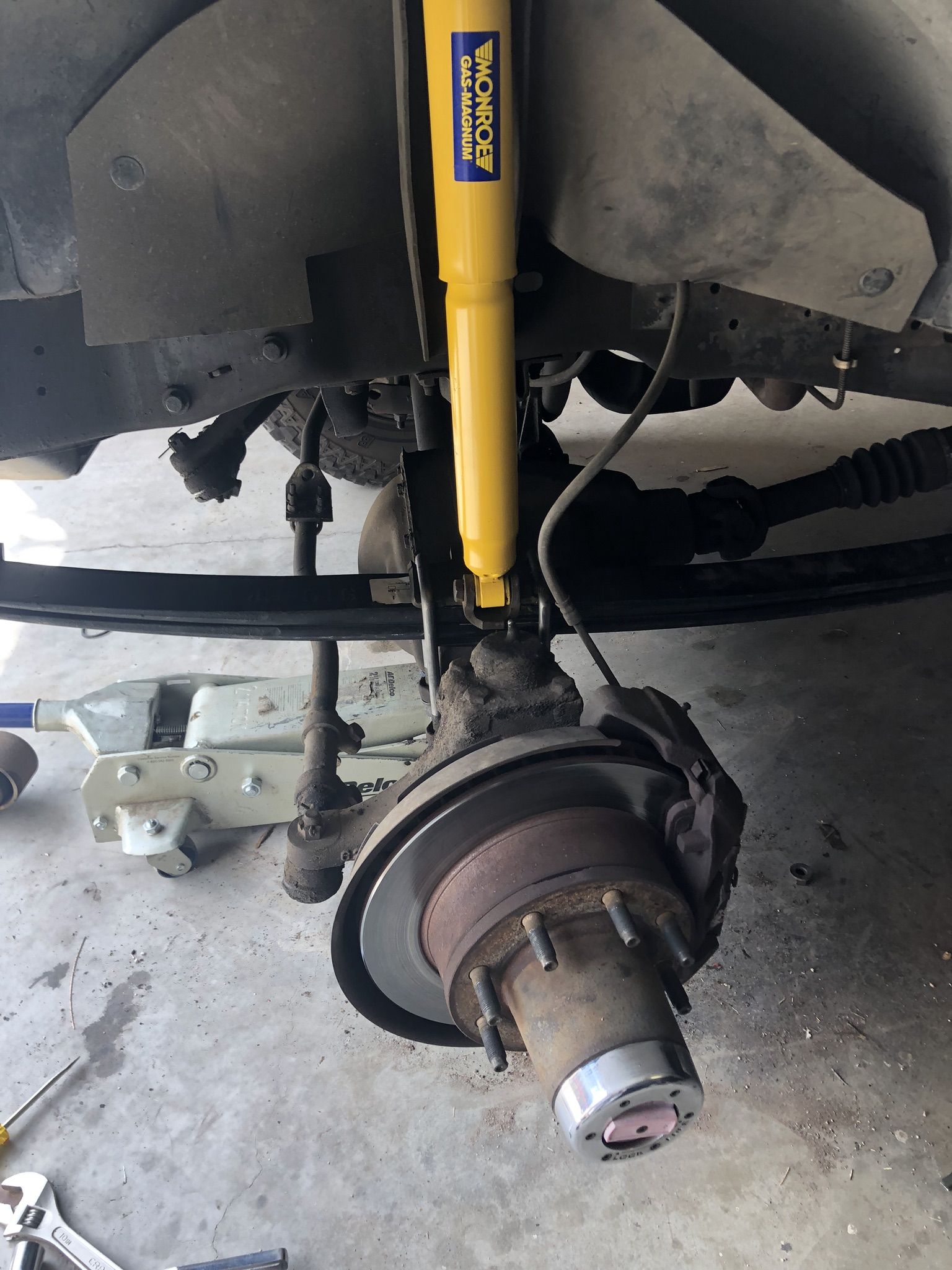

My truck has also been riding really badly for the past couple weeks. I noticed it more on the passenger side and after checking it out I noticed my shock was disconnected at the lower mount! I could see the leaf spring was badly damaged since it wasn’t being dampened by the shock and was literally bending much more than it should. I ordered a new set of leaf springs, shackles and u-bolts from General Spring out of Kansas. I have to say I was pretty impressed with their customer service and shipping. I ordered them on a Tuesday and they arrived on a Friday! All parts looked to be good quality too. My truck had 1900lb front leaf springs on it and considering it has the diesel I just didn’t think those were right.
For the replacement springs I decided to go with the 2200 lb springs considering the diesel is heavier and I like a stiff ride. I replaced the worn out Ranchos with some Monroe Gas-Magnums. All in all it was an easy job and went smoothly. The only real snag I ran into were the leaf spring plates. The center bolts on the new leafs were larger so I had to ream out the holes in the plates. Also the passenger side one (which went bad) was so bent I couldn’t believe it. Whoever installed these springs and shocks did a horrible job and didn’t have the plate aligned properly. Instead of working it to align it, they cranked it down using the bolts and it was definitely not safe. No worries there, a couple good smacks with a 20LB sludge fixed that issue.

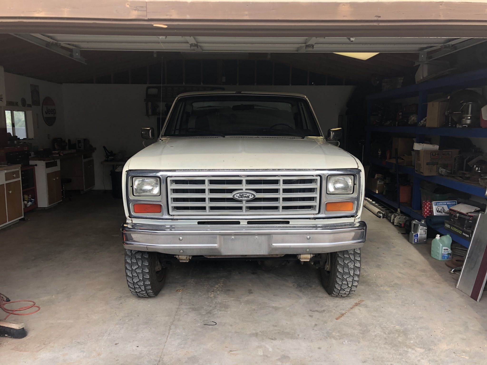

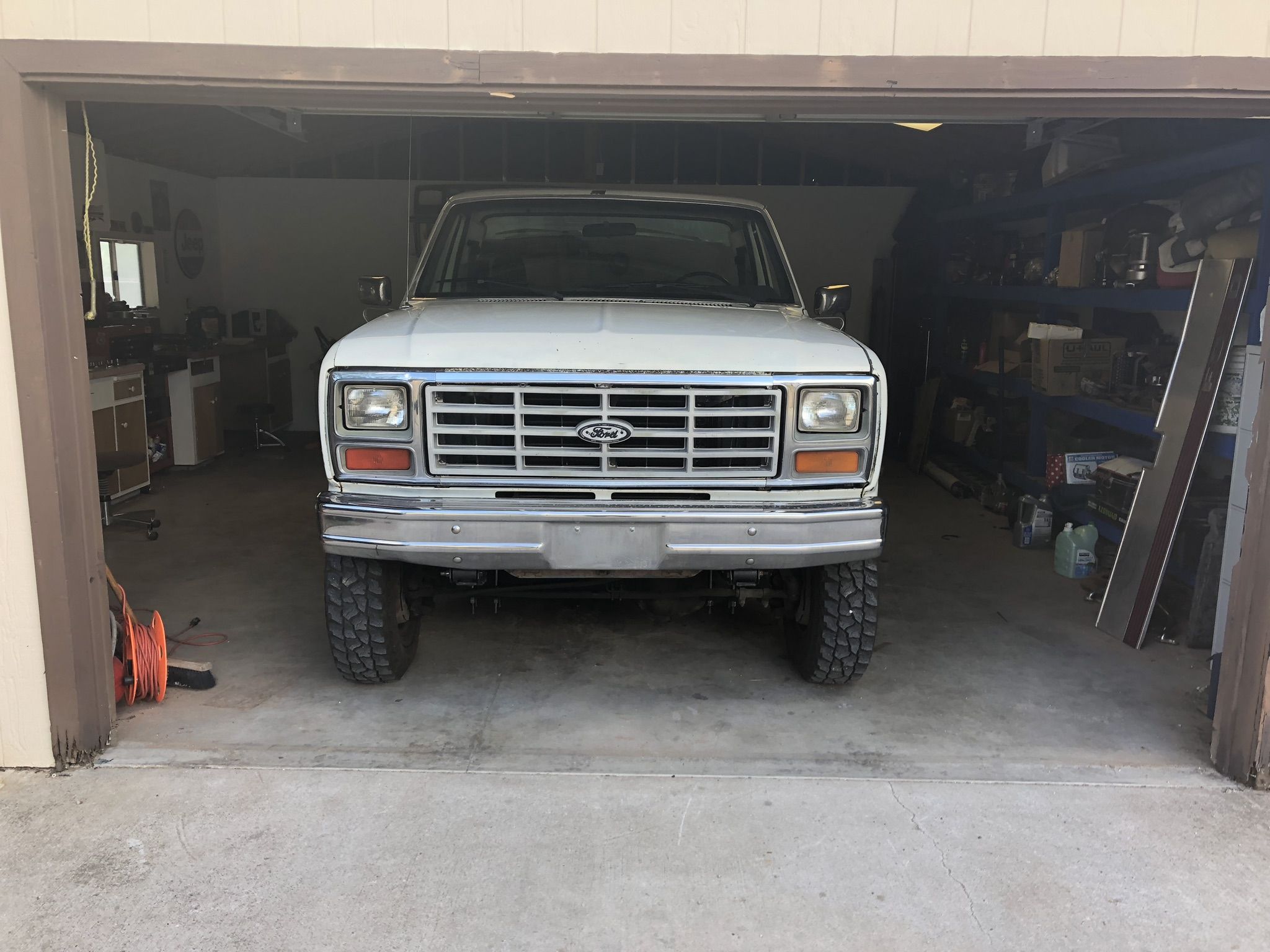

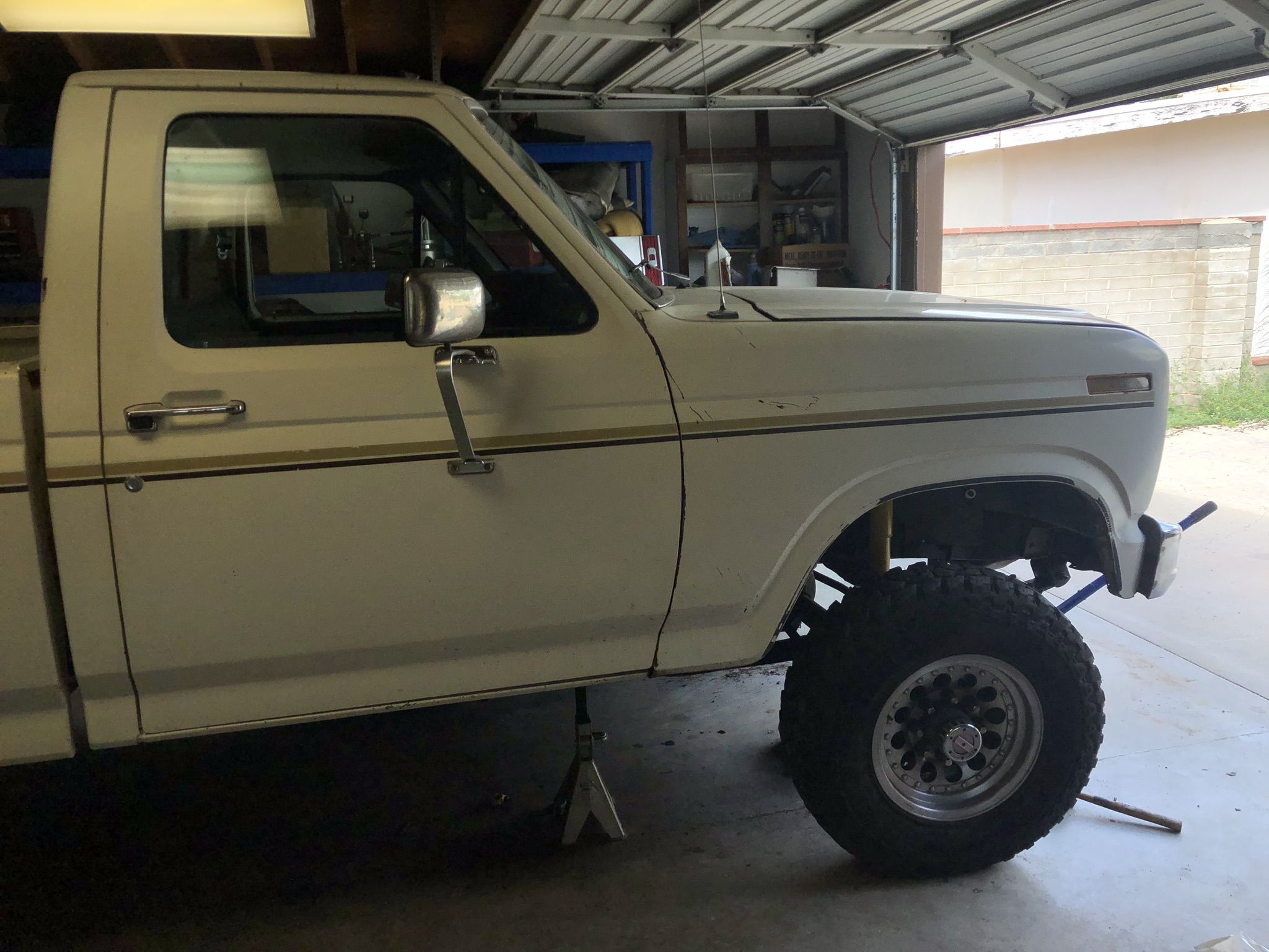

The new springs added some serious height to the truck, and I was a little bit spooked it wasn’t going to clear the door. Luckily, it did so I’m happy about that. Really happy with the new springs, and it rides and handles like a dream. Plus, it just looks better with the height on it too. I’m really happy with the quality of General Spring’s products, and time will tell how well they hold up.

The truck has been fantastic the past couple of weeks. I installed the new Monroe shocks in the rear and put on a new tailpipe. It hasn't had one for as long as I've owned it and it kept bugging me how it would soak my undercarriage in soot.

Been a few years since an update and I'm ready to get back on this thing. My plans are to swap in a ZF5, turbo the 6.9 IDI, redo the interior and put in a slide in pop up camper to make it a comfortable camping rig. Hope to have the build done come spring time so I can start taking it out into the woods!
In the meantime, she got new BFG KO2s all the way around and I finally tracked down an original Warn winch bumper. It will be getting a 8274 in no time as well.
