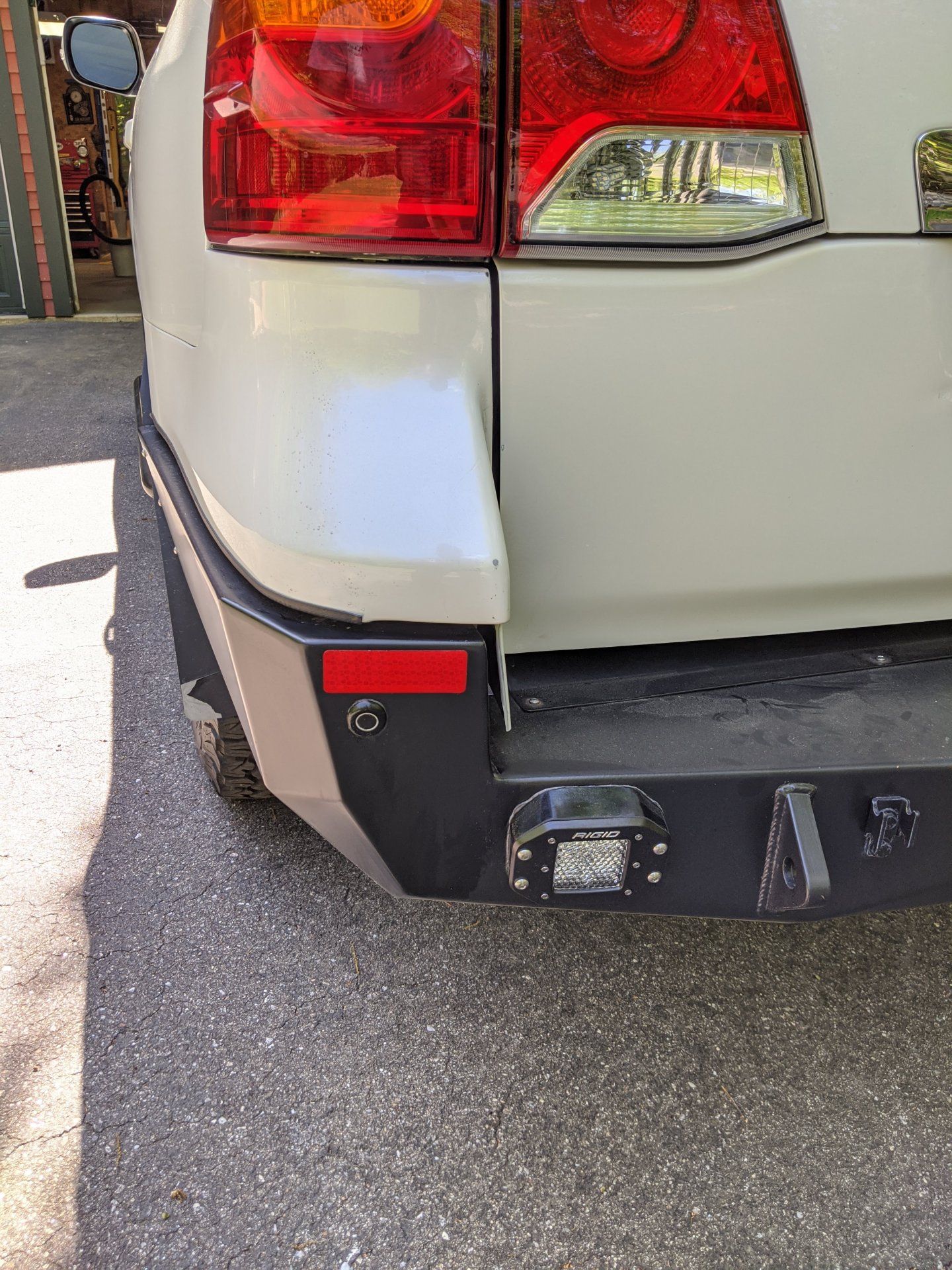

Reverse Lights upgrade in the rear reflector
So...
Add a reflector anywhere you like. :meh:
Reflectors are shallow, passive, and easy.
I know it is, but other people interested in this mod might not have thought of it. Those reflectors help make your car visible to other motorists and are an important safety feature.

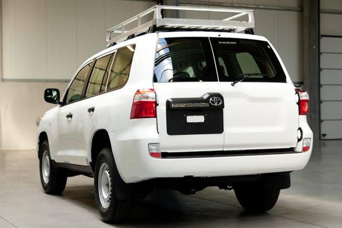

Another option for additional reverse lights with minimal hacking would be to utilize the GX rear lenses

I hear ya.
Reflectors are important when parked on the side of the road at night too. Makes sense.
I was just presenting a solution to the concern.
In my experience, stock reverse lenses can only be brightened so much. I’ve done it with LEDs and meh... No comparison to a full power work-light floods.
I think the loss of the reflector is significant enough that it warrants a solution. I never thought about it, but ya I also don't have the reflectors anymore. No idea if they are DOT or state required, not bothering to look. So, I fixed it really easily. Package of stick-on reflector tape from Lowes, $4 for 4 pieces that are 6" long. Hope it stays stuck on, but it's easy to replace.
Conspicuity is critical for low-light and fog/weather conditions. DOT certified tape (3M) is key to being compliant across all states and even some countries, while UK law dictates red or red/yellow on rear of vehicle, and white on front. We used white conspicuity tape under each headlight in Ghana as this was their requirements in the event, and they did this a lot, of not running headlights at night but you knew you were seeing the front of a vehicle. Having even minimal conspicuity like this is critical.

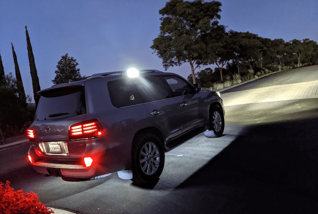

I do like the expo style of the light mod as Eric presented.

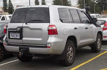

Tossing this out as another option. The original lenses are a fully functional fixture. Just need to add a socket and bulb.
I find them useful as rear fogs that can be used on the road, and when off-road with a bunch of dust kicked up for better visibility. The red can be useful to preserve night visibility when used as a scene lighting in camp.
Tossing this out as another option. The original lenses are a fully functional fixture. Just need to add a socket and bulb element.
I find them useful as actual rear fogs that can be used on the road, and when off-road with a bunch of dust kicked up for better visibility. The red can also be useful to preserve night visibility when camping.
Interesting, you have more pictures or a write up of how you set this up? Is it wired to a switch, reverse lights, brake lights, or taillights?
Sure. Post #10 in this thread. I do recommend the SwithPros even if pairing with aftermarket Rigid light fixtures as you can adjust the brightness.
