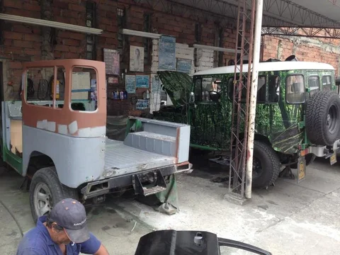

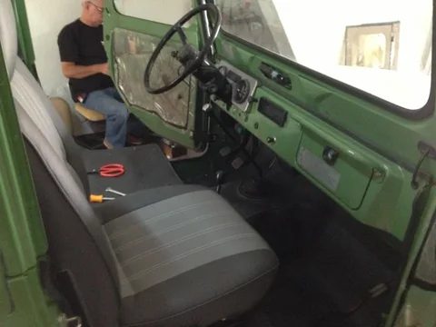

Some photos... remember we are only 3 wks in and will be painting 2 top coats soon by next week. I am already working on the interior with the interior guy today. Big decision I am doing 2 bucket seats with headrests USA spec style but then omitting the roll bar but keeping the twin 2 man benches. So she will be a 6 passenger FJ40. This gives the US buyer the option of changing to a US spec and buying a used rollbar or making a custom roll bar for the twin 2 man seats or just going as a hardtop. I really wanted the twin buckets bec they look better and are more comfortable for a 6 foot 3 guy like me. I may sneak the frames back 1 or 2 inchs too.

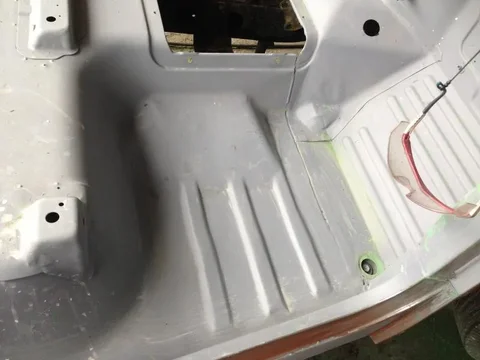

Hey wait! I thought those floors had rust patches. Looks like good work.
Turns out Esmeralda has a twin. Another 1983 FJ40 government model in green ( and yucky vinyl). Actually in good shape. I was so happy bec the 31s look great on stock suspension and it had speakers hidden under the dash to give me an idea how to do mine. The locals love the govt green ones for their reputation of good long term maintenance.

couple photos from today...
MUD member Chamba made mention of the tub bottom corners not matching with the curved doors! Will check thanks!

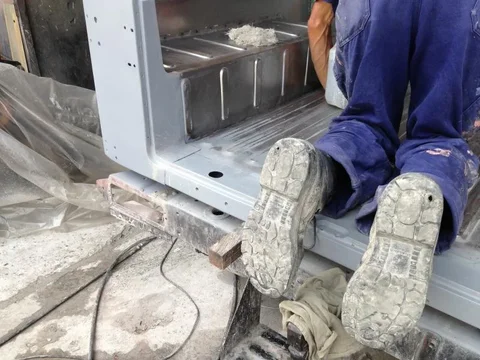

Checked on the work today. This is indeed an earlier series tub that my guy ordered. He then added back a few details to make it an 79 and later tub. I had him add a curve to the bottom of each side and a lip like the old original tub had (we have the original still laying there in his shop). The doors were prefit though and it looks tight.
I do think these changes will make it look more original and thanks to member Chamba for catching it.

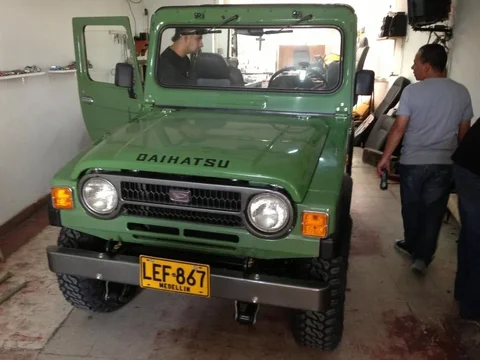

FYI will post photos later but I saw 3 FJ40's today 3 FJ43's and a super nice restored little Daihatsu 4x4. This is the land of classic 4x4s.
Man I really like these little Daihatsus. I even fit it in it! 6 foot 3 and let's just say husky.
My driver says there are geared strongly for the mountains. the come in 4 cyl diesel and gas.
This one all restored and getting new interior. I love that funky military green.
Would make a great beach cruiser in the US.
This guy does incredible interior customizations.
I cant wait until mine is done!

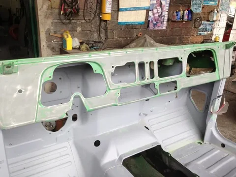

here come some more photos we paint GREEN in a few days.
Fixed the tub detail thanks to member CHAMBA!
Worker scrubbed all the factory yucko paint off the tub so we can put down fresh anti corrosion primer.
We reused the gas filler area off the old tub and a few details. I think this tub had too much extra work. I am sourcing a correct 1979 or later for the next project from another source.
