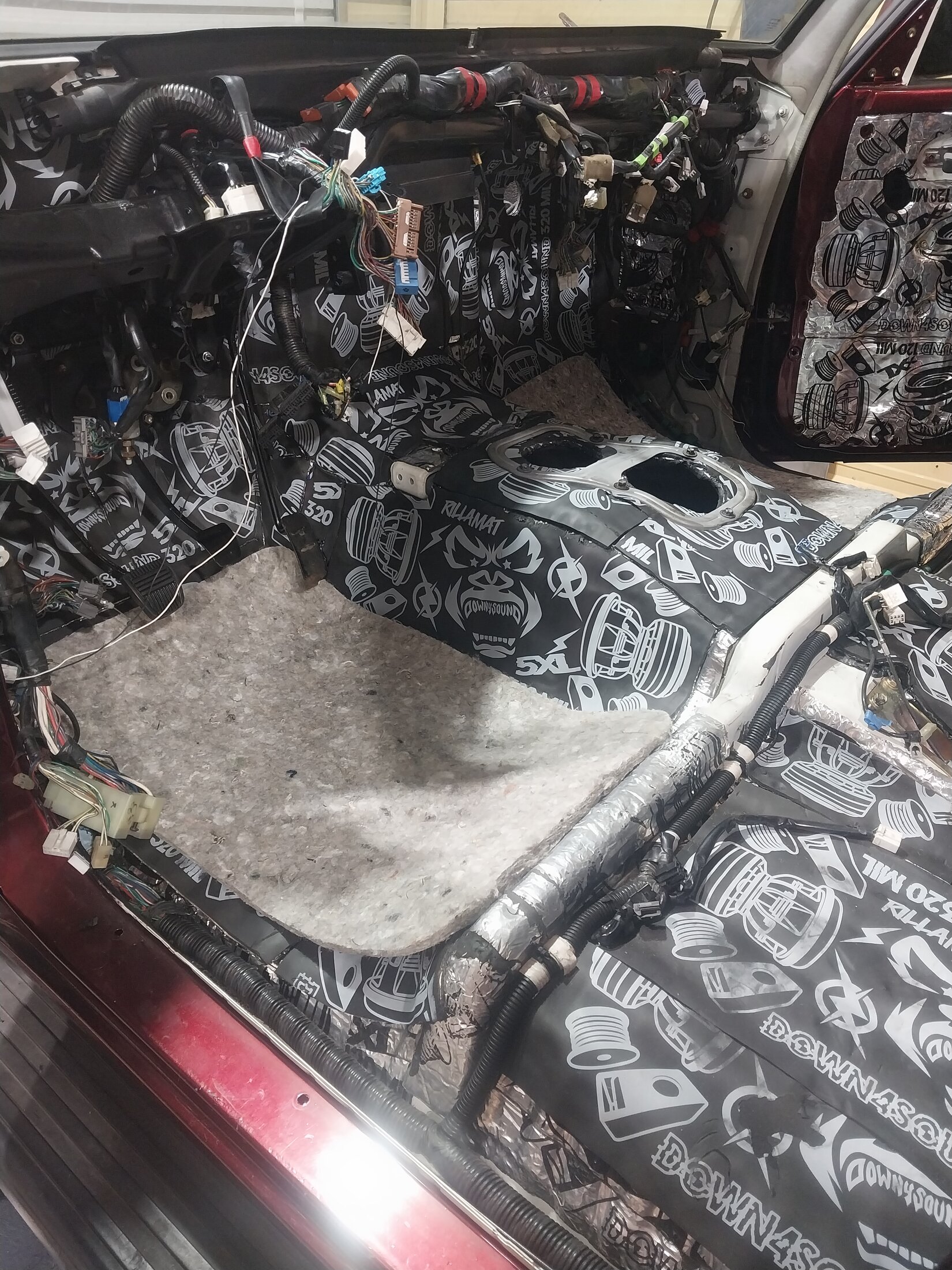

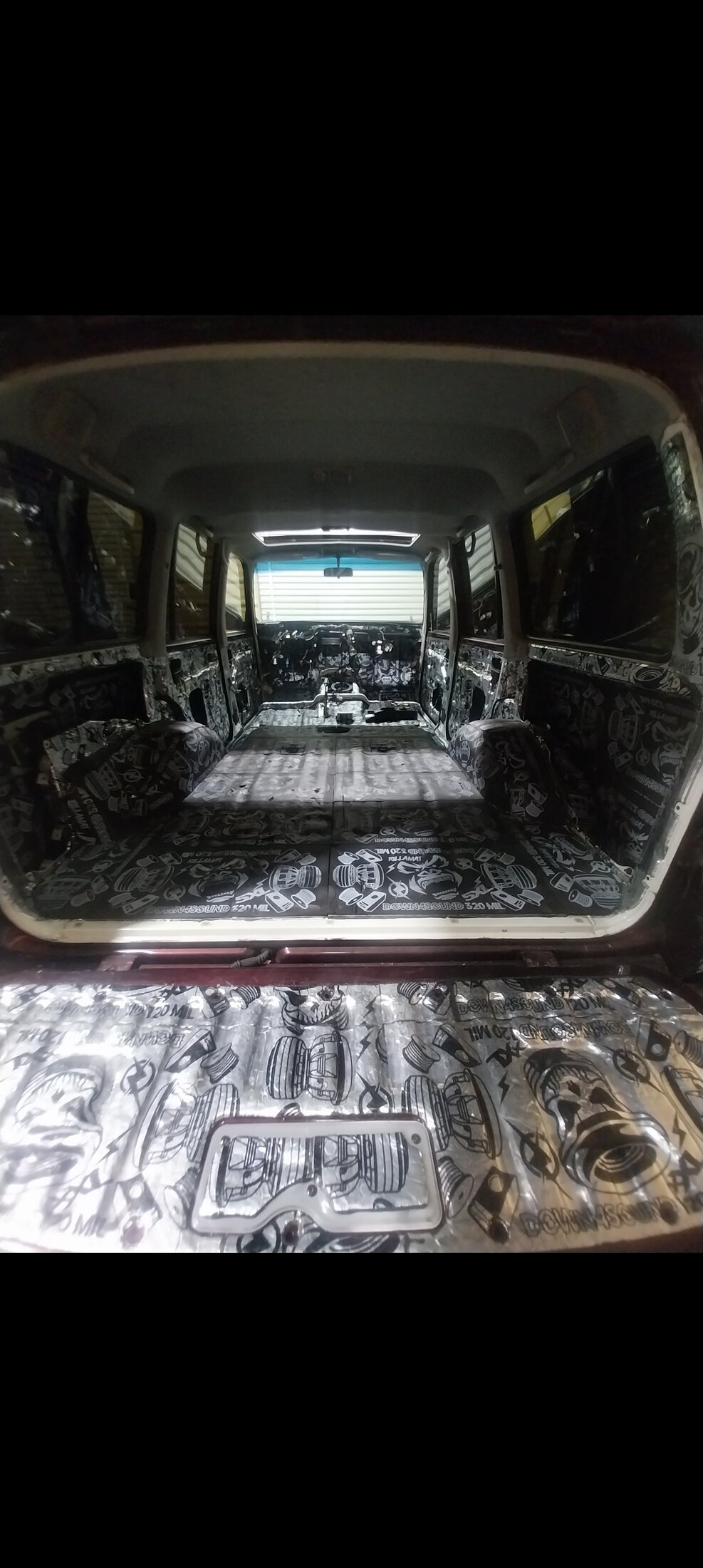

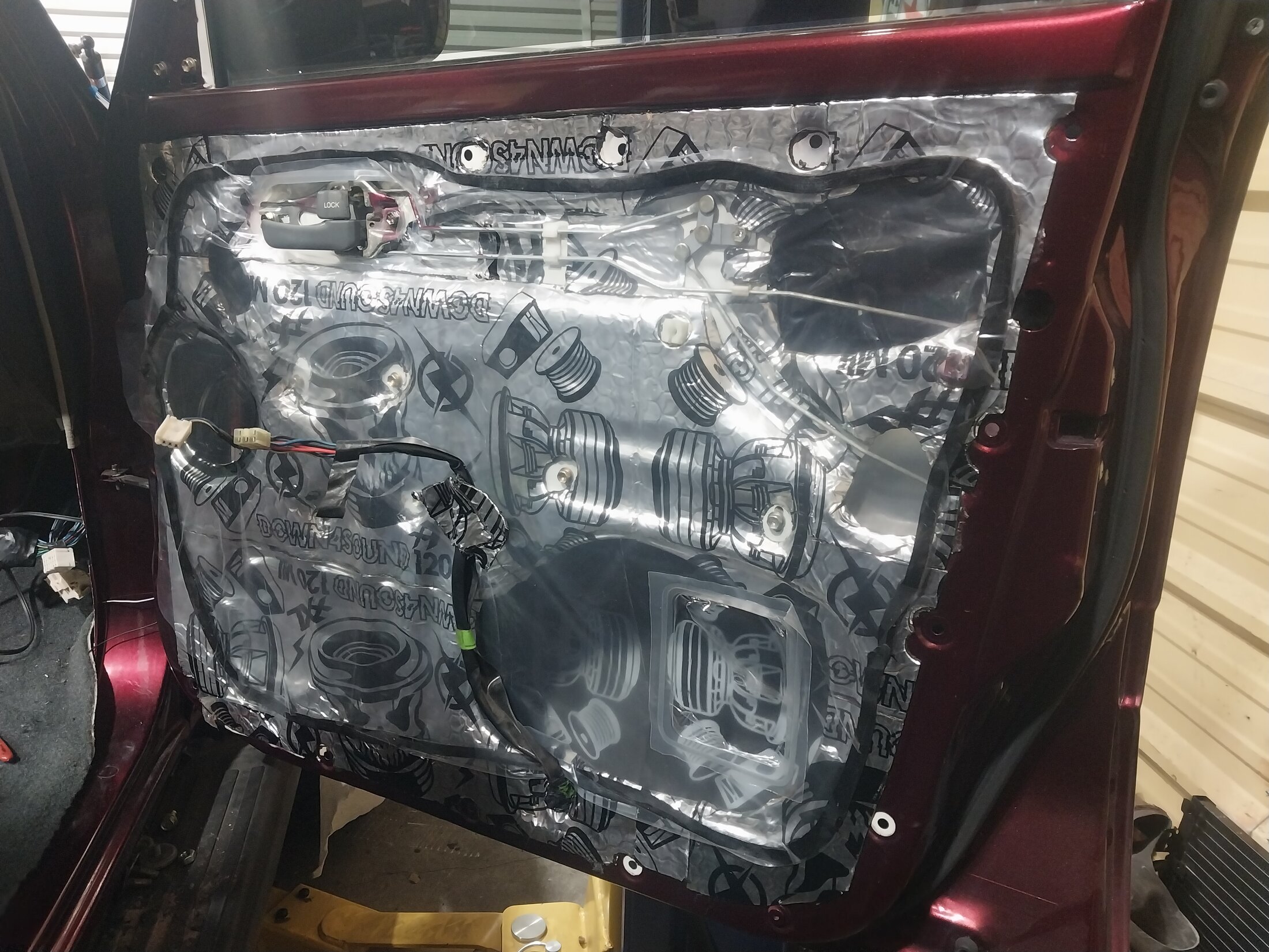

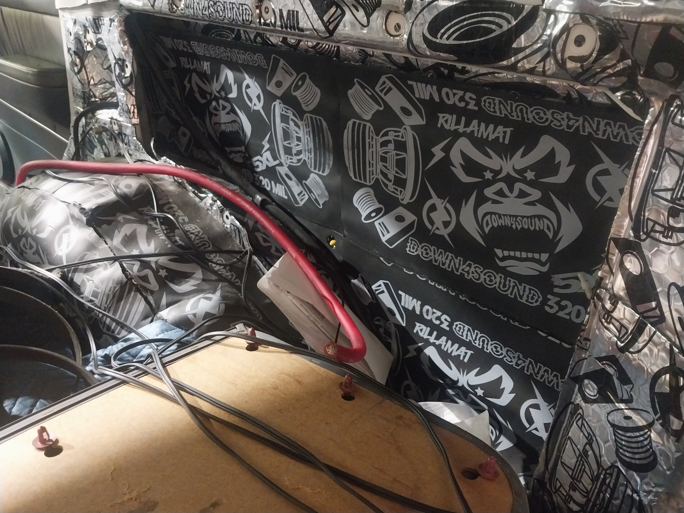

I use Down4soundshop sound deadner. I would say this 80 is about 98% covered in layers of sound deadner.
This looks amazing! I would love to achieve this level of sound treatment. Can you share what you did that isn't visible in the pics? Did you put down CLD, or do anything with underbody and wheel wells? Also, I see some of the material is not reflective like the rest - what types of material are used here?
