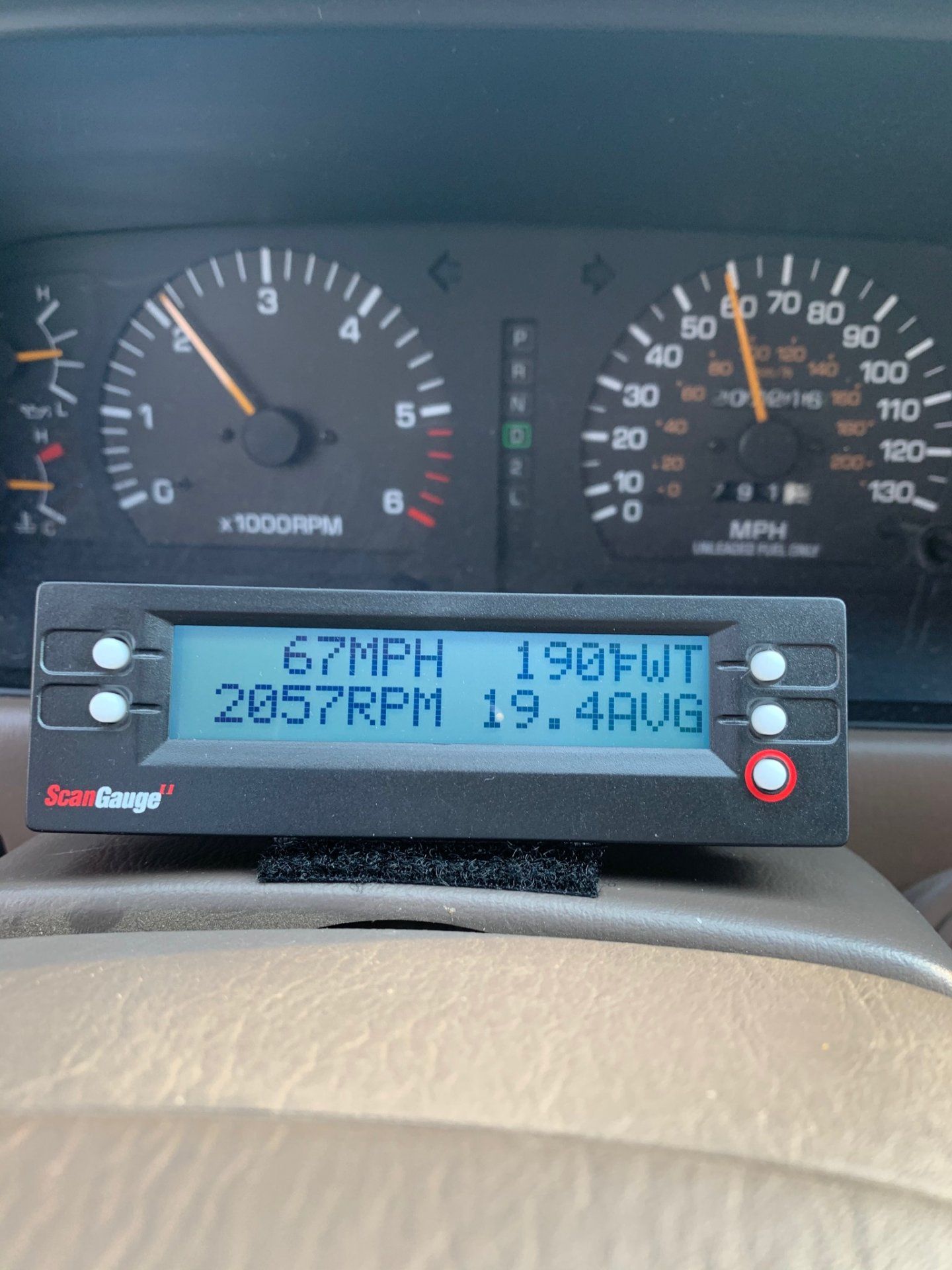

Thanks for everyone’s input, this issue is resolved! I put in an OEM thermostat, OEM water pump, OEM belts, OEM radiator hoses and cap, Landtank modified fan clutch, and a Koyo A1918 radiator. I just took it up the pass on a hot day and it stayed as cool as a cucumber. I’m assuming the issue was the radiator by the looks of it. While climbing I didn’t get over 190 degrees. Thanks again and please let me know if you have any questions. Thanks again.
First pic is the scangauge at the top of the pass.
