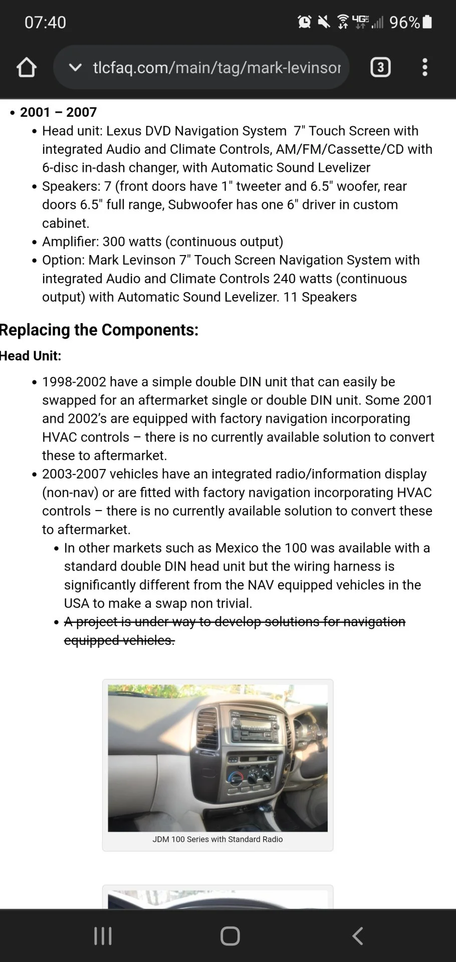

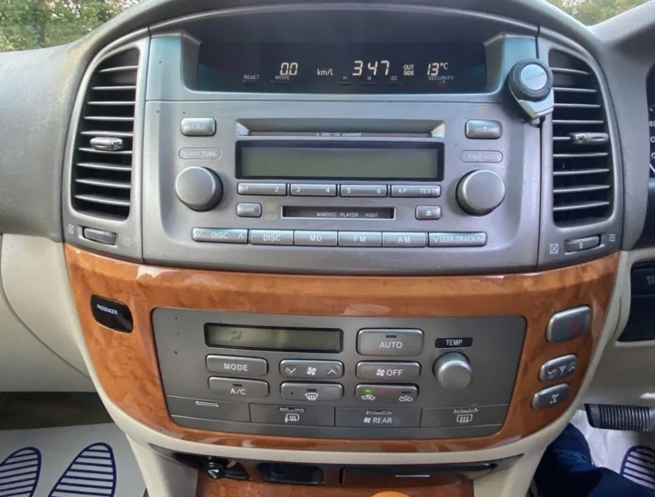

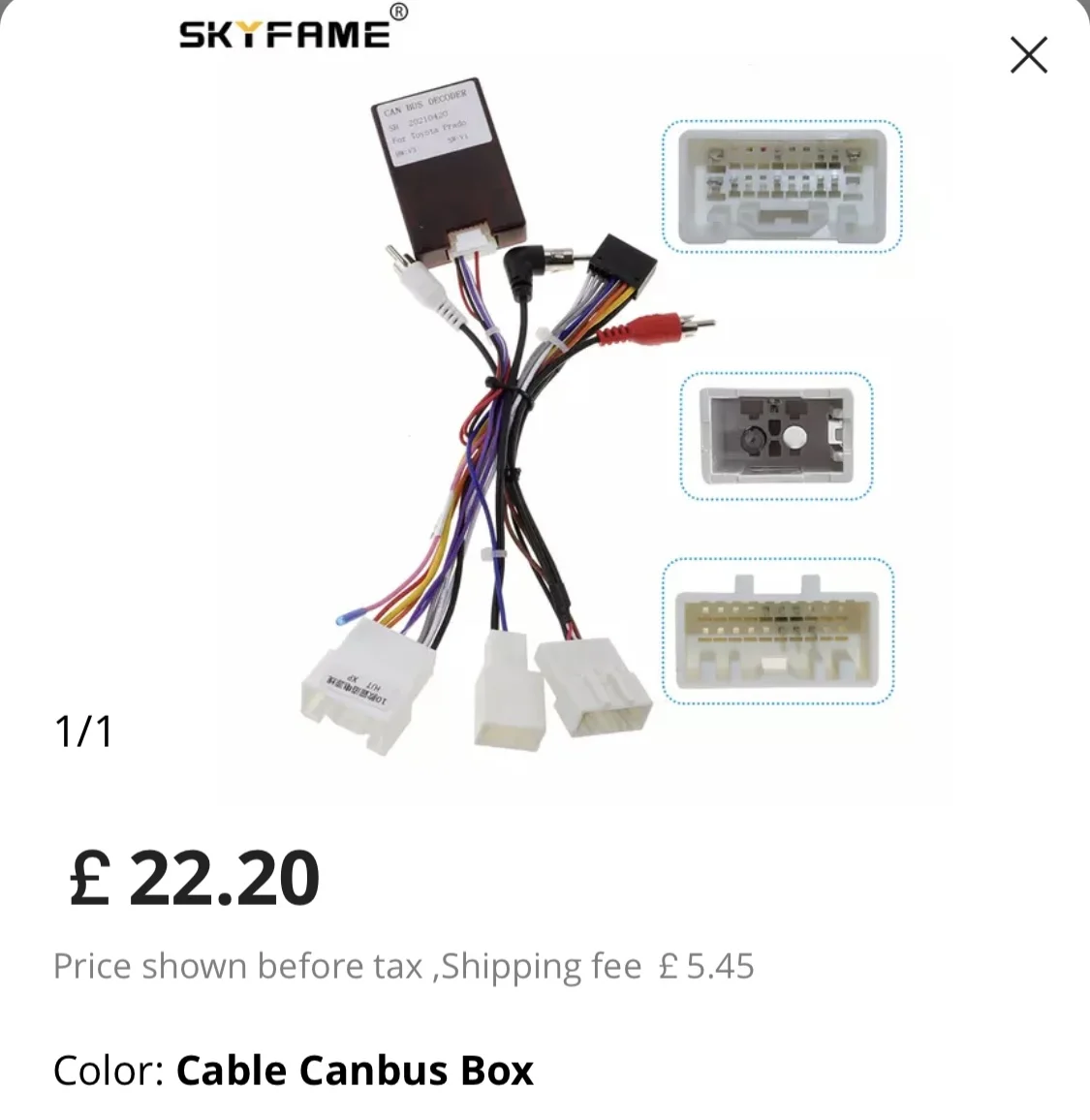

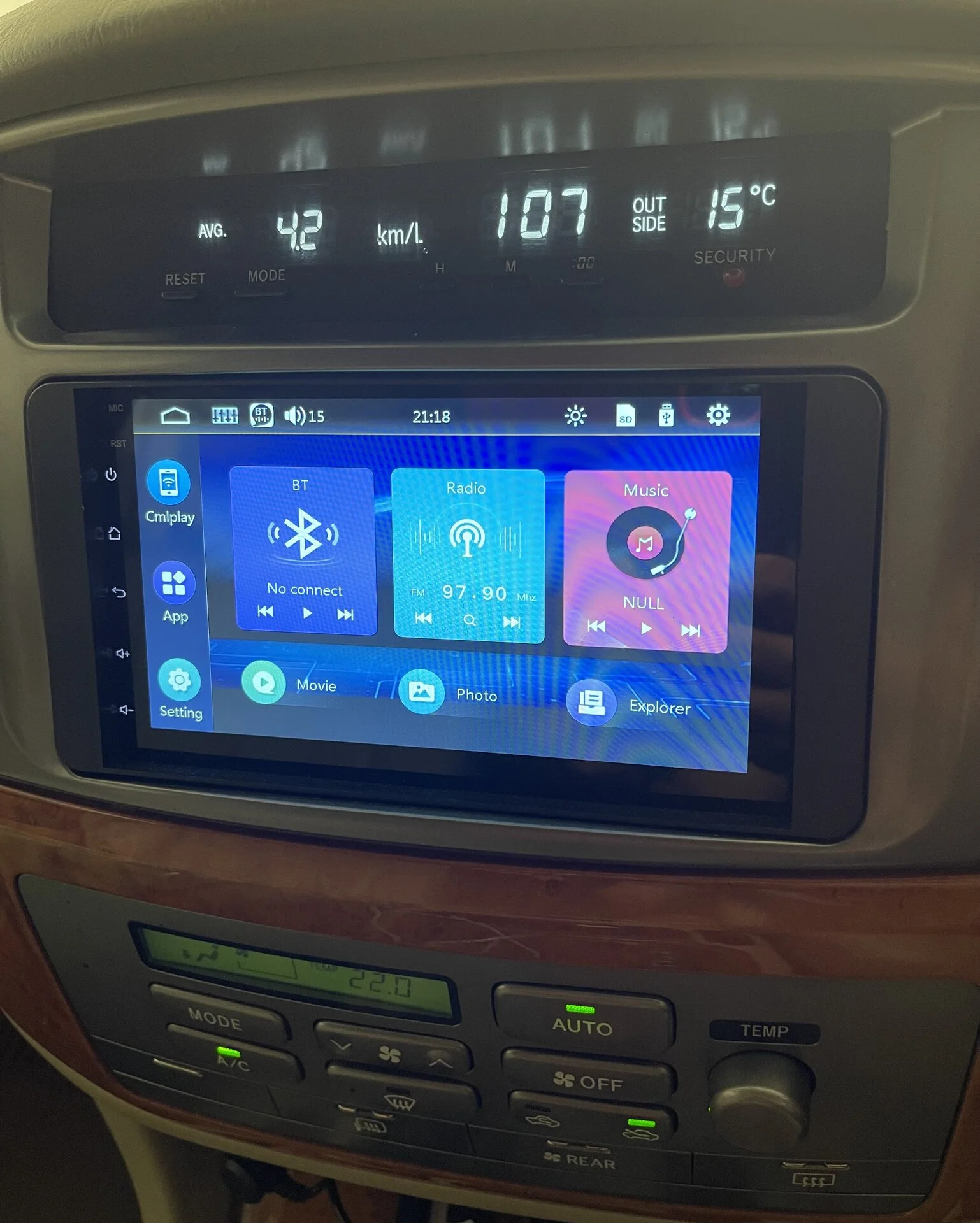

Hi, hope this approach can save you rewiring the AMP. I just added an aftermarket unit to my LC Cygnus 2004, aka UZJ100, LX470, LC Amazon. It had an amplifier under the front seat and a premium audio system. I purchased an aftermarket cable set from Ali Express that is specifically designed to send the signals to the under seat AMP from an aftermarket system. I brought the cheapest Apple CarPlay system I could find off Ebay, along with a plastic audio trim to suit my dash. Only 2 out of 3 three of the connectors on the aftermarket cable set were connected to my car and I needed to splice one cable so the electrical aerial would go up/down with the system being turned on/off... works perfectly and also managed to program some of the steering controls to the stereo as well. See pics. Anyone needing more details, please ping me.
BEFORE
AFTER
CABLES AND STEREO
I have not seen a dash configuration like yours before. I wish I could replace my audio system that easily. I know some folks have been able to convert their HVAC controls over to a manual style system but it looks very different from the dash setup you've got there.
Agree with your comments, I couldn't find anyone that had a system like mine, it had a CD and a Sony Mini Disk system, think it was unique to the Japanese market. The HVAC controls were all separate and didn't need to be touched. I tried all sorts of aftermarket cable sets, all of which didn't work with the AMP under the seat and then finally SKYFRAME on Ali Express saved the day, they were adamant that their aftermarket cables coupled to an aftermarket stereo would work with the AMP ... and to be fair ... they did, just the one tweak as mentioned for the aerial. Anyway, looks like we both have working systems .. happy days!!!!
