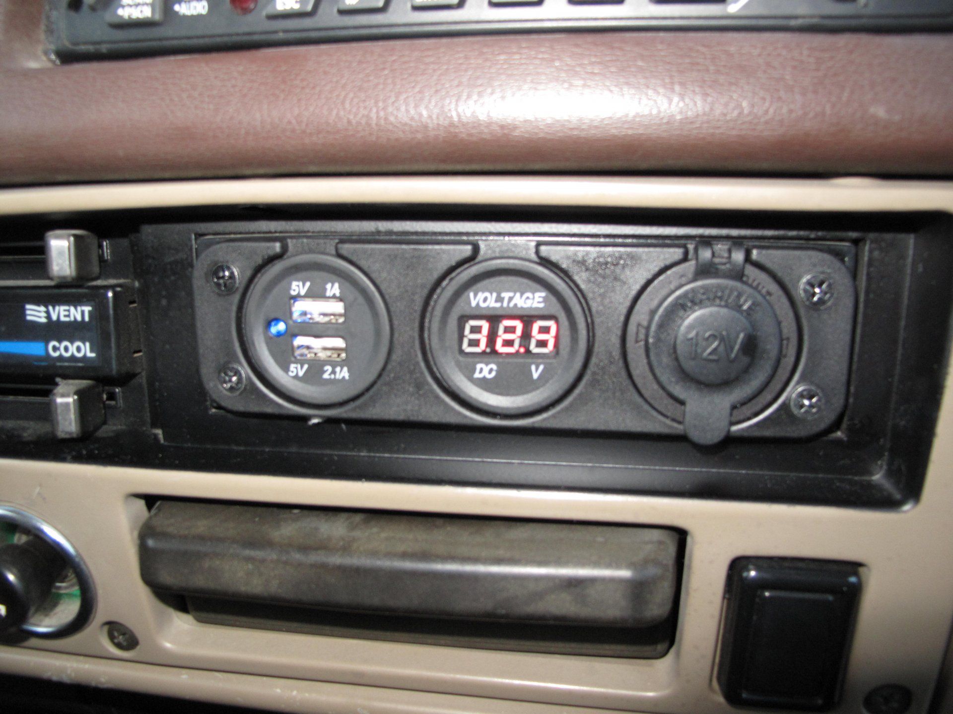

I've found that the location of the stock lighter gets in the way of 3rd gear in a 60, so I made a little panel that fills the ashtray section of the dash. Planning to put a new 12v cig style socket in there as well as a 2-port USB charger and a switch for my (eventual) dual-battery setup.

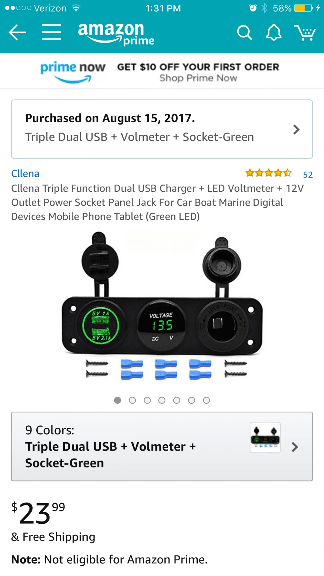

Did you wire it to a switched or constant on? Does the battery voltage read all the time?
I ordered this. I'll wire the chargers to constant and the battery voltage to a switched on source.
Paid a little extra for it to be green and match the rest.
I used the wires which were previously powering the lighter - so switch power (no voltage reading when off). I'm trying to think if you can find a power source back in there (dash) that's not switch power but I'm coming up blank. You might have to run it to a spare in the fuse box, which is simple enough...
I'd likely run it off of the aux fuse box that I put up front by the battery. I prefer to run things separate of the factory fuse box.
For my seats I found a spare plug (think it was Toyota Aftermarket inclinometer plug) that has switched power via lights that I am powering them off of. Could always do that so it has specific run time (only when lights are on), or just do like @peterabbitcook and run off the cig lighter wire..
